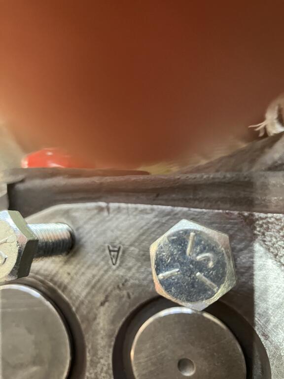

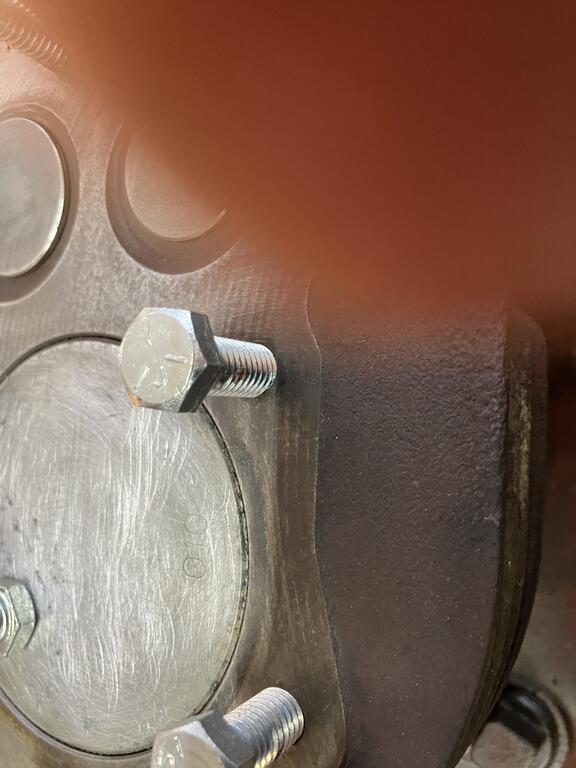

Retired Wrencher 7,043 #2 Posted January 4 It’s always good to remove the head and check for carbon buildup. And sand down the mating surfaces. Like this in this picture. Also sand down the head itself on a nice steel flat table. I try to get it as flat as you can, as you go, you can see where the low spots are and the rest is all high spot. Also, I try to use steel head, gaskets like they originally put on these engines. 2 1 Share this post Link to post Share on other sites
CD Long Jr 203 #3 Posted January 4 57 minutes ago, Retired Wrencher said: It’s always good to remove the head and check for carbon buildup. And sand down the mating surfaces. Like this in this picture. Also sand down the head itself on a nice steel flat table. I try to get it as flat as you can, as you go, you can see where the low spots are and the rest is all high spot. Also, I try to use steel head, gaskets like they originally put on these engines. I worked in Industrial Services. We had 40K psi JetEdge water blasters. We had to lap the valves when they wore down. We used a sheet of glass, various grits of sandpaper, wet with WD40 & sanded using a figure 8 pattern. That's what I intend to do with the head unless directed otherwise. 3 1 Share this post Link to post Share on other sites

lynnmor 9,081 #5 Posted January 4 2 hours ago, CD Long Jr said: I worked in Industrial Services. We had 40K psi JetEdge water blasters. We had to lap the valves when they wore down. We used a sheet of glass, various grits of sandpaper, wet with WD40 & sanded using a figure 8 pattern. That's what I intend to do with the head unless directed otherwise. Just know that glass is not always flat, so check that. The figure 8 pattern is good, just change your grip and rotate the head from time to time. I have a high quality vertical band saw with a ground cast iron table that I use. 2 1 Share this post Link to post Share on other sites
