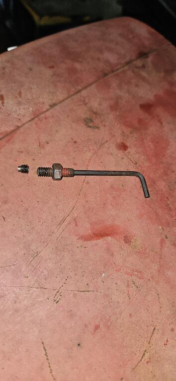

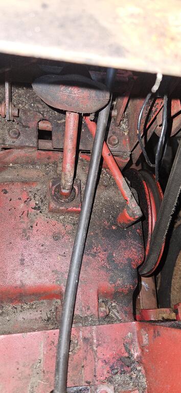

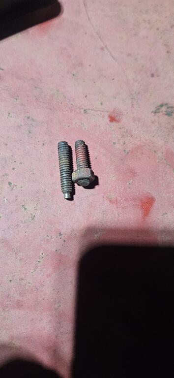

Docwheelhorse 2,992 #1 Posted January 3 Hello all & Happy New Year! Been nibbling away on a 310-8 with plow for my wifes cousin. She saw my C160 and fell in love and wants something similar. She has cancer and im just trying to give her some happiness. Gosh Darn It... I decided to swap out the shifter as it has the non welded ball roll pin version and shifted like you where stirring soup in a pot. I swear... I put a stubby 7/16ths on the lock nut and put .0000001 ugga duggas into it and snap--Have a nice day!! I quit... tomorrow ill argue with it and pray I can get the end piece out without having to pull transaxle. What a P.I T.A that dog point set screw can be!! Who decided forwarded facing in a tight spot was a good idea... Tony 2 3 Share this post Link to post Share on other sites

wallfish 20,618 #6 Posted January 4 3 hours ago, Docwheelhorse said: shifted like you where stirring soup in a pot Since it ain't all shiny on that break, it appears like someone "loosened" it for ya! That's why it popped right out. When an opened end wrench is turned too far on that lock nut it wedges against the case. So it appears like the last person that tightened it down went a little too far and cracked the hardened screw. Lucky you (Pun Intended) found it. 1 Share this post Link to post Share on other sites

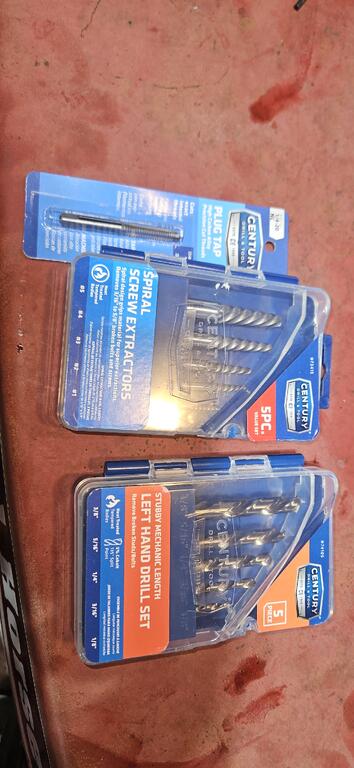

Docwheelhorse 2,992 #8 Posted January 4 $75 in new Japanese made tools (always had cheap junk chinese HF versions) and BAM.... the Dog Point looses! No damage to threads! @Retired Wrencher 2 1 Share this post Link to post Share on other sites
wallfish 20,618 #9 Posted January 4 19 hours ago, Docwheelhorse said: decided to swap out the shifter as it has the non welded ball roll pin version and shifted like you where stirring soup in a pot. @Sparky was supplied with a 110v welder. Next time, wire brush or sandpaper that doughnut and the shaft a little bit down to clean metal right where they meet and zap it with a tack weld. You don't even need to remove the shifter! BAM, slide the boot back down and you're in business shifting like a Le Mans race car driver. 3 Share this post Link to post Share on other sites
