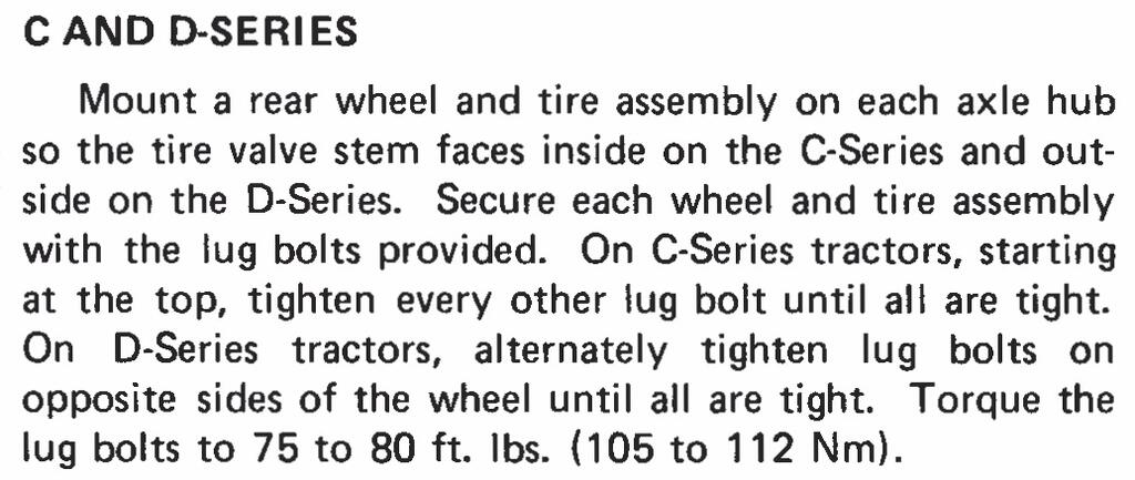

gwest_ca-(File Mod) 12,511 #3 Posted January 3 Back in 1978-79 Wheel Horse published a service manual that applies to many older and newer tractor models. The C-Series became the 300, 400 ad 500-Series so you can see the link. A good resource to have. The only place I have seen the hub bolt torque specs. Section 2 Page 2 2 Share this post Link to post Share on other sites
ebinmaine 81,002 #4 Posted January 3 3 minutes ago, gwest_ca said: Torque value that high would imply a Grade 8 fastener. Seems ambitious but possible. Share this post Link to post Share on other sites
gwest_ca-(File Mod) 12,511 #5 Posted January 3 Are the wheel studs larger for the D-Series? Depending how you read it that torque may apply to the D-Series only. Share this post Link to post Share on other sites
ebinmaine 81,002 #6 Posted January 3 2 minutes ago, gwest_ca said: Are the wheel studs larger for the D-Series? Depending how you read it that torque may apply to the D-Series only. Good point. I've never seen the D Series setup. Share this post Link to post Share on other sites
