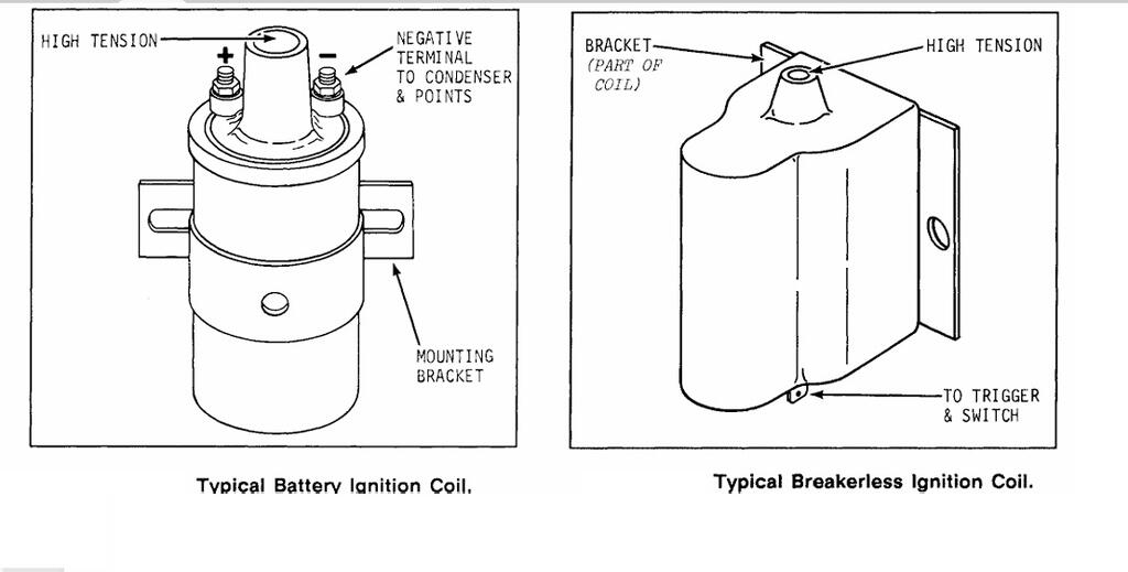

953 nut 68,140 #6 Posted January 3 @Mike.s, some members are asking about the possibility of your ignition system being the original trigger type ignition as apposed to the battery type with a conventional ignition coil. From your first post I think it is a battery system but others are thinking trigger so please look at the pictures below and let us know what ignition system you have. Share this post Link to post Share on other sites
squonk 47,729 #7 Posted January 3 (edited) My 69 GT-14 had the breaker less style ignition. You pretty much need the Kohler manual for that part. The one wire running to the switch is a grounding wire like a Magneto uses. The key turned to off grounds the wire and grounds out the ignition. ( DO NOT APPLY 12 VOLTS TO THE COIL!!) Edited January 3 by squonk Share this post Link to post Share on other sites
Mike.s 2 #8 Posted January 4 Wow, thanks for all the informative replies. That Kohler manual really has al the detail. Awesome. My tractor has the battery ignition. I did find out the points were shot, not closing at all so I am getting some new points in. That will help I am sure! Thanks for all the info! 2 Share this post Link to post Share on other sites
