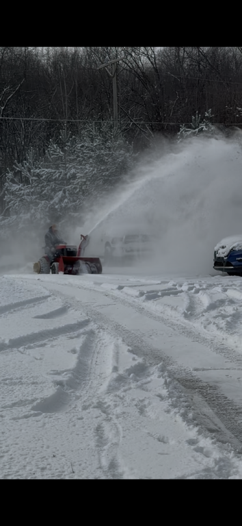

Keith R 31 #1 Posted January 2 I’m absolutely loving the 520hc with the 2 stage! 5 8 Share this post Link to post Share on other sites
Handy Don 17,735 #3 Posted January 2 43 minutes ago, Keith R said: I’m absolutely loving the 520hc with the 2 stage! As long as the chute is pointed downwind! 3 4 Share this post Link to post Share on other sites

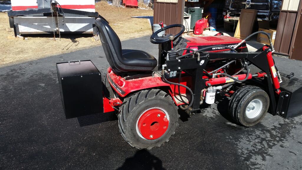

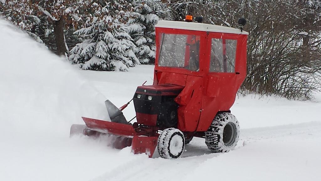

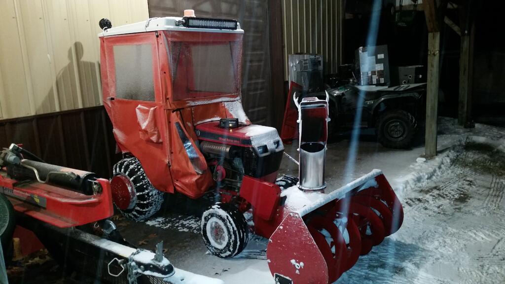

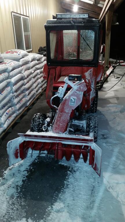

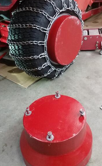

WHX?? 58,388 #4 Posted January 2 (edited) Gotta tell ya Keith my first blower was a short chute single on a 520. Had a blast with it & thought I gotta get me a deuce. Really let her fly with one of those. So I found one for short money that was missing alot of parts but found those with the help of the guys here. DId all the mods... rubber paddle extensions, center support, ball bearings on the auger. Lotta fun stuffing it in a big drift and hearing that Onan get on the governor and the belt squealing. After a couple of years with little to no snow and no use for it. I got a 520 with a tall single and all the goodies. Electric chute, lights, cab wiper...actually did a nicer job than a big heavy deuce. This year lots of snow so out came the the old deuce ... reset up for off road use with double link v bar chains heavy duty skids & just a ton of weight. Let the good times roll ... again! Out to the wood lot and deer pasture. Don't tell The Pullstart but I actually try and get it stuck. Edited January 2 by WHX?? 7 Share this post Link to post Share on other sites
JoeM 10,318 #5 Posted January 2 5 hours ago, WHX?? said: just a ton of weight. Uncle Jim are those cast concrete or steel impregnated weights? Pretty custom tho 1 Share this post Link to post Share on other sites
sqrlgtr 4,225 #6 Posted January 2 @WHX?? inquiring minds would like some info on them weights Share this post Link to post Share on other sites
Keith R 31 #7 Posted January 2 24 minutes ago, sqrlgtr said: @WHX?? inquiring minds would like some info on them weights Second that. Share this post Link to post Share on other sites
ri702bill 13,393 #8 Posted January 2 13 minutes ago, Keith R said: Second that. Make it three... Those are some serious weights - and without a guide stud, look to be a total PITA to install! Share this post Link to post Share on other sites

WHX?? 58,388 #12 Posted January 2 They are solid concrete I think. I have no idea where they came from or what they weight & I ain't got the stones to take one off and weigh it. I think they came on a tractor maybe a 520 that parted out??? Have to go back and look at pics of new to tractors that would joggle my brain. Not to hard to install. Used a floor jack to get them up then just shoved in the rim and used a big chain wrench to turn them to line things up. No markings on them whatsoever. Possibly homemade?? Someone took a belled end of concrete or pvc drain pipe or some other type of mold and poured them full? Only thing I can think of. No idea what he would have used for a release agent??? If I ever gotta put them on another tractor I'll kife the old lady's bathroom scale and weigh them ... if she ain't got the scale needle ripped off ... good thing she doesn't read this ... Should swap them on the FEL but with the sand around here all she'll do is dig in. 1 2 Share this post Link to post Share on other sites
Keith R 31 #13 Posted January 2 3 hours ago, WHX?? said: They are solid concrete I think. I have no idea where they came from or what they weight & I ain't got the stones to take one off and weigh it. I think they came on a tractor maybe a 520 that parted out??? Have to go back and look at pics of new to tractors that would joggle my brain. Not to hard to install. Used a floor jack to get them up then just shoved in the rim and used a big chain wrench to turn them to line things up. No markings on them whatsoever. Possibly homemade?? Someone took a belled end of concrete or pvc drain pipe or some other type of mold and poured them full? Only thing I can think of. No idea what he would have used for a release agent??? If I ever gotta put them on another tractor I'll kife the old lady's bathroom scale and weigh them ... if she ain't got the scale needle ripped off ... good thing she doesn't read this ... Should swap them on the FEL but with the sand around here all she'll do is dig in. I have never operated a loader on anything smaller than a compact John deer. I have been curious about the steering with the loader on a horse. Although my hc steers fine with the 2 stage hanging out front! 1 Share this post Link to post Share on other sites
Handy Don 17,735 #14 Posted January 2 44 minutes ago, Keith R said: I have never operated a loader on anything smaller than a compact John deer. I have been curious about the steering with the loader on a horse. Although my hc steers fine with the 2 stage hanging out front! If it is a later model HC, it’ll have reduction steering (needing two full turns of the wheel lock-to-lock vs. one full turn on standard steering). It makes a huge difference when moving slowly or with heavy front loads. 2 Share this post Link to post Share on other sites
WHX?? 58,388 #15 Posted January 3 5 hours ago, Keith R said: steering with the loader Actually steers good. If I had to do it over again I would put on big firestone tri ribs tho. Ya would have to take out a mortgage but they have a high center so not lot of ground contact on hard surface and would dig in better on loose. V61s do ok ... choice for a snow tractor. Share this post Link to post Share on other sites
