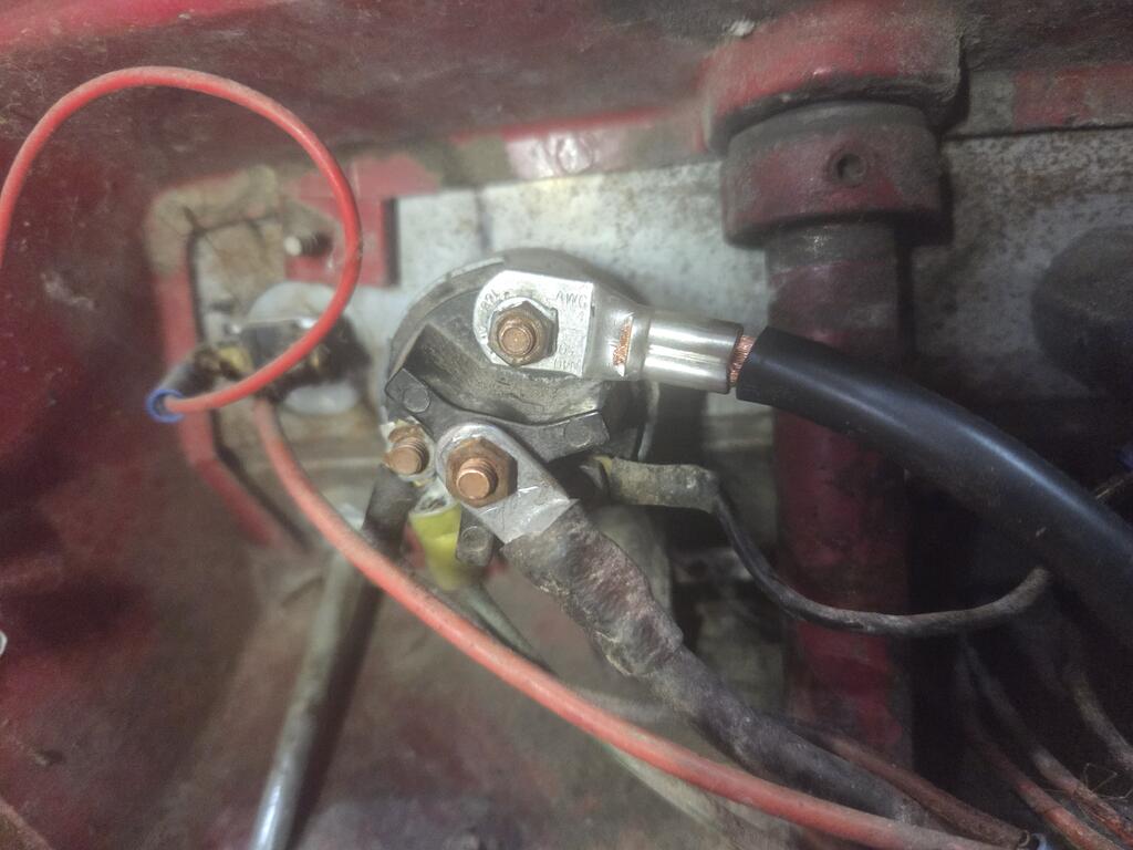

markseven 93 #1 Posted January 1 Where to find a replacement ignition switch like this? Share this post Link to post Share on other sites
WHX?? 56,588 #2 Posted January 1 Very common ... https://www.ebay.com/itm/163848150450?_skw=tractor+ignition+switch&epid=2311173072&itmmeta=01KDWZ0J6YSCN0JMVT3GC2KEB3&hash=item26261c5db2:g:jTMAAOSwOmRdTSYm&itmprp=enc%3AAQAKAAAA0FkggFvd1GGDu0w3yXCmi1eCvXPlPH%2F6YdbmLDEZkGvsi4BU3FrzEzCVNWinuiC99xVRhYNjUta8YHPtCNsbJhD9gr16IwXirKrf9AkvxgBmt2jHW9YDxVf6YigGpvtElxxjx4zDIcCZIHiJNlIA0SNilMCQm6LX9HbYaCQZAufJMjN82aYqhRx6n1SreXSpmwTj0KPbnUddn4lDM5%2F3cJQgSbc9IIl5tyH2zDYG2x7LRn36iffV3r%2Bld9h8wP2iI4AWv4ncYbXWx%2FgCuqr8Rek%3D|tkp%3ABk9SR9ijgp_vZg Looks like yours might be power direct to starter because of the large wires on it. ??? That would make it a high amperage one I don't know if most are like that. 2 1 Share this post Link to post Share on other sites
c-series don 11,907 #3 Posted January 1 I’m guessing there’s no solenoid with that switch? I’ve never seen one like that on a Wheel Horse? Not saying it didn’t come that way though. 1 Share this post Link to post Share on other sites

gwest_ca-(File Mod) 12,233 #9 Posted January 1 Be careful selecting the switch. The Charger 12 used both magneto ignition and battery ignition with both requiring specific switch designs. Post the tractor model number so we can direct you to the correct switch. 1 1 Share this post Link to post Share on other sites
markseven 93 #10 Posted January 1 I converted it to battery ignition years ago . This switch still works great just looking for a backup just in case. Im sure its a factory switch . If its unavailable I will probably go to a remote solenoid. Quality parts are hard to come by. 1 Share this post Link to post Share on other sites
gwest_ca-(File Mod) 12,233 #11 Posted January 2 Early 1968 models had battery ignition and used this switch #7263. This switch carried the heavy starter load. Very expensive at $136 at Parts Tree. Late 1968 models had magneto ignition and used a similar switch but for magneto ignition. In 1972 some models went back to battery ignition and added a solenoid which eliminated the heavy wiring to the 92-6785 switch. Much more efficient going from battery to solenoid to starter. 7263 switch 92-6785 switch with 4 key positions now $94 at Parts Tree A better replacement switch for a solenoid and battery ignition is switch 103990 with 3 key positions now $30 at Parts Tree. Less expensive and available everywhere. Used the above for price comparison. Shop around. 2 Share this post Link to post Share on other sites
