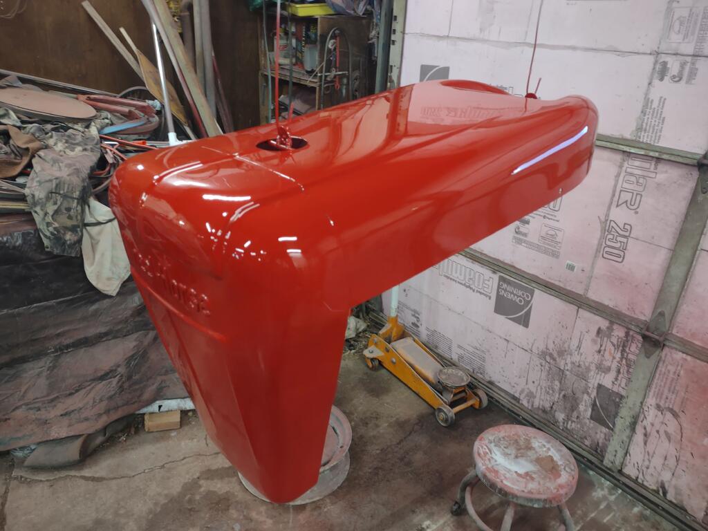

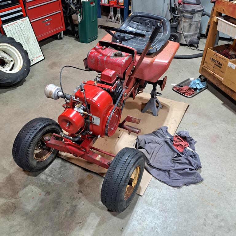

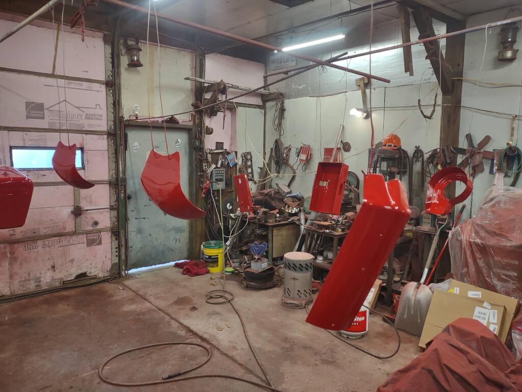

Achto 32,938 #151 Posted February 14 Happy Valentine's Day !! Being as such, it seemed like a good day to spray some red paint. The outside temp in the low 50's also made the shop easy to heat. A big THANK YOU to Jim for helping me wet sand this morning. 3 8 Share this post Link to post Share on other sites

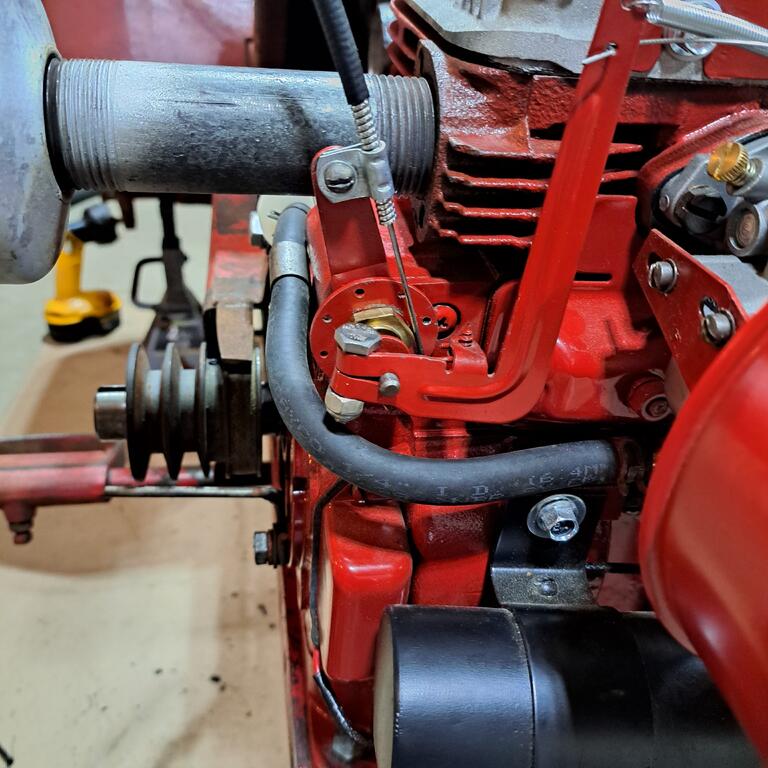

WHX?? 58,347 #152 Posted February 15 1 hour ago, Achto said: THANK YOU to Jim What the hell it's tradition now! I didn't do a damn thing. Looks like them hood hangers worked purty good. Thank you for the P clamps ... ended all my misery. I got nice ... well decent ... throttle range without having to add that little tab. 7 Share this post Link to post Share on other sites

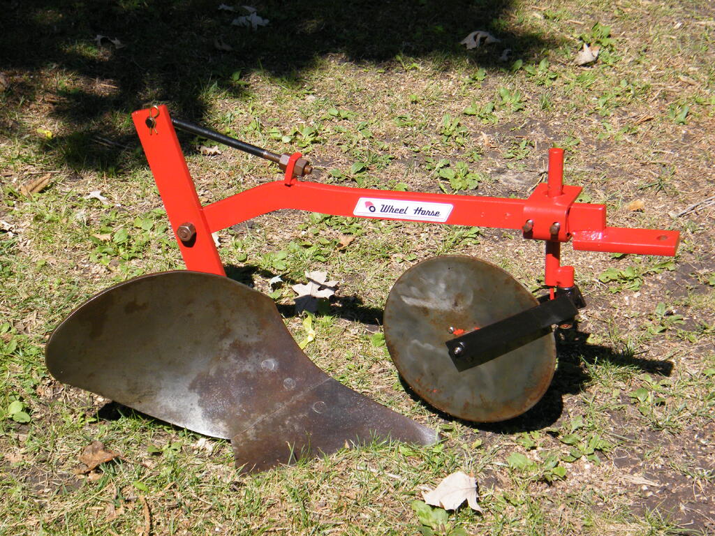

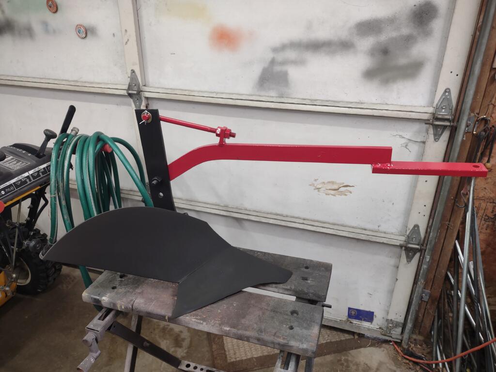

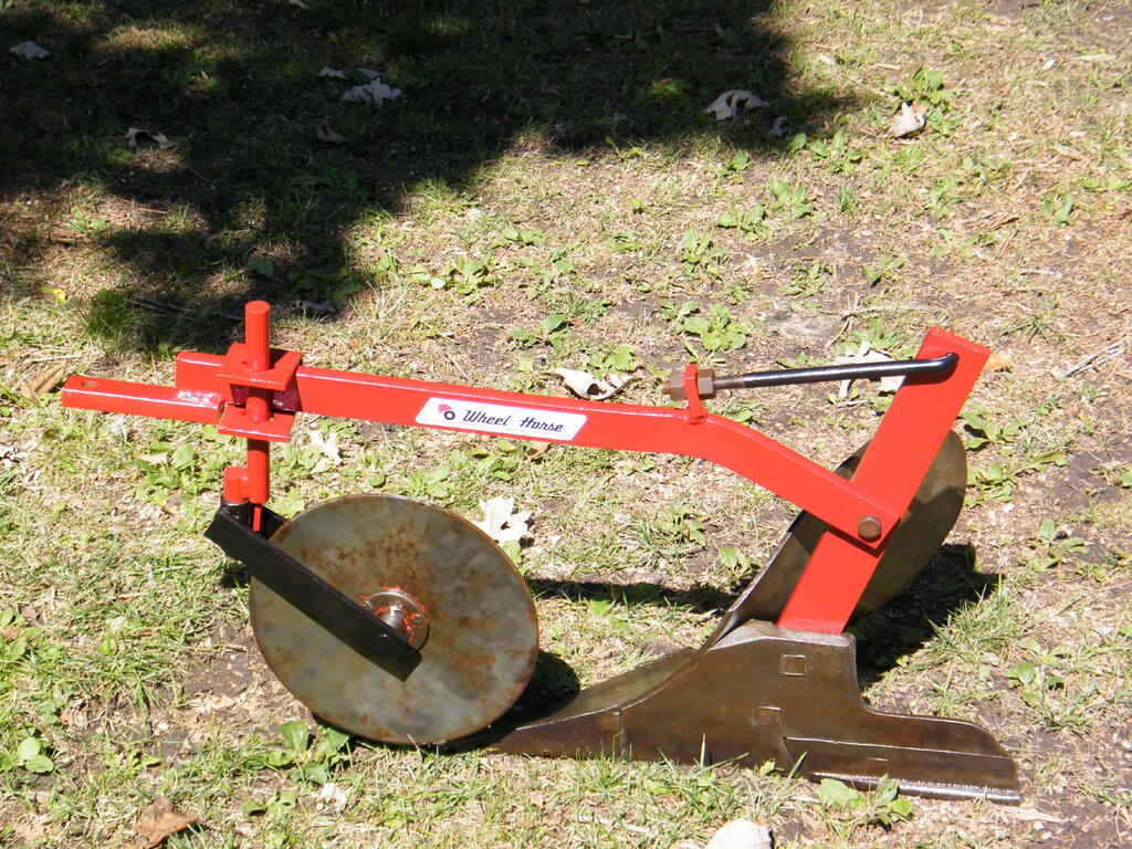

Achto 32,938 #153 Posted February 16 Some assembly today. No, not on the tractor. I put together the plow that I painted a few weeks ago. Normally I spread grease on the shiny portions of my plows for storage. This plow I plan to display with the tractor this year so I really don't want do deal with a plow full of grease when I'm handling and transporting it around. So instead of grease I choose to spray the shiny portions with Till-Guard. This paint is designed to protect the polished surface and to scour off when the plow is put back in use. One up front warning - this stuff really thin and runs very easily. Very thin coats or spray like normal paint and wait for your runs to reach the bottom of the share & let them drip off. Question time - Can anyone tell me if this is actually a plow?. Reason that I ask is because in the pictures that I find the plows have a turn buckle to adjust pitch. This one has an L bolt with 2 nuts on the adjuster. 4 Share this post Link to post Share on other sites
Easton Rich 1,284 #154 Posted February 16 It doesn't look like it. The board is original, but someone built the frame it looks like. I could be wrong Share this post Link to post Share on other sites

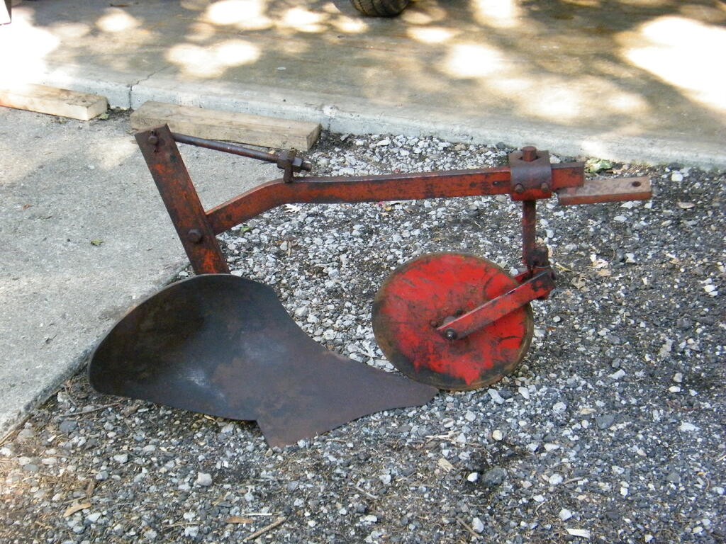

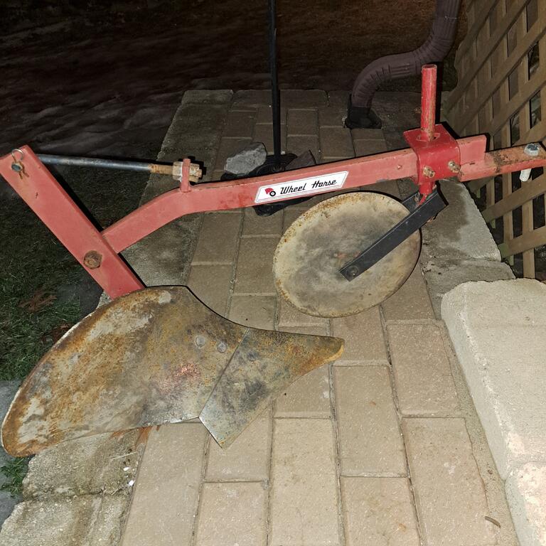

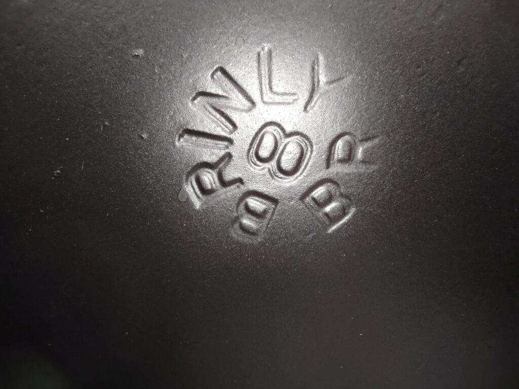

WHX?? 58,347 #155 Posted February 16 (edited) Nice I guess someone isn't gettin that back. Well serves him right he shoulnd't a left it here. Where is that Brinly stamp? I prolly didn'see it for covered in rust. It was yard art here for a year or three. I think I did use it once and always dug the shape of the share. Thoughts on spray clear on it instead? For that display shine? If you want Dan I can clean the coulter up for your display. I really shouldn't be using this one for yard art it's too cool. Only paint I guess. The one I got from @stevasaurus years ago. Maybe he can shed some light on it. And if it had the decal on it before he restored it. Looks to be the same plow except for the sharp instead of rounded corner on the back of the share. Edited February 16 by WHX?? 1 Share this post Link to post Share on other sites
Easton Rich 1,284 #156 Posted February 16 1 minute ago, WHX?? said: Nice I guess someone isn't gettin that back. Well serves him right he shoulnd't a left it here. Where is that Brinly stamp? I prolly didn'see it for covered in rust. It was yard art here for a year or three. I thnk I did use it once and always dug the shape of the share. Thoughts on spray clear on it instead? For that display shine? The one I got from @stevasaurus years ago. Maybe he can shed some light on it. And if it had the decal on it before he restored it. Looks to be the same plow except for the sharp corner on the back of the share. Hmm am I sensing someone is committing some WH thievery? 2 Share this post Link to post Share on other sites
WHX?? 58,347 #157 Posted February 16 (edited) 8 minutes ago, Easton Rich said: Hmm am I sensing someone is committing some WH thievery? Yep I absconded it from my stepson where things go to die. It wouda rusted away to nothin at his place. Now look at it's glory. Edited February 16 by WHX?? 1 Share this post Link to post Share on other sites
Easton Rich 1,284 #158 Posted February 16 Ahhhh good save! 1 1 Share this post Link to post Share on other sites
Achto 32,938 #159 Posted February 16 (edited) 15 hours ago, WHX?? said: Where is that Brinly stamp? There is one on the back of the moldboard, one on the share, and one on the land slide. Edited February 16 by Achto 1 Share this post Link to post Share on other sites
WHX?? 58,347 #160 Posted February 16 (edited) The other thing that might suggest it's a one is the slot hitch? I don't know of any other brands that used one. Maybe Brinly made that just for WH??? On a 401 ... note the tires... run what ya brung ... Edited February 16 by WHX?? 4 Share this post Link to post Share on other sites
Easton Rich 1,284 #161 Posted February 16 Shoooot its getting it done! Dem little k91's are some tough birds 1 1 Share this post Link to post Share on other sites
stevasaurus 23,887 #162 Posted February 16 The plow that Jim got from me did not have any stickers on it. This is before I cleaned it up, I think it is a Wheel Horse plow because it looks like one. I put the stickers on it, because they fit and I had them from Terry. 2 1 Share this post Link to post Share on other sites
Achto 32,938 #163 Posted February 26 On 2/16/2026 at 3:08 PM, stevasaurus said: The plow that Jim got from me Not sure if either are plows. I do see a few differences from Jim's plow to mine. Jim's mold board is bolted to the frog, my mold board is welded to the frog. Jim's land slide is held on with square head plow bolts, mine uses round head plow bolts. 2 1 Share this post Link to post Share on other sites

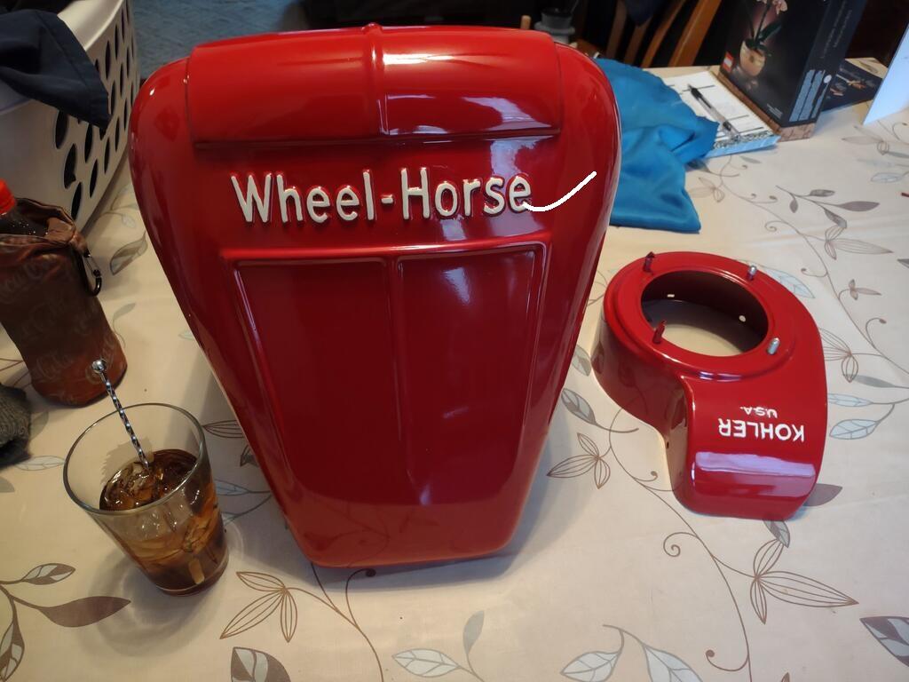

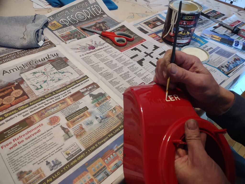

Achto 32,938 #164 Posted February 26 So I seem to have left y'all hangin' here. I found some time tonight to letter the hood & engine fan shroud. I wish that I had more to show but I've been dealing with O.P.S ( Other People's Sh..tuff). Got a Scrub Cadet that I'm painting this weekend and I also have a Simple-city paint job to get off my plate before I will get back to my own project. TTFN. 1 14 1 Share this post Link to post Share on other sites
WHX?? 58,347 #165 Posted February 27 (edited) Is that the mandatory detailing drink !?!?!?!? Works for me Edited February 27 by WHX?? 5 Share this post Link to post Share on other sites
wallfish 20,738 #166 Posted February 27 9 minutes ago, WHX?? said: Is that the mandatory detailing drink !?!?!?!? Works for me If he finished that glass before getting it done. LOL 1 7 Share this post Link to post Share on other sites
Achto 32,938 #167 Posted February 27 Just enough to steady the hands. 2 5 Share this post Link to post Share on other sites
WHX?? 58,347 #168 Posted February 27 1 minute ago, wallfish said: finished that glass He can do a better job sloshed than I can do stone cold sober ... 1 1 7 Share this post Link to post Share on other sites
wallfish 20,738 #169 Posted February 27 29 minutes ago, Achto said: Just enough to steady the hands. Maybe I tend make'm a bit stronger! then LOL 1 4 Share this post Link to post Share on other sites
stevasaurus 23,887 #170 Posted February 27 I think it looks really good, nice brush you have there also. 1 Share this post Link to post Share on other sites

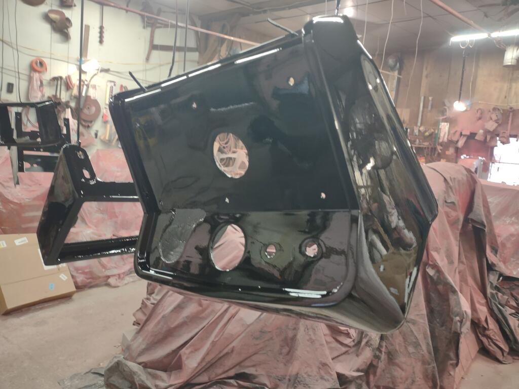

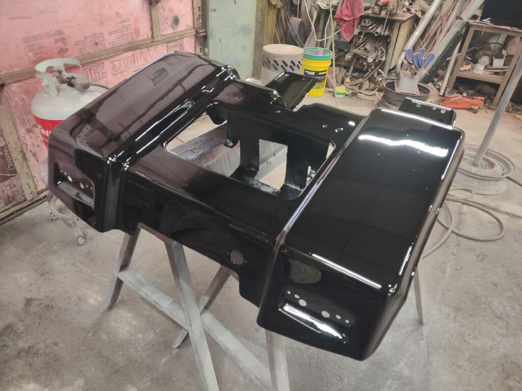

Achto 32,938 #172 Posted March 1 Just to show that I haven't been slackin' off and it's my thread so I'm allowed to go off topic. Got part of the Scrub Cadet side project done. Not traditional colors, this one received a nice base coat clear coat black paint job. I have one more round of parts to spray on this one, as soon has the owner gets them to me. 2 5 Share this post Link to post Share on other sites
WHX?? 58,347 #173 Posted March 1 Looks nice ... Sorry i wasn't there to help out with more sanding but ... well ... you know Dan. So much for date night ... For you guys that don't know this is Dan's way of paying for an expensive set of pulling rears. Personally I think he nuts when there is a 401 in the wings awaiting the fun part. Problem is the guy he is doing this for is one of those "good guys" so it's all all good. 1 1 Share this post Link to post Share on other sites

Eriks Red horse herd 133 #175 Posted March 2 (edited) On 2/15/2026 at 8:00 PM, Achto said: Some assembly today. No, not on the tractor. I put together the plow that I painted a few weeks ago. Normally I spread grease on the shiny portions of my plows for storage. This plow I plan to display with the tractor this year so I really don't want do deal with a plow full of grease when I'm handling and transporting it around. So instead of grease I choose to spray the shiny portions with Till-Guard. This paint is designed to protect the polished surface and to scour off when the plow is put back in use. One up front warning - this stuff really thin and runs very easily. Very thin coats or spray like normal paint and wait for your runs to reach the bottom of the share & let them drip off. Question time - Can anyone tell me if this is actually a plow?. Reason that I ask is because in the pictures that I find the plows have a turn buckle to adjust pitch. This one has an L bolt with 2 nuts on the adjuster. Yes it's a Wheel Horse plow but for a later walk behind tractor 1954-56. They used 8 inch plow made by Brinly . Early 1953 and earlier model's used a 7 inch plow. You can tell it's for a Walk behind tractor because of the long slot hitch tongue even though they didn't have a true slt hitch like the 4 wheel tractors. The Rj 35 on up used a shorter tongue Edited March 2 by Eriks Red horse herd 5 1 Share this post Link to post Share on other sites
