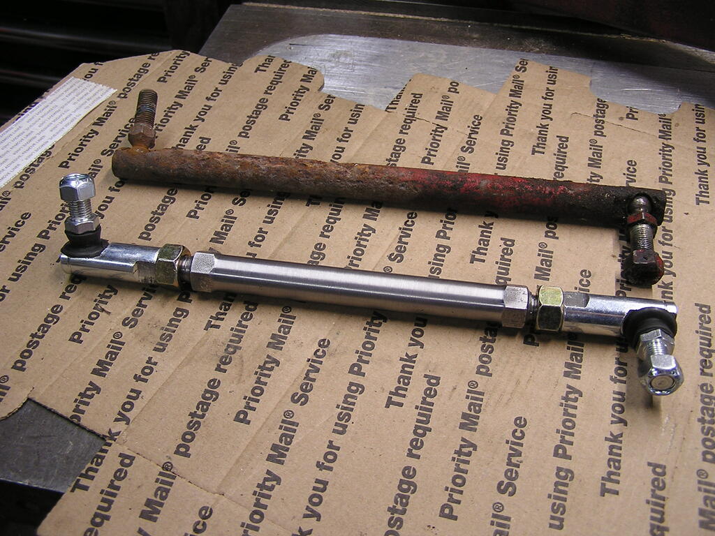

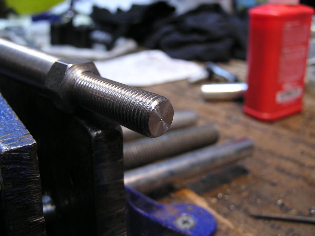

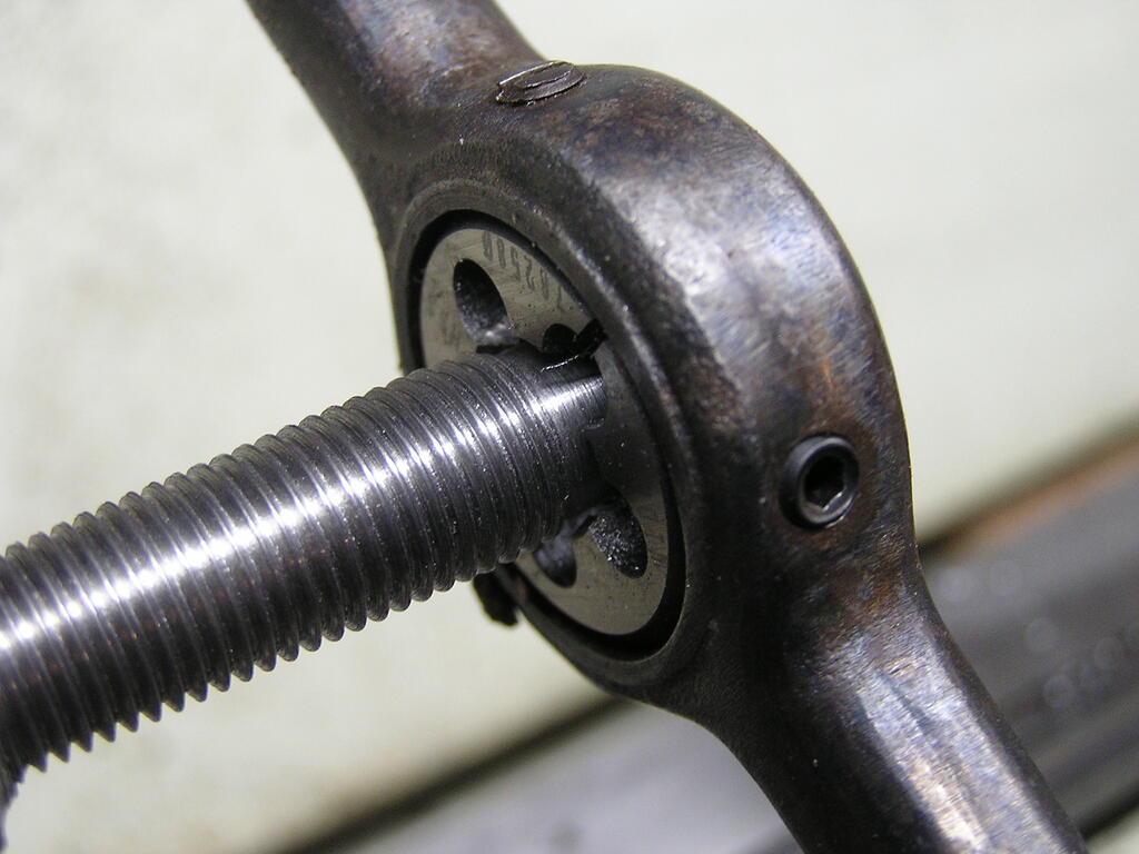

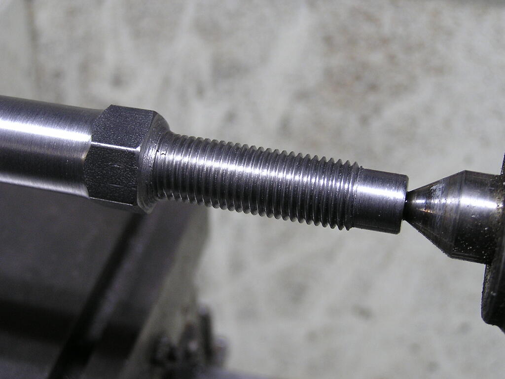

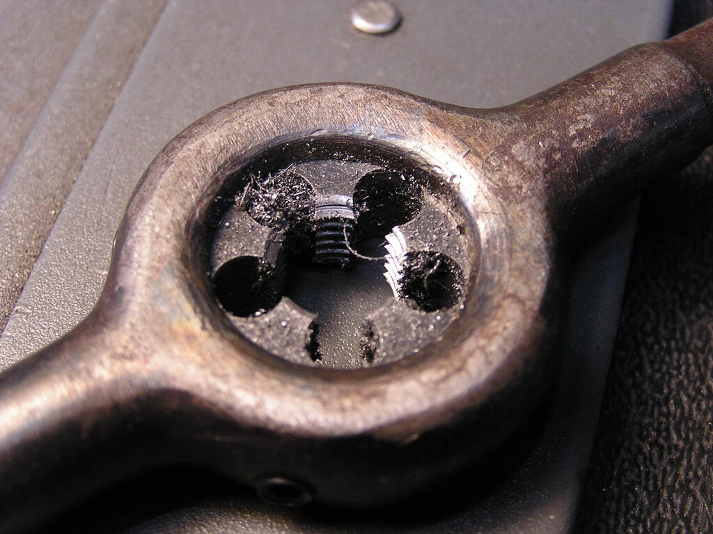

ri702bill 12,389 #1 Posted December 28, 2025 All: Having "moved" both spindle bores when I machined it for bushings, I realized I now needed slightly shorter length Tierods. I have used regular 1080 Cold Rolled material for another set, but the quality of the machined threads was lacking. This set I switched to 12L14 "leaded" hexstock - per the certificate it has .27% lead in the alloy. This allows easier machining with a superior finish. Cost is just a couple of bucks more than 1080. The threads shown are done with an adjustable thread cutting die - 3 passes needed to get the proper shaft to nut fit. Shown is the die from the final pass - the chips look like angel hair Also shown is the old trick of having a starting pilot diameter for the die - it is removed once the threading is done. The 12L14 material is safe to work with, but sanding, grinding and welding are NOT recommended... 15 Share this post Link to post Share on other sites

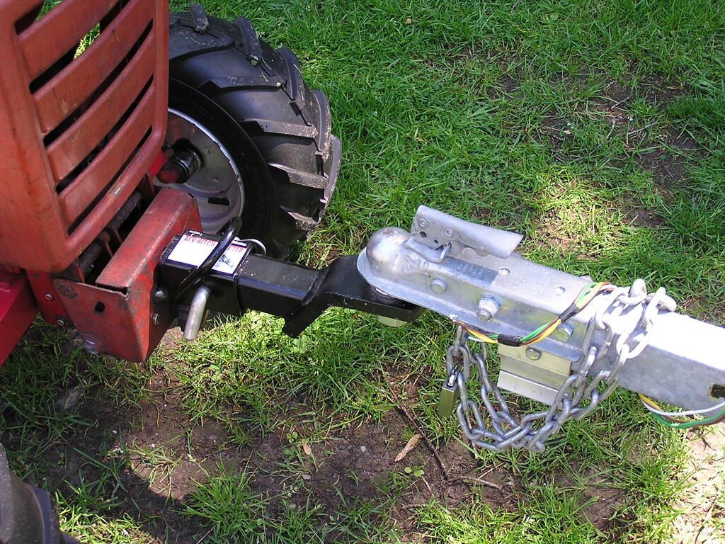

ri702bill 12,389 #10 Posted December 30, 2025 (edited) 23 hours ago, ri702bill said: The old OE tierods do get used elsewhere Used one to make the backside support stops on the front mounted mule drive hitch. Behind the pair of lower hexhead screws. Edited December 30, 2025 by ri702bill 1 Share this post Link to post Share on other sites
