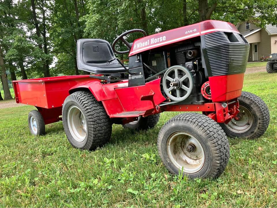

Wishin4a416
This one has been on FB marketplace for awhile.
  • Haha 1

ebinmaine
16 minutes ago, Wishin4a416 said:
This one has been ....
21 minutes ago, Wheelhorse3128 said:
build
 Notice that the belt isn't supported.
Do NOT set up this way.
  • Like 1
  • Thanks 1
