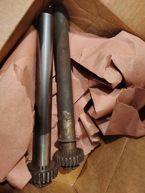

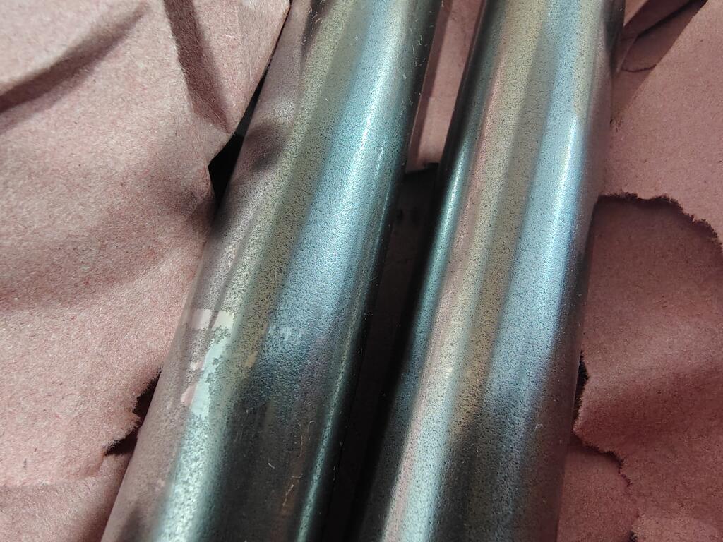

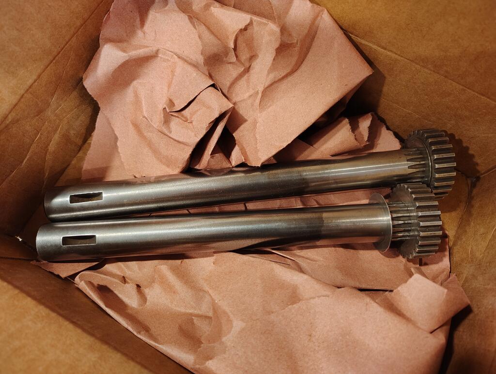

AlexR 3,139 #9 Posted January 3 Pulled the trigger on some axles they have like new keyways and snap ring grooves. But unfortunately they had surface rust which for most of it doesn't matter but the bearing and seal areas are what I'm concerned about. This first photo is of one I cleaned up about halfway compared to the way I got it on the other axle. All the way cleaned up sanded and sanded with 2000 grit sandpaper and then Dremel polished the bearing and seal area. What do you think? The extra shiny area on the left axle is were some paint was. 4 Share this post Link to post Share on other sites
Handy Don 17,732 #10 Posted January 3 The surface isn’t as critical as the diameter and roundness. Both bearing surfaces must ride snugly n the inner rings of their respectve ball bearings where looseness can cause trouble. Get out your calipers! 3 Share this post Link to post Share on other sites
stevasaurus 23,891 #11 Posted January 3 I think you will be fine with those axles. While the spider gears do float, there is not as much free space as you would expect. When you put it back together, you will see what I mean. Those pinions actually support the axle gear. 2 1 Share this post Link to post Share on other sites

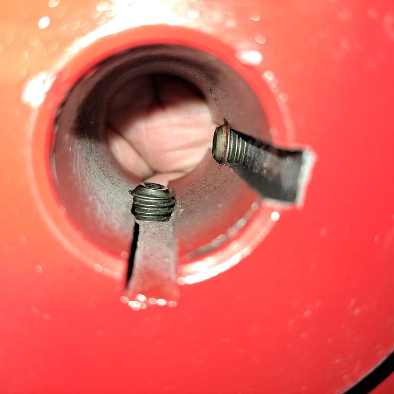

AlexR 3,139 #16 Posted January 12 Seals are all in, used electrical tape on the shafts and it worked good! Inspected the hub keyways again and they are all not good I have 2 sets. I am considering getting a broaching set and try that out. So my understanding of that is I need a 1-1/8" collar and a 1/4" broach of those of you who have done that, any tips or tricks or recommendations? 1 Share this post Link to post Share on other sites
ebinmaine 81,248 #17 Posted January 13 28 minutes ago, AlexR said: Seals are all in, used electrical tape on the shafts and it worked good! Inspected the hub keyways again and they are all not good I have 2 sets. I am considering getting a broaching set and try that out. So my understanding of that is I need a 1-1/8" collar and a 1/4" broach of those of you who have done that, any tips or tricks or recommendations? @Achto or @WHX?? 1 1 Share this post Link to post Share on other sites
Achto 32,953 #18 Posted January 13 46 minutes ago, AlexR said: 1-1/8" collar and a 1/4" broach of those of you who have done that, any tips or tricks or recommendations? Cut the new keyway 90 degrees to the old one. Drill & tap a 3/8-24 hole that goes through the new keyway. Use set screws in the old as well as the new hole. 2 Share this post Link to post Share on other sites
