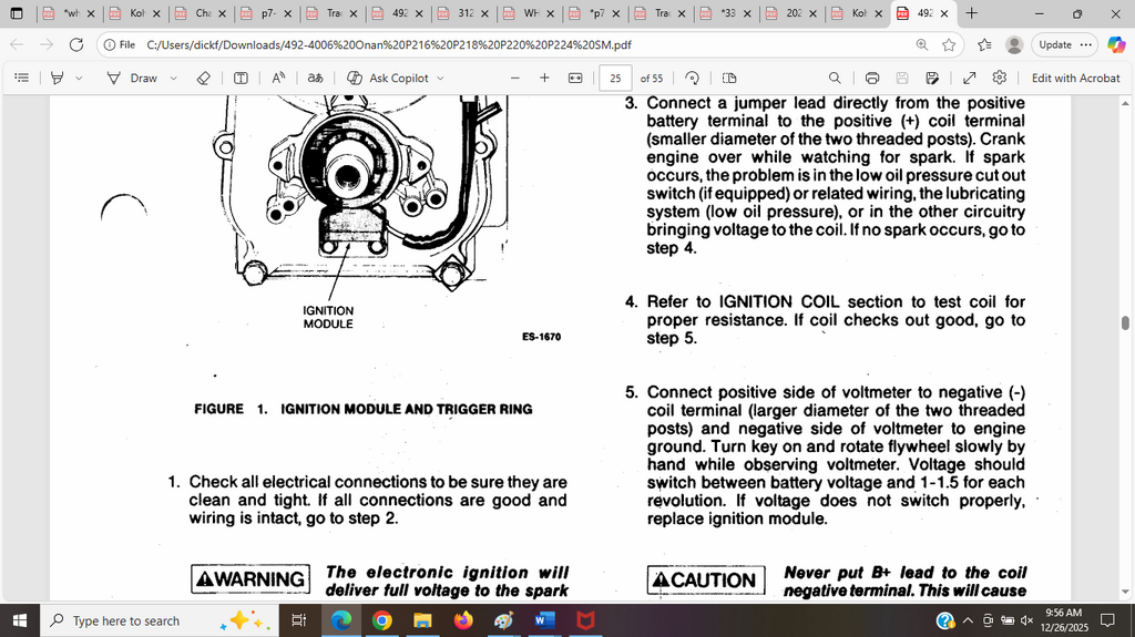

953 nut 68,500 #4 Posted December 26, 2025 6 minutes ago, nylyon said: have 12v to the coil but no fire. Time to check the ignition module. Share this post Link to post Share on other sites
nylyon-(Admin) 9,040 #5 Posted December 26, 2025 That’s my concern 1 Share this post Link to post Share on other sites
Bill D 3,099 #6 Posted December 26, 2025 Take a jumper and connect from the positive terminal on the coil to the positive terminal on the battery. If it starts your problem is probably the 9 pin connector. If you need to do the ignition module its not that hard. Tip: It can be changed without removing the stator. Share this post Link to post Share on other sites

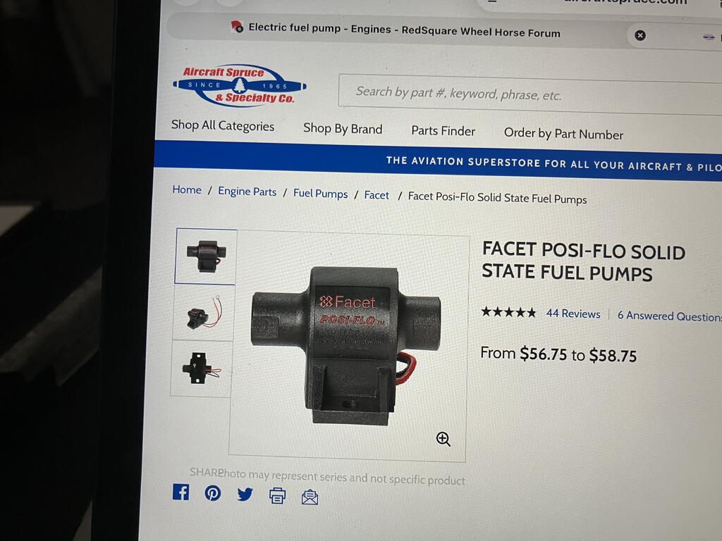

Retired Wrencher 6,920 #21 Posted December 28, 2025 On 12/26/2025 at 11:18 AM, nylyon said: True, the Hydro has an electric fuel pump, the 8-speed has always started much faster, today was the exception but it has sat for a little bit. I think that adding an electric fuel pump will certainly help though. Karl those fuel E-pumps like this one I have are they to go. Fast start up. 2 Share this post Link to post Share on other sites
nylyon-(Admin) 9,040 #22 Posted December 28, 2025 5 hours ago, Retired Wrencher said: Karl those fuel E-pumps like this one I have are they to go. Fast start up. I have an electric pump on my hydro, absolutely the way to go. I think I have a spare pump in the garage, just have to find it. 2 Share this post Link to post Share on other sites
Retired Wrencher 6,920 #23 Posted December 29, 2025 17 hours ago, nylyon said: I have an electric pump on my hydro, absolutely the way to go. I think I have a spare pump in the garage, just have to find it. Ben there done that. I put all parts in an old furniture cabinet. Saves time and effort. Share this post Link to post Share on other sites
