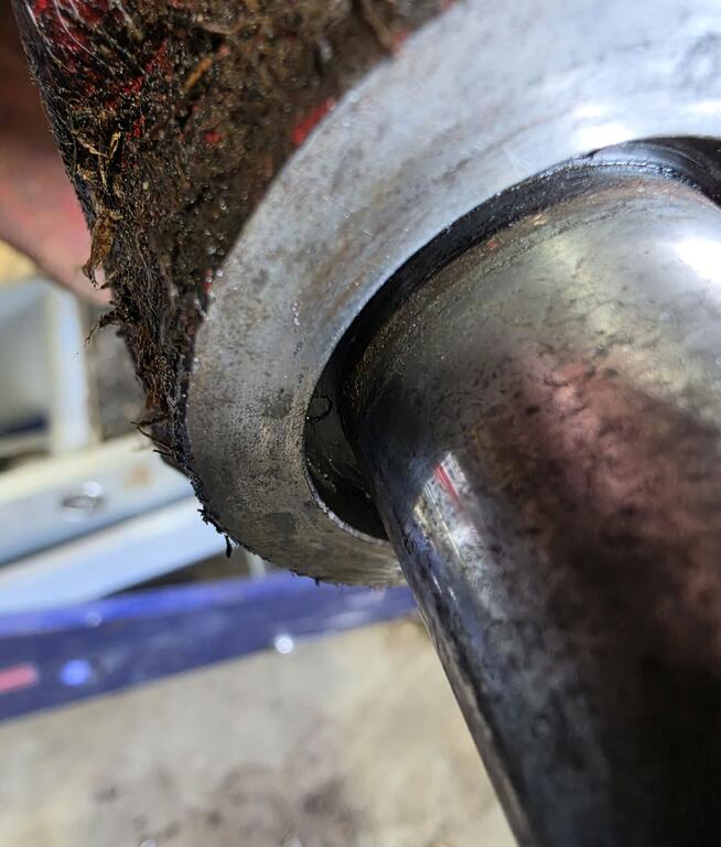

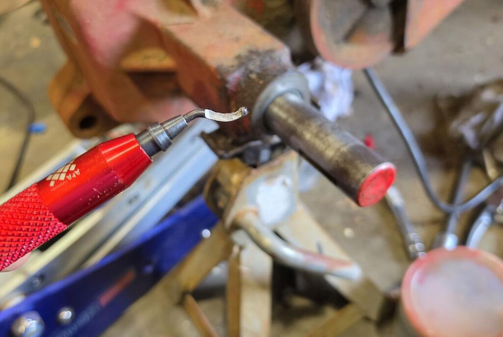

BradKahler 416 #26 Posted June 3 14 hours ago, AlexR said: This! I destroyed 2 seals on one axle, until I chamfered it some more with a small file. That's 2 votes for chamfering. I'll have to see what sort of tool/file I have available that might do the job. Thanks! Share this post Link to post Share on other sites
BradKahler 416 #27 Posted June 3 14 hours ago, sqrlgtr said: I have used saran wrap and a little oil over the ends of the axle to get seal started, but always deburrrrr everything good first. Was the saran wrap for getting the seal onto the shaft? If so, I didn't have any issues in that department, the problems was getting the seals pressed into the bores. 1 Share this post Link to post Share on other sites
ebinmaine 81,278 #28 Posted June 3 15 minutes ago, BradKahler said: Chamfering sounds like a pretty good idea. The original seals had a rubber outer housing, the SKF seals are steel with an edge to them. I wonder if lightly chamfering the edge of the seal might help some? It won't hurt but it's the transmission that really needs the angle chamfer. That's the thicker, harder metal. 3 Share this post Link to post Share on other sites
AlexR 3,139 #29 Posted June 3 (edited) 20 minutes ago, BradKahler said: Was the saran wrap for getting the seal onto the shaft? If so, I didn't have any issues in that department, the problems was getting the seals pressed into the bores. I file the edges of the keyway and wrap it with electrical tape to prevent damaging the seal. Also file any burrs that might be on the axle especially if there are extra set screws. And the chamfer that often needs filing is on the transmission case. And then like is mentioned oil the seal up prior to installing. Edited June 3 by AlexR 3 Share this post Link to post Share on other sites
sqrlgtr 4,224 #30 Posted June 3 (edited) 1 hour ago, AlexR said: I file the edges of the keyway and wrap it with electrical tape to prevent damaging the seal. Also file any burrs that might be on the axle especially if there are extra set screws. And the chamfer that often needs filing is on the transmission case. And then like is mentioned oil the seal up prior to installing. @BradKahler "Was the saran wrap for getting the seal onto the shaft? If so, I didn't have any issues in that department, the problems was getting the seals pressed into the bores." oh misunderstood never had any trouble going into case (knock on wood) but I have made seal drivers that are true/sqaure on the seal side that really helps. Edited June 3 by sqrlgtr 3 1 Share this post Link to post Share on other sites
953 nut 70,648 #31 Posted June 4 I have used a piece of inch and a quarter Schedule 80 PVC pipe to tap on driving the seals into the housing with a 1 1/8" axle. 3 Share this post Link to post Share on other sites
BradKahler 416 #32 Posted June 5 (edited) On 6/3/2026 at 8:53 AM, ebinmaine said: It won't hurt but it's the transmission that really needs the angle chamfer. That's the thicker, harder metal. On 6/3/2026 at 9:00 AM, AlexR said: I file the edges of the keyway and wrap it with electrical tape to prevent damaging the seal. Also file any burrs that might be on the axle especially if there are extra set screws. And the chamfer that often needs filing is on the transmission case. And then like is mentioned oil the seal up prior to installing. One of the two replacement seals showed up yesterday so I found my chamfering tool and used it to chamfer the axle housing. It worked out better than I expected. The ball on the end of the tool pressed against the ball bearing race which provided a solid backing for running the tool round the rim of the opening. After cutting the chamfer I used a vacuum to suck out any iron particles left behind. Installing the seal worked smoothly and easily. I do believe it's time to replace the cutting tip. I went ahead and chamfered the other axle opening and now I get to wait 10 days for the 2nd seal to arrive Edited June 5 by BradKahler 1 7 Share this post Link to post Share on other sites
BradKahler 416 #33 Posted June 5 On 6/4/2026 at 8:36 AM, 953 nut said: I have used a piece of inch and a quarter Schedule 80 PVC pipe to tap on driving the seals into the housing with a 1 1/8" axle. I have a piece of iron pipe I bored out on the lathe for a slip fit over the axle shaft. It worked nicely. 2 3 Share this post Link to post Share on other sites

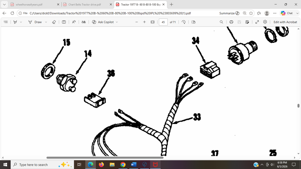

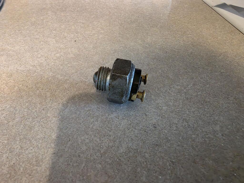

BradKahler 416 #34 Posted June 5 While cleaning up the wiring I found that the clutch safety switch wiring was gone. I pulled the switch to clean and test and it checked out ok. What kind of electrical connector is used on these switches? I'm guessint a 1/4" female spade connector, but I'd like to be sure before rewiring things. Thanks! 2 Share this post Link to post Share on other sites

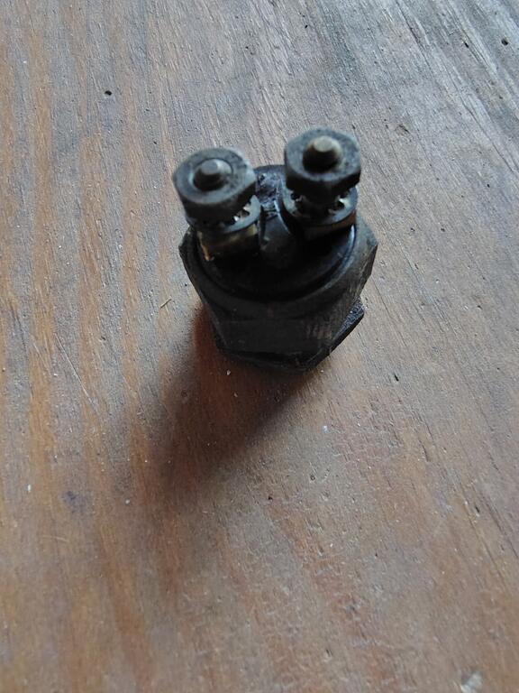

AlexR 3,139 #35 Posted June 5 (edited) My safety switches have brass studs for a ring connector. Looks like yours is different maybe someone with a later year tractor then mine can tell you. Edited June 5 by AlexR 2 Share this post Link to post Share on other sites
953 nut 70,648 #36 Posted June 5 The electric terminals that would connect to the posts would be a Packard 56 female which should be available at any Good auto parts store. The housing they insert into ( 36 ) is Wheel Horse part # 106024, unfortunately it is shown as no longer available on parts tree. Perhaps someone has a used wiring harness that has the housing or you may be able to find a housing that you could modify for this. Looking at DelCity's website I see that the four terminal female housing may work, the auto parts store may have one of them too. https://www.delcity.net/store/wire-connectors-quick-splices/packard-56-series-electrical-connectors/female-4-contact/ 4 Share this post Link to post Share on other sites
Handy Don 17,735 #37 Posted June 6 (edited) Here is a 2-cavity side mount that is what you need to slip onto the two flat-topped pins. Just be sure to orient the female connectors with their metal slots aligned with the openings in the housing! Edited June 6 by Handy Don 2 1 Share this post Link to post Share on other sites
BradKahler 416 #38 Posted June 6 12 hours ago, 953 nut said: The electric terminals that would connect to the posts would be a Packard 56 female which should be available at any Good auto parts store. The housing they insert into ( 36 ) is Wheel Horse part # 106024, unfortunately it is shown as no longer available on parts tree. Perhaps someone has a used wiring harness that has the housing or you may be able to find a housing that you could modify for this. Looking at DelCity's website I see that the four terminal female housing may work, the auto parts store may have one of them too. https://www.delcity.net/store/wire-connectors-quick-splices/packard-56-series-electrical-connectors/female-4-contact/ 11 hours ago, Handy Don said: Here is a 2-cavity side mount that is what you need to slip onto the two flat-topped pins. Just be sure to orient the female connectors with their metal slots aligned with the openings in the housing! Thanks for the leads on the correct plug Using the information provided I found this female plug on Amazon, 2P FEMALE BLACK 56 SERIES. I ordered a couple of them, I didn't order the electrical connectors because I think I have the correct Delphi connectors in my stash of crimp connectors. Thanks!!! 4 1 Share this post Link to post Share on other sites

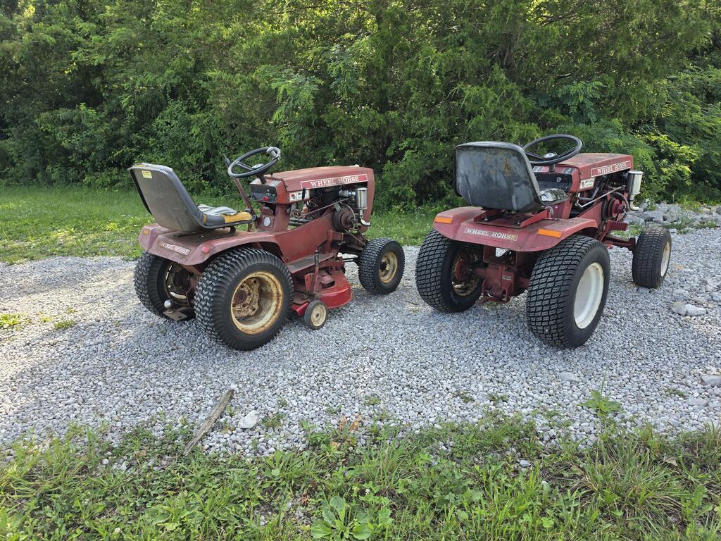

BradKahler 416 #41 Posted June 29 I'm happy to report the B100 is basically complete and useable as a tractor. It still has a leaky front left tire that needs an inner tube installed and a better seat would be nice. So I now have to functioning Wheel Horse tractors, the B80 4-speed and the B100 8-speed. I really like the low gear on the 8-speed, it will be really useful when grading the driveway. I was initially worried the motor on the 8-speed would have issues because it apparently sat outside with a vertical exhaust muffler that wasn't covered. Fortunately it runs great with virtually no smoke with just a slight amount on start up. Now that the B100 is useable I can finish up the grader blade I'm building and put it to work. Thanks for all the advice and comments during the rebuild 2 4 Share this post Link to post Share on other sites

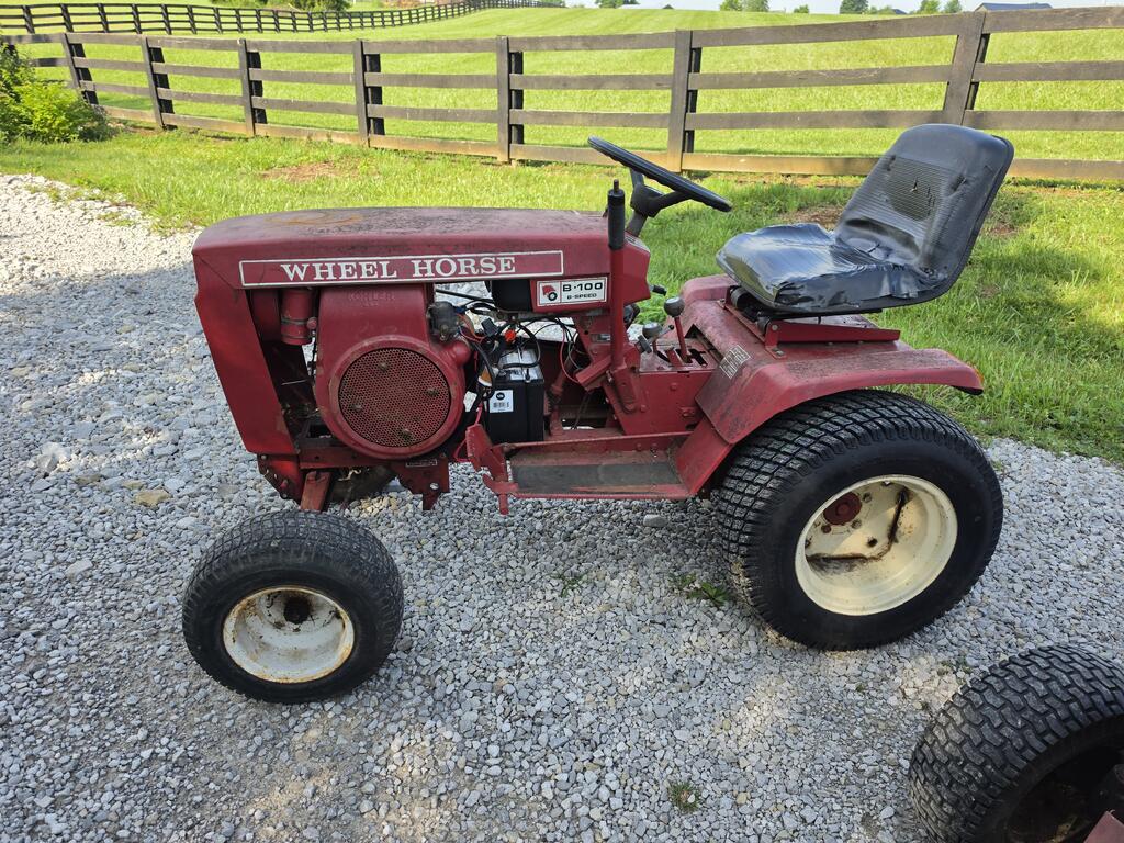

davem1111 2,453 #44 Posted June 30 Brad, I'm very glad that you were able to make a worker out of that B-100. Here is what it looked like when I found it - PO said it had been sitting for a "couple of years".... I like the new muffler you put on her. 2 1 Share this post Link to post Share on other sites
BradKahler 416 #45 Posted July 4 On 6/29/2026 at 9:33 PM, davem1111 said: Brad, I'm very glad that you were able to make a worker out of that B-100. Here is what it looked like when I found it - PO said it had been sitting for a "couple of years".... I like the new muffler you put on her. Thanks Dave! Of the four Wheel Horses that I currently have, this one is by far the best of the bunch. My biggest concern when I brought it home was the vertical exhaust, I figured there was a pretty good chance that the top end might be rusted badly. Fortunately that turned out to not be the case. The engine runs like a top Thanks again! Brad 1 1 Share this post Link to post Share on other sites

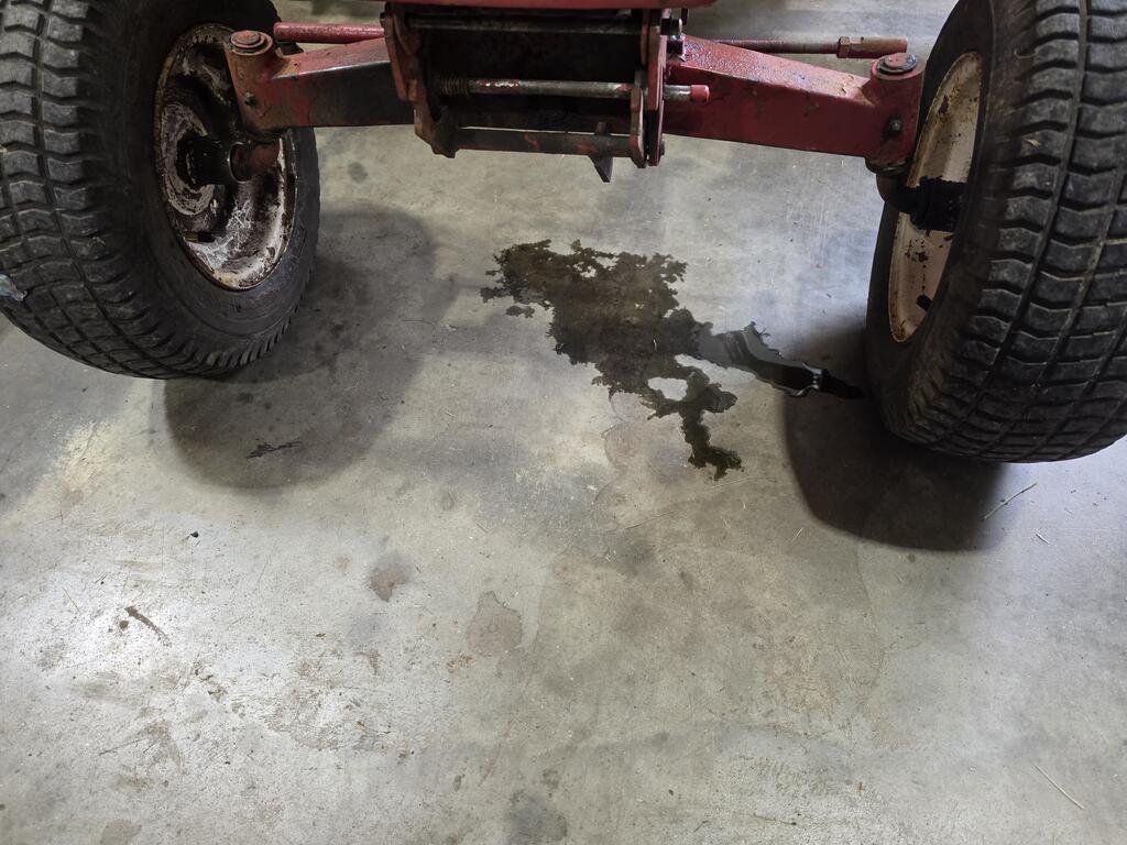

BradKahler 416 #46 Posted August 18 The test of the grader blade was pretty much a success wit the exception of one thing, and it didn't have anything to do with the blade. I ran the tractor for about 30 to 40 minutes working it the whole time and then parked it in the shop. A few days later I noticed oil under the engine, as shown in the attached picture. I checked the crankshaft output seal and didn't see any oil in that area. What I did find was oil on the side of the block under the carburetor. I'm guessing the breather might be plugged. Overall everything else went very well, just this oil leak. Is it a difficult task to fix a breather issue? 2 Share this post Link to post Share on other sites
sqrlgtr 4,224 #47 Posted August 18 1 hour ago, BradKahler said: Is it a difficult task to fix a breather issue? Worse thing in my opinion is having to remove carb. Not a big deal but it's the most aggravating part for me. I have one myself (701) doing the same thing and have been putting it off far to long now. 1 1 Share this post Link to post Share on other sites
BradKahler 416 #48 Posted August 19 1 hour ago, sqrlgtr said: Worse thing in my opinion is having to remove carb. Not a big deal but it's the most aggravating part for me. I have one myself (701) doing the same thing and have been putting it off far to long now. Thanks for that. I haven't checked the oil level yet, it was at the full mark when I started. I guess I should check to see just how much in 30 minutes of driving the level dropped. 1 Share this post Link to post Share on other sites
Handy Don 17,735 #49 Posted August 19 4 hours ago, BradKahler said: Is it a difficult task to fix a breather issue? Have new gaskets for the breather and look carefully in the manual for the correct orientation of all the parts! You don’t want to have to revisit this! 1 1 Share this post Link to post Share on other sites
