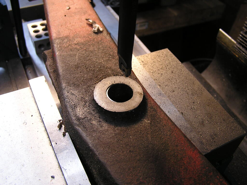

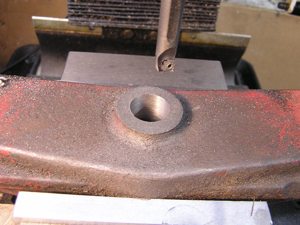

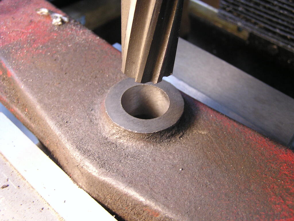

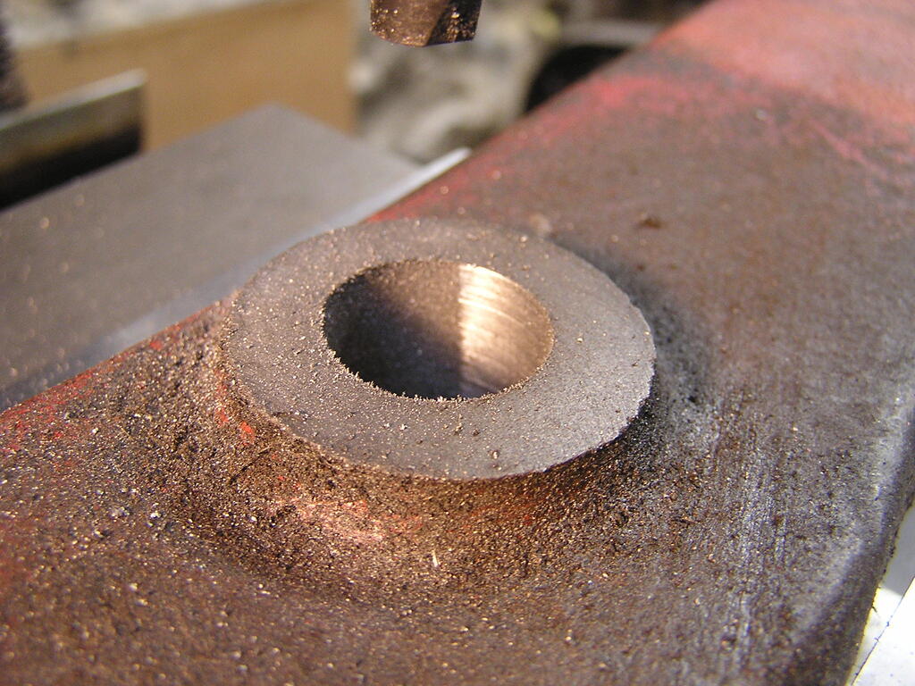

ri702bill 12,694 #1 Posted December 22, 2025 All: The center pivot hole in the C81 Axle had a bit of wear, so I decided to drill & ream it for bushings. Upon closer inspection, I noticed the hole was visibly not centered in the boss; I decided to correct that as the best I could. The 3/4" ID bushing has a 7/8" OD - I could use a Boring Head and safely relocate the center about 2/3rds of the 1/16" bushing wall thickness and still have material left to ream to size. If I had a larger wall bushing & reamer, I could have re-centered it.... First photo shows the new center moved .040 with a light cut. The second shows the interrupted cut as the boring bar is moved outward. Third shows the hole at .840 diameter where it became round again. Last photo is the finished reamed .875 diameter hole. 2 9 Share this post Link to post Share on other sites

ri702bill 12,694 #3 Posted December 22, 2025 (edited) 12 minutes ago, kpinnc said: Much like the axle bores in a Unidrive, I figured it was just the location some engineer decided on, and the jig used just repeated the same thing... The axle looks to be a sand casting - who knows how many times the Pattern was used, repaired, etc.?? There is a void in the middle, the same in the spindle bores... cuts down on the shaft guiding but gives a place to store grease... Wonder how they did that?? Edited December 22, 2025 by ri702bill 3 Share this post Link to post Share on other sites

ri702bill 12,694 #5 Posted December 22, 2025 The pivot holes elongate at the top from the weight of the engine; the canted spindle bores get elongated on opposite sides, top & bottom from the offset of the wheel. The key is the lineup and clamping the axle - not just down to the table, but also to eliminate it rotating if (when) the tool bites into the metal..... 2 Share this post Link to post Share on other sites
Handy Don 17,189 #6 Posted December 23, 2025 4 hours ago, ri702bill said: Third shows the hole at .840 diameter where it became round again. Nice work! This sentence just tickled me -- I’m visualizing the hole magically morphing itself from wallowed and off center to more centered and round! 3 Share this post Link to post Share on other sites
ri702bill 12,694 #7 Posted December 23, 2025 Look again at the second picture. The dark portion of the wall is the original wallowed out part - the shiny part is the new cut at a bit more than 50% of the hole. Each pass the new cut gets longer, until the ends meet as they did at .840... the hole was both moved & round.... 3 Share this post Link to post Share on other sites
