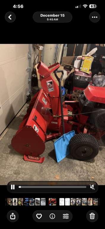

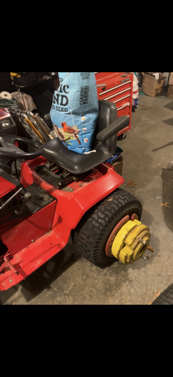

Keith R 31 #1 Posted December 22, 2025 What do you guys think is to much ballast. I just purchased chains that I will install. Also need one more weight to complete my suitcase set! 1 Share this post Link to post Share on other sites
moe1965 774 #2 Posted December 22, 2025 (edited) I have about 50 lbs on each wheel on a 854 and chains and that thing is a beast when it comes to pushing snow. I have more of a hard time getting traction on the front to steer with a load of snow up front. I usually lift up a little on the blade when im in a turn and it gives me some down pressure so I can direct the snow where I want to go. I haven't tried bird seed for traction yet but I'll give it a try. Lol Edited December 22, 2025 by moe1965 1 1 Share this post Link to post Share on other sites
ri702bill 13,067 #3 Posted December 22, 2025 Welcome! OK, my ... Weight evenly distributed in or on the rear wheels is preferred. Are your tires fluid filled?? Fluid in the tire is perfectly centered.. Next, a set of inside and outside weights are preferred over what I see on yours. Your two sets of outer weights are creating an overhung condition that are easy to get caught up on objects. Added weight on the tractor frame is effective, but not preferred. All this concern is due to the Unidrive outer axle bearings - overdo it and you are setting them up for premature failure. Again, my 3 1 Share this post Link to post Share on other sites

Keith R 31 #11 Posted December 22, 2025 Thanks for the input there is a 2 stage on the front of that 520hc. I’m really enjoying it. Having some small problems but getting there! Loosing spark occasionally that I will soon remedy and general maintenance. 4 Share this post Link to post Share on other sites

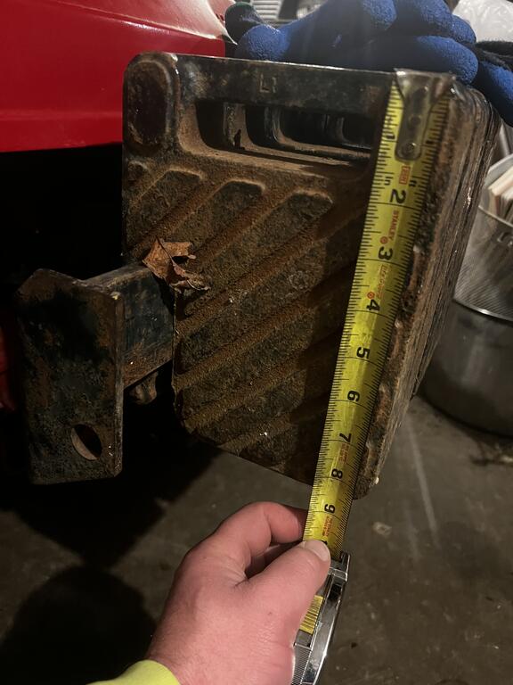

Keith R 31 #12 Posted December 22, 2025 Thanks for the input there is a 2 stage on the front of that 520hc. I’m really enjoying it. Having some small problems but getting there! Loosing spark occasionally that I will soon remedy and general maintenance. Are the rear suitcase weights rare or hard to come by? 1 Share this post Link to post Share on other sites
ebinmaine 80,707 #13 Posted December 22, 2025 3 hours ago, pfrederi said: . I have never had the same success as others with no weights and just aggressive tires. Same here. I've tried AGs with no chains. NEVER AGAIN. We have just enough tilt to the area being plowed that there's no "bite" without chains. 3 Share this post Link to post Share on other sites
ebinmaine 80,707 #14 Posted December 22, 2025 2 hours ago, Keith R said: Are the rear suitcase weights rare or hard to come by? Depends on the brand and area of the country. 2 Share this post Link to post Share on other sites
Keith R 31 #15 Posted December 22, 2025 I’m not sure of who made the weights they are unmarked, but the bracket is wheel horse! 1 Share this post Link to post Share on other sites

953 nut 69,313 #19 Posted December 23, 2025 On 12/22/2025 at 6:51 AM, ri702bill said: Your two sets of outer weights are creating an overhung condition that are easy to get caught up on objects. If you were to catch an immovable object with those weights it could very well brake a hub. Fluid filled tires with chains and 50 pounds on each wheel will get the job done nicely, Mu driveway is fairly steep and that is all I have ever used. 5 1 Share this post Link to post Share on other sites

squonk 48,125 #21 Posted December 24, 2025 Can you post a pic of one of those suitcase weights and tell me how much they weigh individually? I may have the same set here. I don't know if I would be willing to part with just 1 as I would have to go out and see how many I actually have. I would most likely want to sell them as a set but if I have 5 of them I could let 1 go. Haven't had eyes on them in years. Share this post Link to post Share on other sites
Keith R 31 #22 Posted December 24, 2025 I think they are 25 lbs I’ll get one on a scale soon! Share this post Link to post Share on other sites
