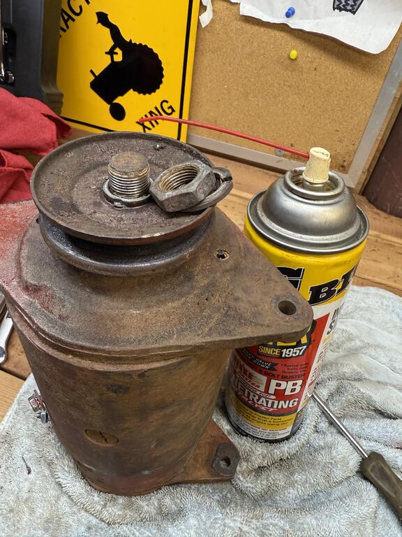

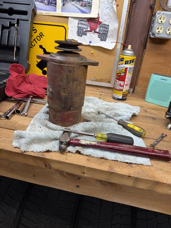

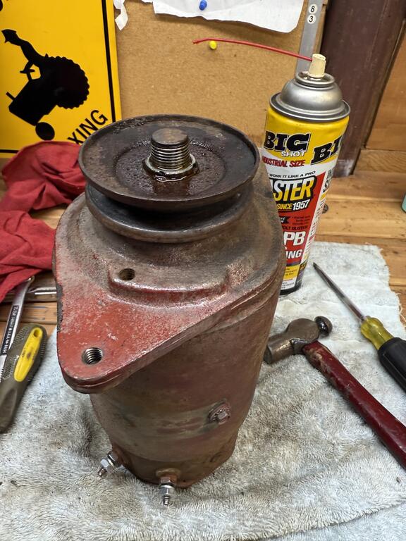

Sparky-(Admin) 26,360 #1 Posted December 21, 2025 Starting on the 857’s starter gen repair. The rebuild video on YouTube never mentions the pulley…and tips or tricks to get it off without destroying it? 2 Share this post Link to post Share on other sites

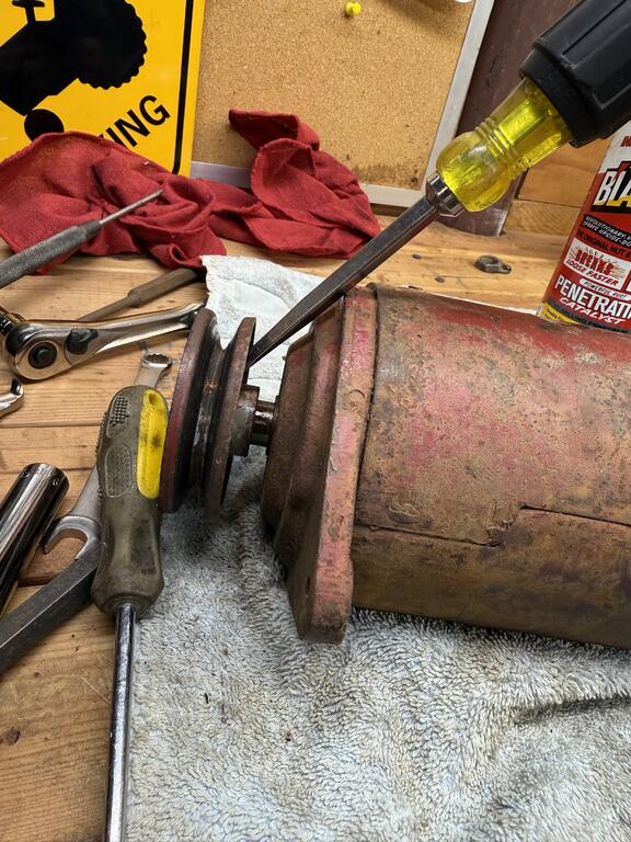

Sparky-(Admin) 26,360 #2 Posted December 21, 2025 Alright…PB Blaster and some screwdriver/hammer work and she is coming loose! 2 Share this post Link to post Share on other sites

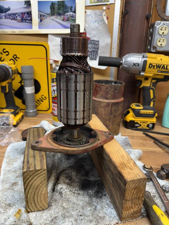

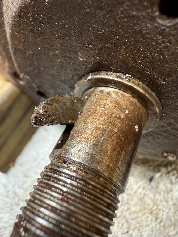

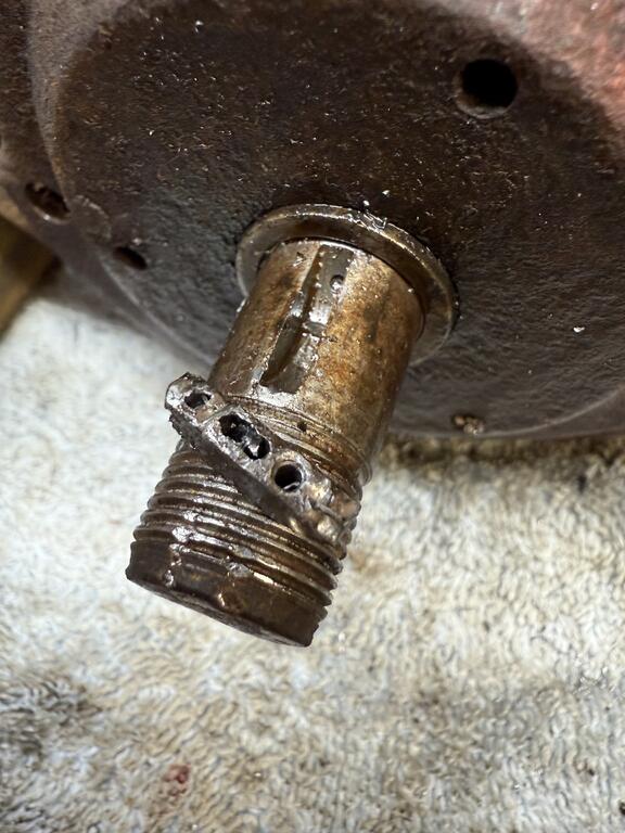

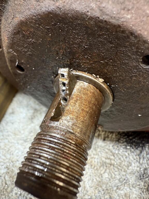

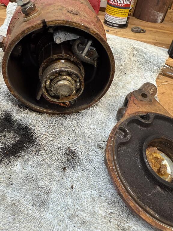

Sparky-(Admin) 26,360 #3 Posted December 21, 2025 Watched a video…why does my project not go the same way the one in the video goes . My end cap is off but the pulley that I should be driving outa the end cap stayed on the shaft. Share this post Link to post Share on other sites
WHX?? 58,138 #4 Posted December 21, 2025 (edited) 4 hours ago, Sparky said: Watched a video…why does my project not go the same way the one in the video goes . Because your watching stupid videos instead of insulting the guys here. Bearing collar or wood wedges behind the pulley hub. Put the screwdrivers down and slowly step away. The pulley and woodruff MUST come off first. Don't worry about mangling the woodruff ... common but guard the nut like it is your wedding ring. It puts the rear end back on until the front end is off. Too much wobble can mar the armature. SG rookies like you make idiots like me wonder why I never did that SG instructional. Edited December 21, 2025 by WHX?? 1 5 Share this post Link to post Share on other sites
sqrlgtr 3,932 #5 Posted December 21, 2025 (edited) 30 minutes ago, WHX?? said: make idiots like me wonder why I never did that SG instructional. It's never too late to make video! I for one would like to see that done. Shucks @WHX?? its wintertime and would be a good time to do it. Besides dat the days are going to be getting longer from here on out for a little while anyhows.Icant speak for other things but KNow fur sure u no idiot when it comes to Wheel Horses' Edited December 21, 2025 by sqrlgtr Share this post Link to post Share on other sites
Sparky-(Admin) 26,360 #6 Posted December 22, 2025 1 hour ago, WHX?? said: The pulley and woodruff MUST come off first. Don't worry about mangling the woodruff ... common but guard the nut like it is your wedding ring. It puts the rear end back on until the front end is off. Too much wobble can mar the armature. Hmm…good info. Tomorrow I’ll reassemble and try to get the woodruff out before moving forward 2 Share this post Link to post Share on other sites

Sparky-(Admin) 26,360 #9 Posted December 22, 2025 50 minutes ago, WHX?? said: What's the matter with it Sparky just bearings? Yeah, one of the bearings is crazy loud. Now that I’ve messed with it I’m sure it’s the one behind the pulley. But I have both so it’ll get both replaced. It has always started the 857 just fine and charges perfectly, but it’s loud. 1 Share this post Link to post Share on other sites

WHX?? 58,138 #11 Posted December 23, 2025 9 hours ago, Sparky said: but it’s loud. Mostly a whining noise I bet. Funny thing I put tractors away for the winter and they are quiet. Get them out in the spring and there're noisy. Sometimes goes away after run time sometimes not. Bearings are a real common 6203-2RS. lemme know you need them I buy them in bulk. Greasy Pete will tell you to pick a seal out, clean & repack with red tacky. Really not the worst idea. Stock up on brake cleaner you will go through a full can cleaning the body. End bells can go in a parts cleaner but NOT the body. Same with the armature use the blowgun and brake cleaner. Wear gloves the carbon will NOT come off hands. Put up a pic of the commutator will school ya on servicing that. 1 1 Share this post Link to post Share on other sites

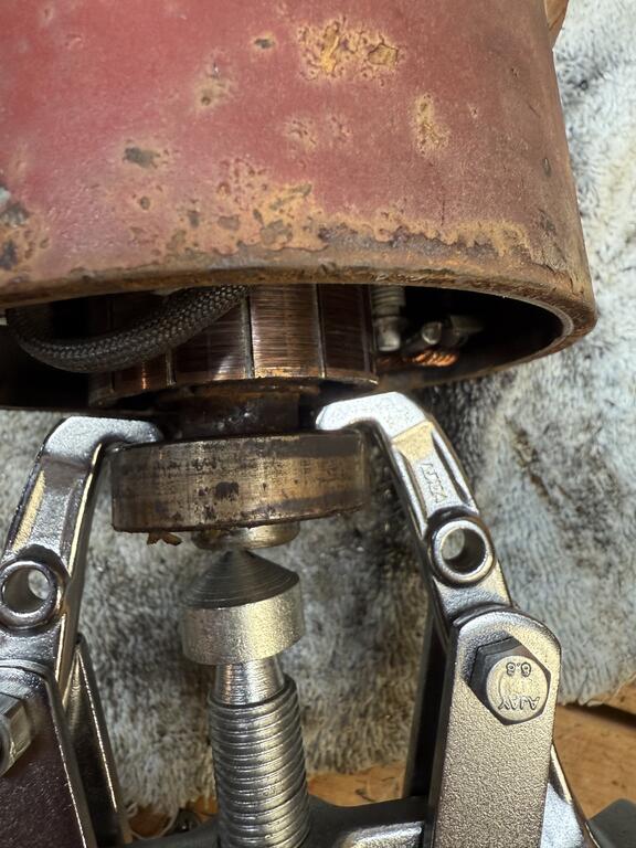

sqrlgtr 3,932 #12 Posted December 23, 2025 Just curious. Is there any reason not use a 3 jaw puller on pulley? Share this post Link to post Share on other sites
WHX?? 58,138 #13 Posted December 23, 2025 (edited) 7 minutes ago, sqrlgtr said: Just curious. Is there any reason not use a 3 jaw puller on pulley? No that's fine .. it would have to be a smaller puller the shaft is only 5/8" . Some pullies are thin stamped metal so don't use a jaw puller on those they bend real easy... I haven't seen many of those on a Horse most of are stout steel. Edited December 23, 2025 by WHX?? 1 Share this post Link to post Share on other sites

Sparky-(Admin) 26,360 #16 Posted December 26, 2025 Done! She starts the tractor, charges once running AND it’s quiet! But every step was a fight! Woodruff key stuck, one bearing stuck on the shaft, one of the three little bearing cover screws had to be drilled out etc. But I won, so there’s that! Will be nice to putt around shows and not hear that whiney bearing. 2 3 Share this post Link to post Share on other sites
