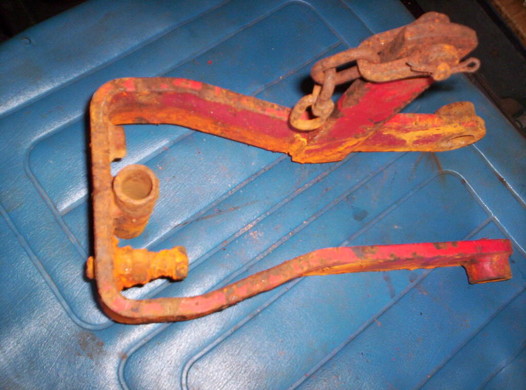

FLtractor 149 #1 Posted December 21, 2025 Evening, Came across this on marketplace, wondering if anyone can tell or show me how it is used to tow and or with implements, are they common or sought after? Haven’t ever seen one myself Share this post Link to post Share on other sites
ebinmaine 77,972 #2 Posted December 21, 2025 I don't believe that one fits most WH tractors. You can use it to pull a trailer with a pin or install a ball type hitch. Most Wheelhorses have a "tab hitch" at the back. There'll be a similar setup to the one pictured above. Does your own tractor have a hitch? Do you want one? I have several extras... 2 Share this post Link to post Share on other sites
squonk 45,887 #3 Posted December 21, 2025 Looks like a J.C. Whitney universal bumper add on hitch so you can tow a 10,000lb. trailer with 67 Dodge Dart! 3 10 Share this post Link to post Share on other sites
ebinmaine 77,972 #4 Posted December 21, 2025 2 minutes ago, squonk said: Looks like a J.C. Whitney universal bumper add on hitch so you can tow a 10,000lb. trailer with 67 Dodge Dart! Only if it had a small straight 6! 1 1 Share this post Link to post Share on other sites
WHX?? 55,829 #5 Posted December 21, 2025 2 hours ago, ebinmaine said: I have several extras... draw bar ones EB? Don't scrap them @Achto and I hoard them and put them on all our tractors along with a slot hitch. 3 1 1 Share this post Link to post Share on other sites
ebinmaine 77,972 #6 Posted December 21, 2025 Just now, WHX?? said: draw bar ones EB? Don't scrap them @Achto and I hoard them and put them on all our tractors along with a slot hitch. I ain't scrappin' em. I have several I'd give away if someone else needs them. 3 Share this post Link to post Share on other sites

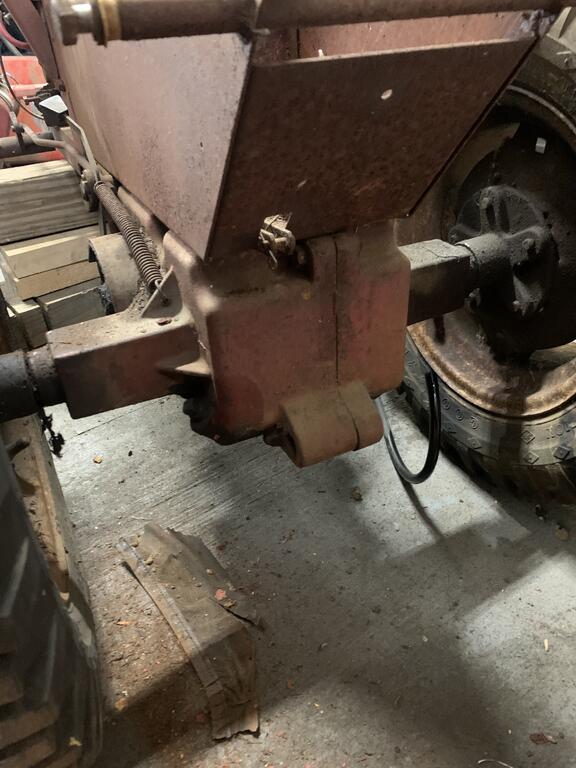

ebinmaine 77,972 #14 Posted December 30, 2025 1 minute ago, 855project said: Well mainly just pull a cart or small trailer around the yard or woods, we don’t have any other attachments for the tractor yet so it will just be used for pulling things right now. And you have absolutely nothing there right now? No tab? Any chance of posting a pic? Share this post Link to post Share on other sites
855project 52 #15 Posted December 30, 2025 This is the current rear of the tractor 1 Share this post Link to post Share on other sites
ebinmaine 77,972 #16 Posted December 30, 2025 Might be a little tough to see in this picture. These are tab Style hitches. I'd be happy to send you one for a few bucks plus shipping costs. You would need a Cross Pin to hold it on the transmission and a couple of spacers which are easy to make or purchase. I can get you Dimensions later today or tomorrow. 1 2 Share this post Link to post Share on other sites
855project 52 #17 Posted December 30, 2025 Absolutely! I’d jump all over that deal just let me know what you need to have for one and what shipping is, I’m in Wisconsin 53959. thank you the mount on the back of our tractor is 3 inches wide. 3 Share this post Link to post Share on other sites
ebinmaine 77,972 #18 Posted December 30, 2025 3 minutes ago, 855project said: Absolutely! I’d jump all over that deal just let me know what you need to have for one and what shipping is, I’m in Wisconsin 53959. thank you the mount on the back of our tractor is 3 inches wide. I'll send you a PM with details 1 Share this post Link to post Share on other sites

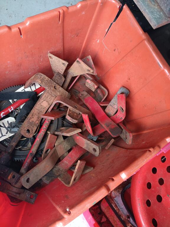

WHX?? 55,829 #19 Posted December 31, 2025 (edited) @855project Always good to have another cheese head here. @Achto and I are just a little north of you and have some parts. 18 hours ago, ebinmaine said: Any chance of posting a pic? Yes pics please!!! Holy crap Bear more than a few ... now that is hoarding! You see all those Dan?!?!? All is needed Project is one of those and a hitch pin for tub pulling. Just a 3/4 rod ... easy to make. Guys just cheat and use a 3/4 bolt too. Send him some spacers too EB bet you hoard them as well ... Edited December 31, 2025 by WHX?? 4 Share this post Link to post Share on other sites
ebinmaine 77,972 #20 Posted December 31, 2025 19 minutes ago, WHX?? said: Send him some spacers too EB bet you hoard them as well ... Believe it or not... no. A few of them extra hitches came from @Handy Don with a parts pile last year. The rest are my own extras. I use a receiver style for much larger loads. I "only" have about 10 or 11 hitches. Maybe 2 are Trina's? 3 Share this post Link to post Share on other sites
WHX?? 55,829 #21 Posted December 31, 2025 5 minutes ago, ebinmaine said: Believe it or not... no. The way you hoard ... not ... I may have some Project. 2 Share this post Link to post Share on other sites
ebinmaine 77,972 #22 Posted December 31, 2025 2 minutes ago, WHX?? said: hoard This from the guy with no idea how many tractors he has? BTW I'm not hoarding. I'm..... ummm. Carefully storing some stuff. 5 Share this post Link to post Share on other sites

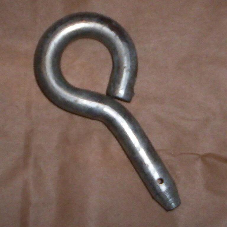

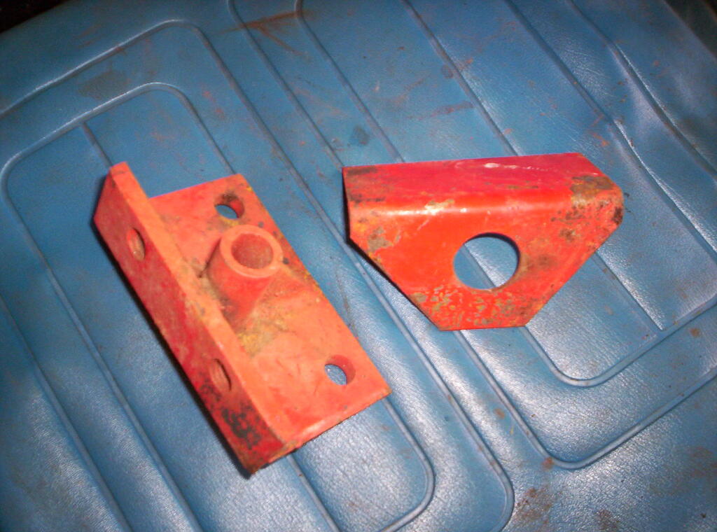

groundhog47 448 #23 Posted December 31, 2025 (edited) 22 hours ago, 855project said: Hi I’m new to the site, my nephew and I are fixing up an 855 that he bought this summer, it currently does not have a hitch and we are wanting to get one for when it is done. What style does anyone recommend we look for? Thank you. Depending on what you intend to do. I only know of 4. For general towing ther is one for plowing there is one and for the older tractors there is one that lifts and tows. The "what I would call standard" is most used . I will try and post some pictures 1st pic is what I call standard, 2nd is for lifting plows ect and 3rd on right is part for 2, 4th is pin. for 1st. The other (WHX has good pic above) hitch pic is on a post I just viewed and don't want to swipe it, mine ya can't make out Will try and find post and post a link. Also in BROWSE>MANUALS>IMPLEMENTS ,or misc, you might be able to find more info especially what piece of equipment requires which hitch. Hope that/this helps. And Welcome to RED SQUARE Edited December 31, 2025 by groundhog47 3 Share this post Link to post Share on other sites

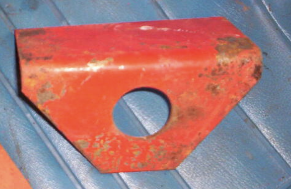

Handy Don 16,109 #24 Posted December 31, 2025 25 minutes ago, groundhog47 said: Depending on what you intend to do. As @ebinmaine noted, intended use is everything. The drawbars he pictured are perfect for pulling significant loads but with a light tongue weight--wagons and so forth. (Note: WHs are capable of moving a lot more weight than their brakes can safely stop.) This one is commonly called a Brinly or a clevis hitch. Normally set up to lift and pull. Soil plow, cultivator, rear grader blade, and so forth. Was always an optional accessory. Implement had top and bottom flanges that extended above and below the cylindrical socket, forming a clevis. A pair of adjusting bolts (only one shown) allowed constraining side to side rotation of the attached implement. The second image is an optional plate that goes over the clevis socket and hangs at the back as a sacrificial for absorbing wear from the constraining bolts. This one is called a slot hitch. It handles the same functions as the clevis, but with a different connection to the tractor. It came standard on many tractors through the early 70’s. The implement had a tongue that fit into the slot and was held by a pin. The second image shows a slot-to-clevis adaptor sold by one of our vendors. l If you search the 000’s of posts on this site, you’ll find other creative and practical hitches designed and built by members that attach to the front, middle, and rear of their tractors! 1 Share this post Link to post Share on other sites

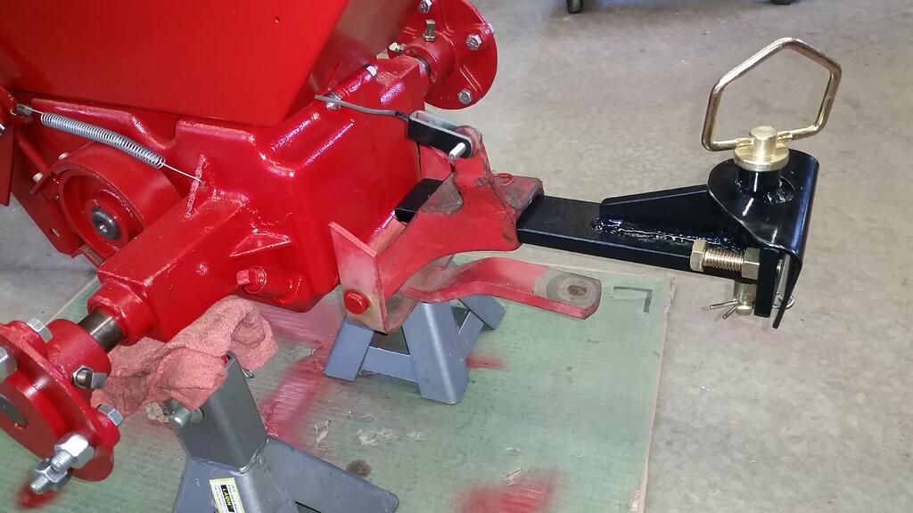

WHX?? 55,829 #25 Posted December 31, 2025 (edited) If you prefer too you can just run a slot hitch with a piece of flat stock with two holes. looks like you have the lift cable for a slot. You can also put a a ball on the flat stock for lighter trailers with a ball coupler. Edited December 31, 2025 by WHX?? 1 Share this post Link to post Share on other sites
