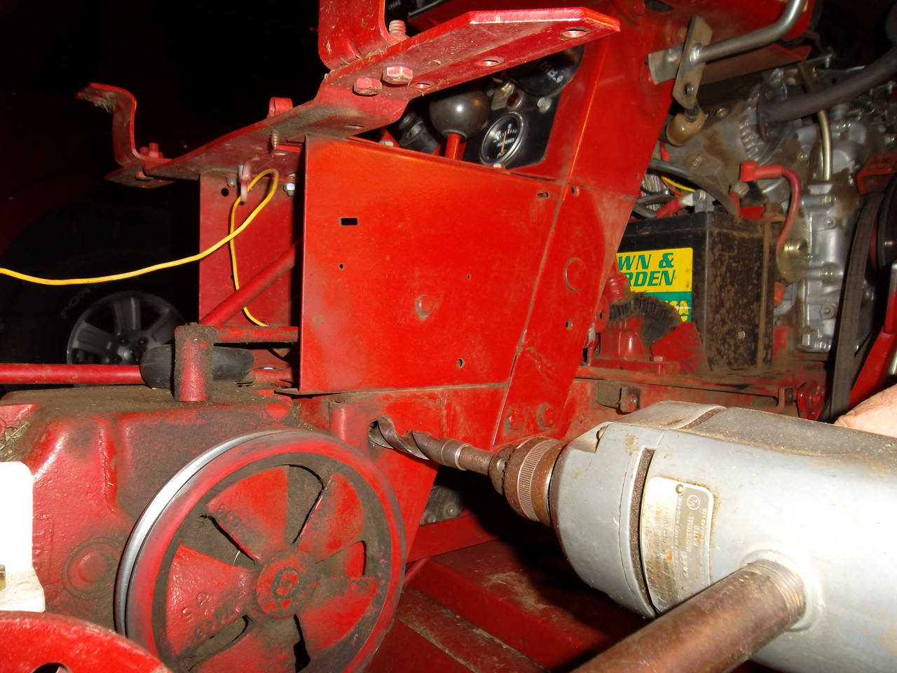

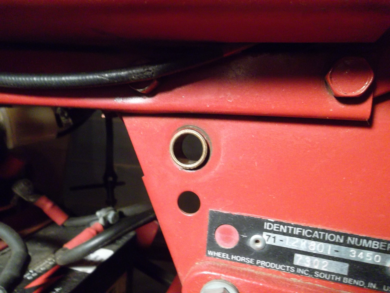

Lee1977 7,744 #28 Posted December 21, 2025 I can be done with less, I just used my 50 year old 1/2" drill. [/url I also did the same with the PTO shaft while I working on my C-120. 1 2 Share this post Link to post Share on other sites
ri702bill 12,689 #29 Posted December 21, 2025 6 hours ago, Lee1977 said: I can be done with less, I just used my 50 year old 1/2" drill. Agreed. But the risk factor for damaging the frame, yourself, and possible misalignment goes up. As I mentioned in the first panel, I too considered this method..... I already had the tractor disassembled, and the ShopSmith.... so, why not? I'd rather post this in the "Customization & Modifications" section than in "Bumps & Bruises". 2 Share this post Link to post Share on other sites

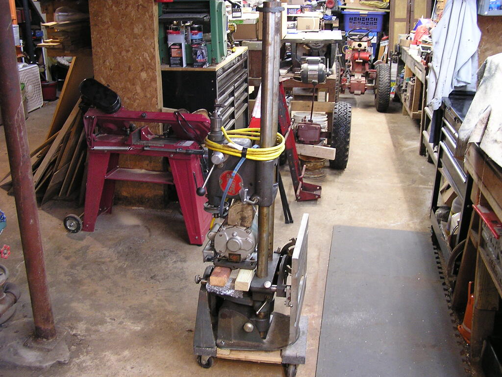

Retired Wrencher 6,901 #31 Posted December 21, 2025 21 hours ago, ri702bill said: Thanks. Google "ShopSmith" - it is a clever versatile tool. Setup horizontally, it can be a lathe, a horizontal drill, a table saw, or a disc sander. Set up vertically, it is a drill press with a 3 foot throat opening! Later versions modified the tilting saw table to become a small bandsaw too. The three motor speeds as supplied are achieved with stepped pulleys. This application has a larger driven pulley to slow it down... Latest version has a built-in variable speed control. It does a lot, but with compromises... and the components are heavy! "Big Dollars"?? Maybe not.... this one, although not complete, was FREE - I had to get the Jacobs chuck & key, the 3 quill handles were missing too. I use it mostly as a vertical drill to touchup small engine valve seats using tapered mounted stones. Works well for that. My father back in the 60s and early 70s had one. Did a lot of work with that. 3 Share this post Link to post Share on other sites

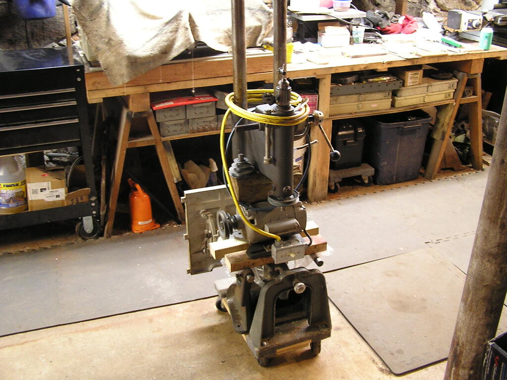

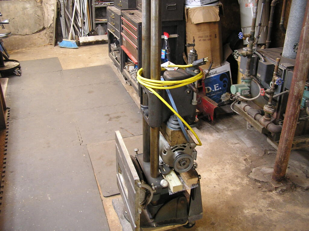

ri702bill 12,689 #32 Posted December 21, 2025 OK all done. Got the ShopSmith disassembled and packed up. Stacked size is 18" x 18" x 58".... 2 1 Share this post Link to post Share on other sites
