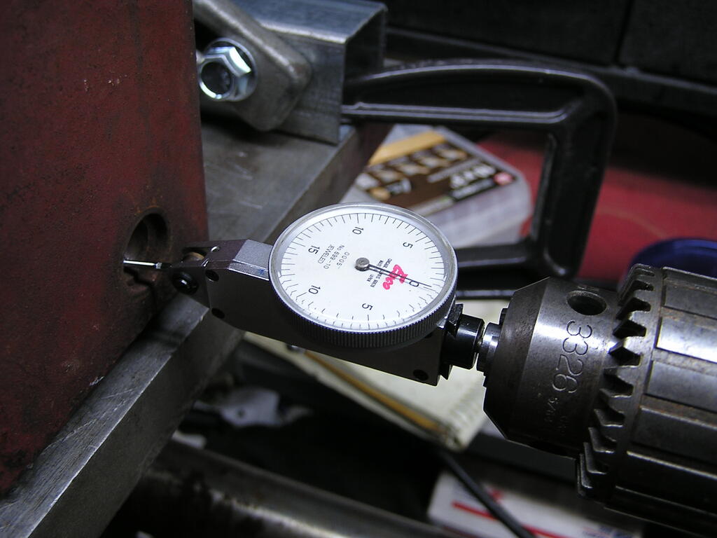

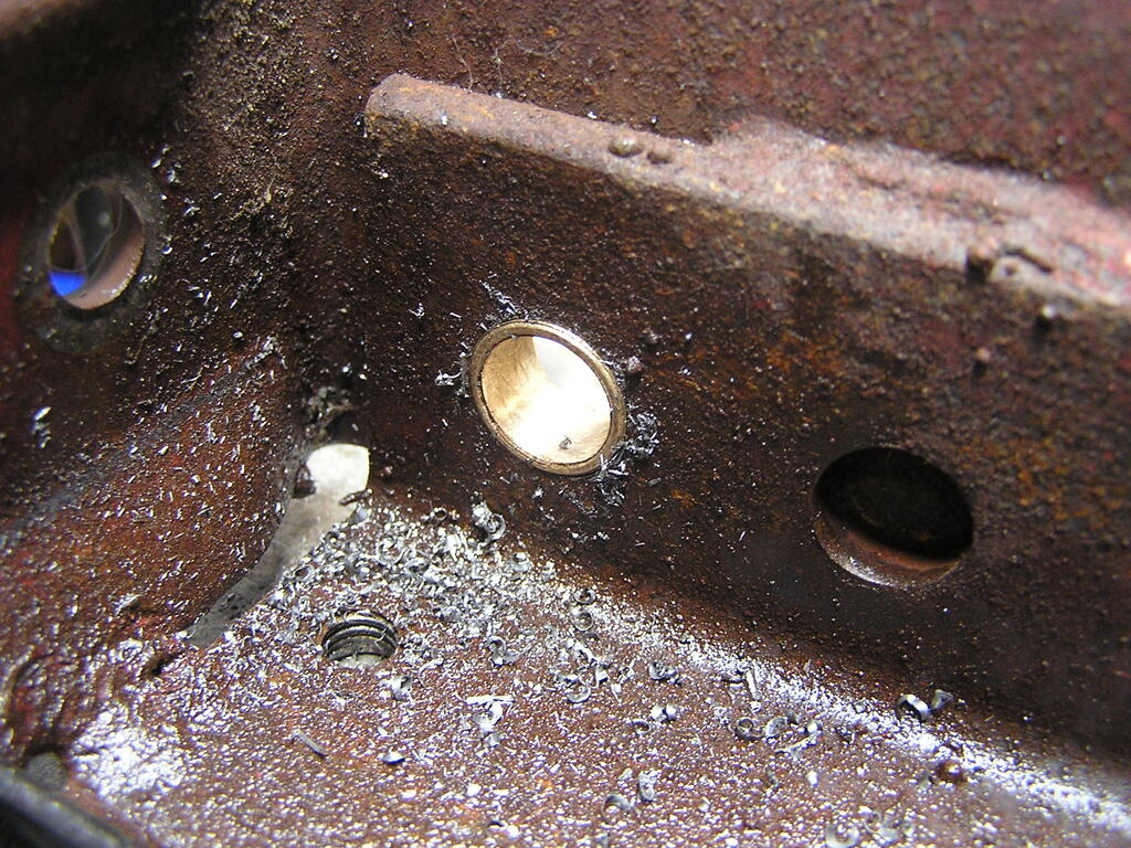

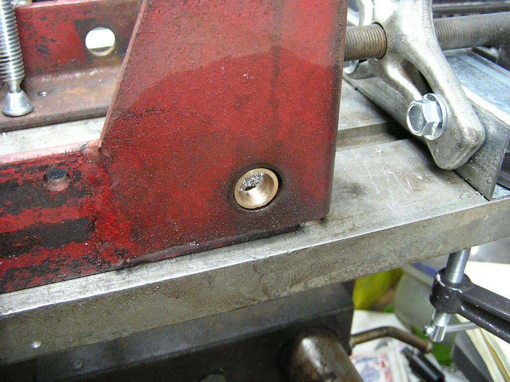

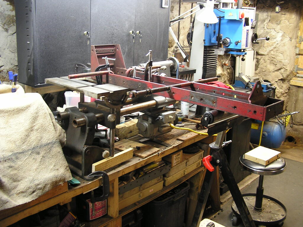

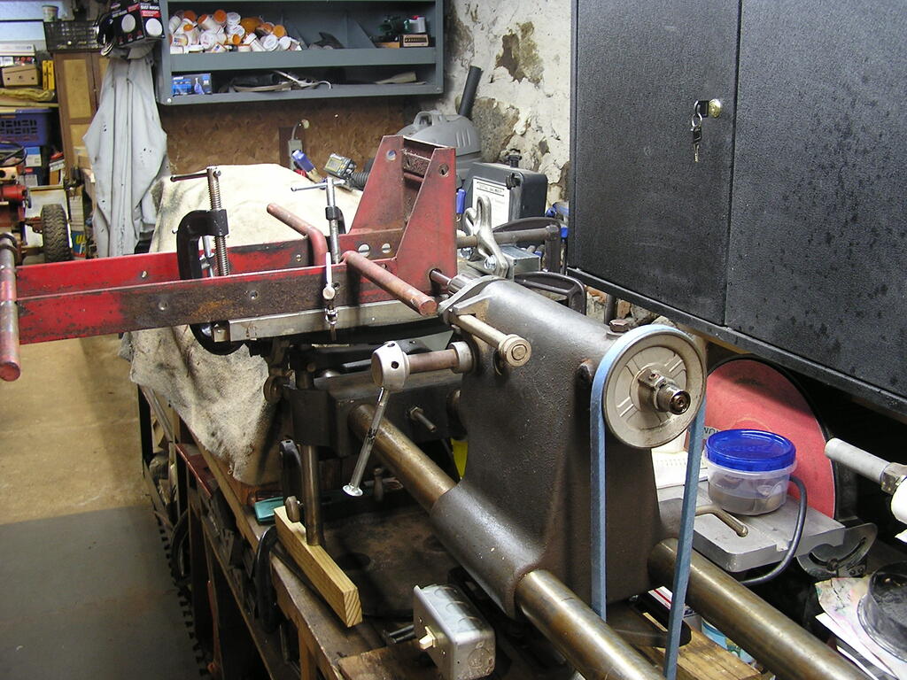

ri702bill 13,393 #1 Posted December 20, 2025 There was a fair amount of wear on the ends of the C81 Clutch Shaft where it goes thru the frame. Metal on metal, no bearings & not easily lubricated. I installed the bronze bushings on the 502 frame a while back, using the milling machine. The C Series has two sets of welded 3/4" diameter rods to hold the foot rests, the rear ones were in the way - could not do this in the milling machine. There were 3 choices - cut the rear rods off & reweld them later, do the work by hand, or - break out the 1950's ShopSmith 10E and use it. I went with option #3 - while the assembly & setup are extensive, it gives the best results. Pictures are for the RH bearing: the setup needs to come apart and be reassembled opposite hand to do the left. 1 20 Share this post Link to post Share on other sites

ri702bill 13,393 #6 Posted December 20, 2025 (edited) 2 hours ago, ebinmaine said: Very nice work here Bill. That's the type of lathe I'd like to have someday. Thanks. Google "ShopSmith" - it is a clever versatile tool. Setup horizontally, it can be a lathe, a horizontal drill, a table saw, or a disc sander. Set up vertically, it is a drill press with a 3 foot throat opening! Later versions modified the tilting saw table to become a small bandsaw too. The three motor speeds as supplied are achieved with stepped pulleys. This application has a larger driven pulley to slow it down... Latest version has a built-in variable speed control. It does a lot, but with compromises... and the components are heavy! "Big Dollars"?? Maybe not.... this one, although not complete, was FREE - I had to get the Jacobs chuck & key, the 3 quill handles were missing too. I use it mostly as a vertical drill to touchup small engine valve seats using tapered mounted stones. Works well for that. Edited December 20, 2025 by ri702bill 3 Share this post Link to post Share on other sites
953 nut 70,653 #7 Posted December 20, 2025 9 minutes ago, ri702bill said: It does a lot, but with compromises If a person is well organized and has limited space the Shop Smith is a good alternative to a well equipped woodworking shop. The biggest drawback is setting everything up for the next operation, can take an hour of setup to do a ten minute job, but it got the job done for you. 5 Share this post Link to post Share on other sites

ri702bill 13,393 #13 Posted December 20, 2025 1 hour ago, 8ntruck said: The ridigity of the machine limits the metal working capability. Agreed. I'm not trying to be a hero and plow thru the frame in one pass. Drilling in progressive small steps - first .531 diameter, then .547, then .562, and .591. Then ream to .625 diameter. All light material removal & small chips. 5 2 Share this post Link to post Share on other sites
953 nut 70,653 #14 Posted December 20, 2025 13 minutes ago, ri702bill said: Agreed. I'm not trying to be a hero and plow thru the frame in one pass. Drilling in progressive small steps - first .531 diameter, then .547, then .562, and .591. Then ream to .625 diameter. All light material removal & small chips. That is the best way I've found to turn an oval back into a round hole. 3 Share this post Link to post Share on other sites
Handy Don 17,735 #15 Posted December 20, 2025 21 minutes ago, ri702bill said: Agreed. I'm not trying to be a hero and plow thru the frame in one pass. Drilling in progressive small steps - first .531 diameter, then .547, then .562, and .591. Then ream to .625 diameter. All light material removal & small chips. And there is always the question of where should the center actually be? Sometimes it matters little and sometimes a lot! 3 Share this post Link to post Share on other sites
ri702bill 13,393 #16 Posted December 20, 2025 Just now, 953 nut said: That is the best way I've found to turn an oval back into a round hole. Funny you mention that. Two reasons. While sweeping the bore for the best lineup, the existing hole is elongated. Gotta go slow. The next task is to drill & ream the Axle pivot & spindle holes for bushings. All show elongation of the original bores. One of the spindle holes looks to be centered on one end of the casting - the exit is off center by almost 1/8", partially due to wear - leaving a very thin wall. The plan will be to move the hole away from the thin wall using a boring head in the milling machine to reestablish a round bore 1 2 Share this post Link to post Share on other sites
