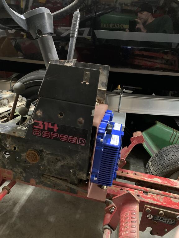

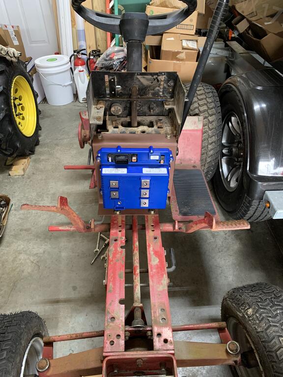

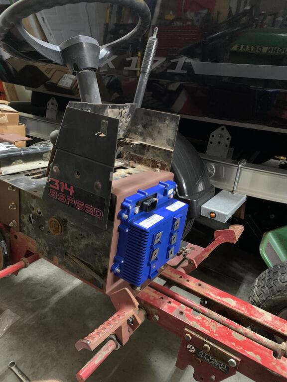

Richard’s 314-8 65 #35 Posted January 3 Controller, Alltrax AC2, was little bigger than I was expecting but got it mounted 8 2 Share this post Link to post Share on other sites

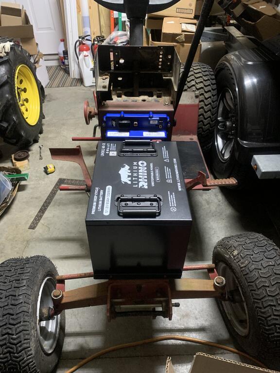

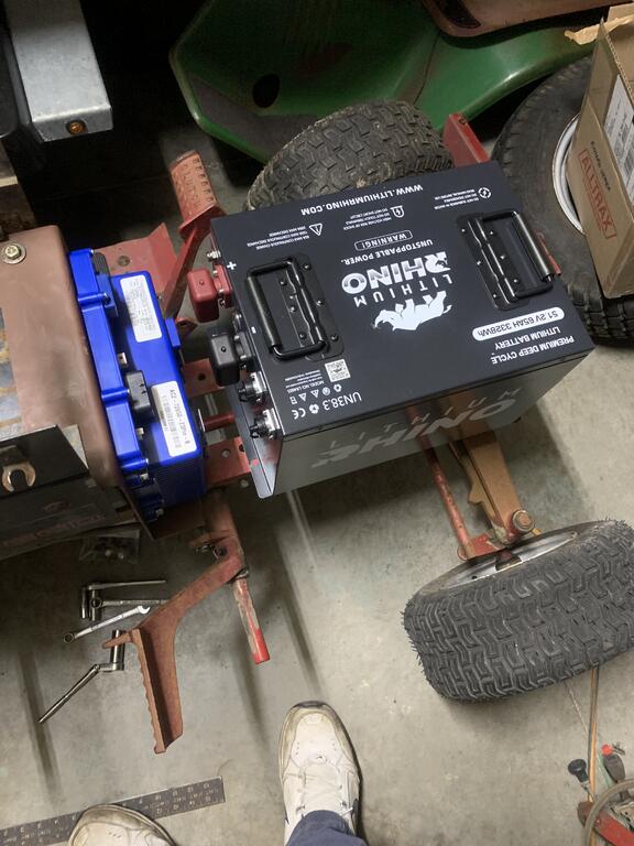

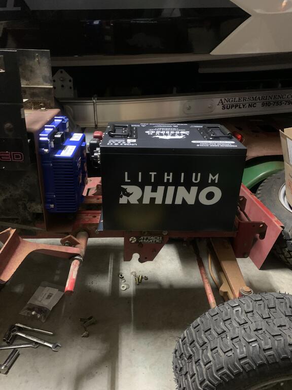

Richard’s 314-8 65 #36 Posted January 10 Battery showed up today 5 3 Share this post Link to post Share on other sites
kpinnc 18,770 #37 Posted January 10 (edited) 34 minutes ago, Richard’s 314-8 said: Battery showed up today Yeah, that is a bleeping battery! 51V, 65AH... That's a big fella! Edited January 10 by kpinnc 1 Share this post Link to post Share on other sites
Richard’s 314-8 65 #38 Posted January 10 53 minutes ago, kpinnc said: Yeah, that is a bleeping battery! 51V, 65AH... That's a big fella! I originally was going to use a 105AH and still might in the future but this 65AH was easier to fit and mount Share this post Link to post Share on other sites
kpinnc 18,770 #39 Posted January 10 2 hours ago, Richard’s 314-8 said: originally was going to use a 105AH and still might in the future but this 65AH was easier to fit and mount Well you certainly have my attention on this build. I'd love to have a quiet machine! 1 Share this post Link to post Share on other sites

WHX?? 57,486 #42 Posted January 10 8 hours ago, kpinnc said: 51V, 65AH... That's a big fella Does that controller charge too? You might have it covered already Richard but a thread going on making battery cables. 1 Share this post Link to post Share on other sites

Richard’s 314-8 65 #48 Posted January 10 2 hours ago, WHX?? said: Does that controller charge too? You might have it covered already Richard but a thread going on making battery cables. Thank you for the battery cable link. The controller charges when off the throttle coasting which won’t be much on a tractor. The battery came with a charger you can mount onboard or offboard. 2 1 Share this post Link to post Share on other sites

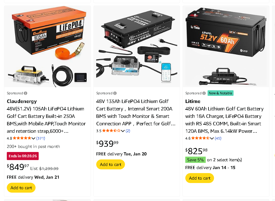

JoeM 10,101 #49 Posted January 10 The sky is the limit. Got them all over Amazon https://www.amazon.com/s?k=rhino+lithium+battery+51v&crid=1L76NJXAWZPW5&sprefix=rhino+lithium+battery+51v%2Caps%2C277&ref=nb_sb_noss_1 2 Share this post Link to post Share on other sites
