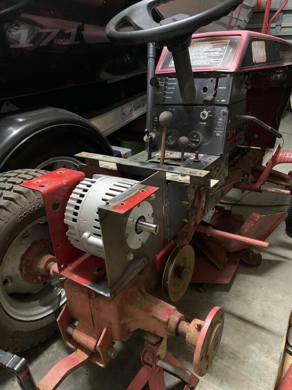

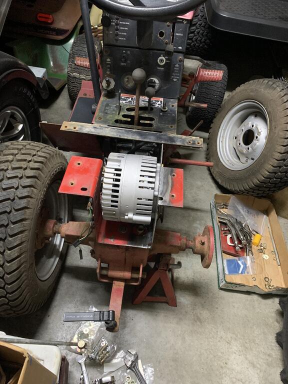

Richard’s 314-8 65 #1 Posted December 19, 2025 I’m converting my 314-8 to electric 7 11 Share this post Link to post Share on other sites

Richard’s 314-8 65 #6 Posted December 19, 2025 1 hour ago, SylvanLakeWH said: 2 hours ago, Richard’s 314-8 said: 1 hour ago, SylvanLakeWH said: Very cool! Please post details. Motor, controller etc. And Thank You! I’m using a Motenergy ME1118 motor and Alltrax AC2 controller. I don’t have a battery yet, that will be next months purchase 1 1 Share this post Link to post Share on other sites
Richard’s 314-8 65 #7 Posted December 19, 2025 36 minutes ago, ri702bill said: Nice welding. Planning on doing a brake upgrade too?? Weight of batteries?? (or a really long extension cord)?? Thank You! No brake upgrade. I’m using lithium battery so should weigh less than original kohler 1 Share this post Link to post Share on other sites

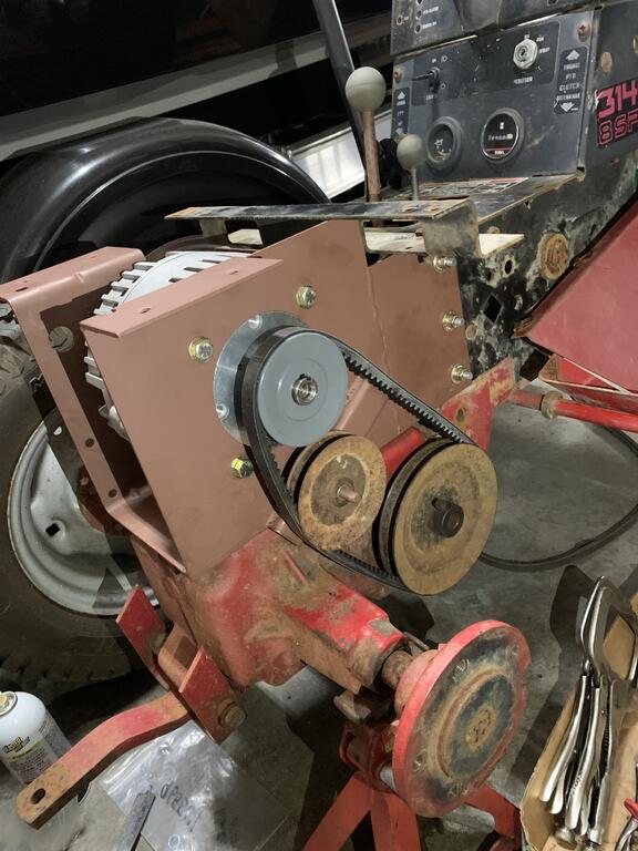

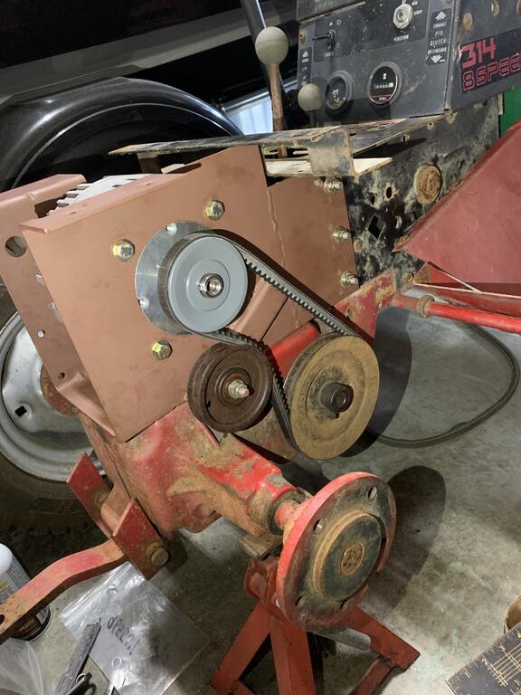

Richard’s 314-8 65 #19 Posted December 30, 2025 I made the belt tensioner last week. Originally was using the existing v-pulley from the factory belt tensioner but then decided to use the flat pulley from the mower deck tensioner to get a better wrap around the drive pulley to prevent slipping. I have 3 different drive pulleys to try, 4” that matches original engine, 3-1/2 that I have installed, and a 3” pulley. 6 6 Share this post Link to post Share on other sites
wallfish 20,699 #20 Posted December 30, 2025 Nice project! I like that flat idler pinching the belt idea much better for that application. 2 Share this post Link to post Share on other sites

peter lena 10,095 #23 Posted January 1 @Richard,s 314-8, nice idea , thought I would tell you about that flat idler belt pulley / tiny bearing , known for failure / noise , would recommend getting a similar replacement , with a larger bearing that could possibly get better lubricant , they regularly fail , if that belt starts to fray from incremental lubrication failure , it will show itself . pete 1 Share this post Link to post Share on other sites
Richard’s 314-8 65 #24 Posted January 2 6 hours ago, peter lena said: @Richard,s 314-8, nice idea , thought I would tell you about that flat idler belt pulley / tiny bearing , known for failure / noise , would recommend getting a similar replacement , with a larger bearing that could possibly get better lubricant , they regularly fail , if that belt starts to fray from incremental lubrication failure , it will show itself . pete Thank you for that advice! I’m leaning as I go with everyone’s help. 1 Share this post Link to post Share on other sites
kpinnc 19,015 #25 Posted January 2 47 minutes ago, Richard’s 314-8 said: Thank you for that advice! I’m leaning as I go with everyone’s help. I'm really looking forward to seeing this build unfold. The idea of a super quiet tractor is pretty awesome! I'm curious- what will you use to replace the clutching function? 1 Share this post Link to post Share on other sites
