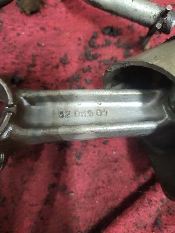

Domenic 13 #1 Posted December 19, 2025 I split the case on my c175 because it started knocking and when I took the crank shaft out I noticed that the bolts holding the connecting rod onto the crank shaft were both lose. Ive been looking to buy a new piston rod and rod cap but cant seem to find one anywhere. If anyone knows where I can get one please let me know. 1 Share this post Link to post Share on other sites

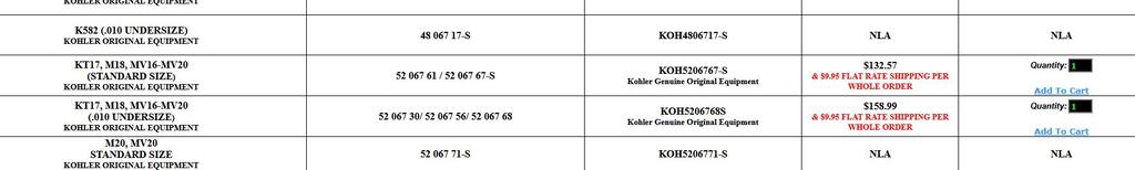

Achto 32,099 #2 Posted December 19, 2025 (edited) 1 hour ago, Domenic said: Ive been looking to buy a new piston rod and rod cap but cant seem to find one anywhere Found some complete rebuild kits. https://www.ebay.com/itm/185525360554 Edited December 19, 2025 by Achto 2 Share this post Link to post Share on other sites
pfrederi 20,874 #3 Posted December 19, 2025 Parts are getting hard to find for KTs. Especially over/under. Pats small engine seem to have rods 1 Share this post Link to post Share on other sites
953 nut 67,458 #4 Posted December 19, 2025 You should have the cylinder jugs and crank measured at a machine shop to see what needs to be done before buying any parts. No need to spend a lot of money on rods, rings and gaskets only to find out that the engine has other problems. 3 2 Share this post Link to post Share on other sites
