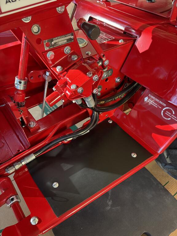

Handy Don 17,168 #76 Posted January 12 55 minutes ago, RoubaixRider said: hat black adhesive that looks almost like sandpaper. Great work. Sold as grip for skateboards! A HUGE variety of colors and patterns available. 2 1 Share this post Link to post Share on other sites

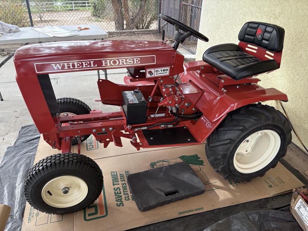

RoubaixRider 284 #77 Posted January 12 3 hours ago, Handy Don said: Great work. Sold as grip for skateboards! A HUGE variety of colors and patterns available. I found the rubber online for the Wheel Horse…$40. Think I’ll cut some 1/8 inch rubber and fasten it in place with 3M two sided tape and lag bolts through those holes. 1 Share this post Link to post Share on other sites
Handy Don 17,168 #78 Posted January 12 (edited) 11 minutes ago, RoubaixRider said: I found the rubber online for the Wheel Horse…$40. Think I’ll cut some 1/8 inch rubber and fasten it in place with 3M two sided tape and lag bolts through those holes. The risk you might have is water getting between the mat and the foot rest during use or when washed. If the mat is your decision, I’d consider rubber cement. I went with the skateboard stuff (in boring black) and am pleased. Edited January 12 by Handy Don 4 Share this post Link to post Share on other sites
RoubaixRider 284 #79 Posted January 13 (edited) For the moment, I had some rubber in my shop, and just put that down so that I could occasionally sit on the tractor and make engine noises, dreaming of doing laps in the yard😂. Edited January 13 by RoubaixRider Added image 5 1 Share this post Link to post Share on other sites
Handy Don 17,168 #80 Posted January 13 Vroom Vroom Putt Putt 1 1 Share this post Link to post Share on other sites

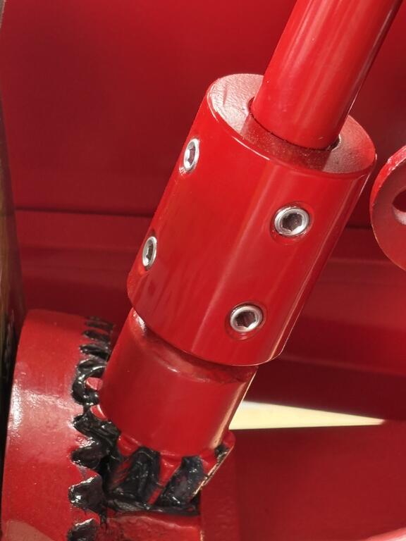

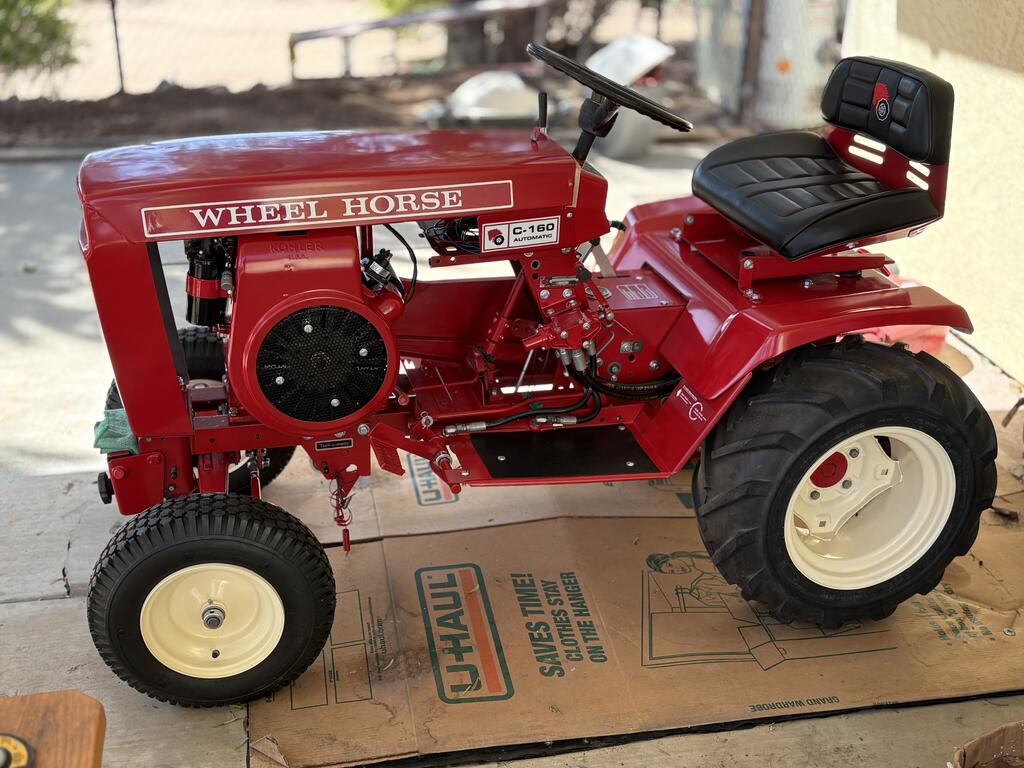

RoubaixRider 284 #81 Posted January 21 Steering column “upgrade”. well, as I had mentioned before, it was impossible to get the old pin out of the steering wheel to be able to pull the column apart… So I found a nice shaft collar, painted it to match and it does a nice job. I slightly drilled a detent into the shaft so that the Alan key bolts would seat into it for a good positive contact. Got the decals on and turning my attention now to electrical and engine tear down. That may take a little while, with those pesky work requirements stealing my time away from the shop.🤓 1 6 Share this post Link to post Share on other sites

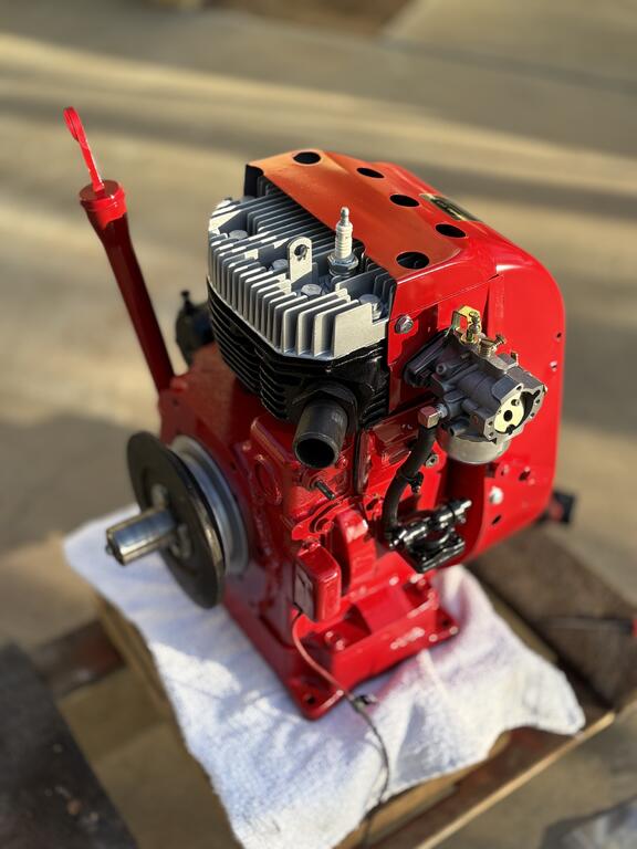

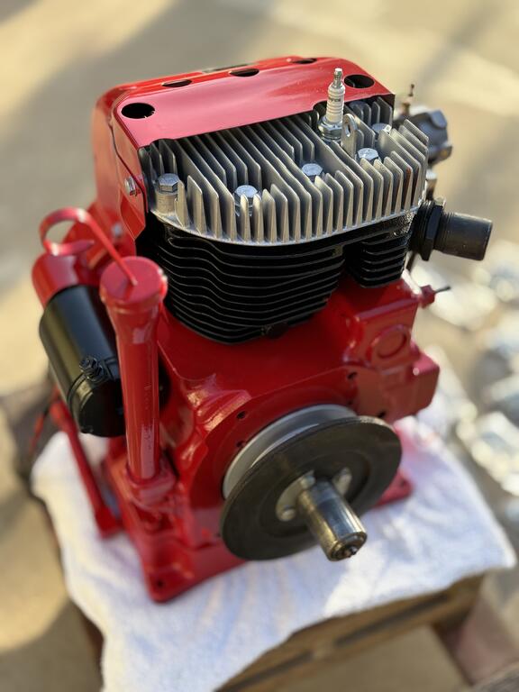

RoubaixRider 284 #82 Posted April 18 Well, following an insane week of flight training in the Blackhawk, I gave my brain a few days to recuperate and now getting the recently rebuilt K341 put back together for installation. I had to take quite a long break away from the Tractor because of all the work requirements of life, so this is feeling kind of nice and therapeutic. Jason 1 7 Share this post Link to post Share on other sites
RoubaixRider 284 #83 Posted April 18 Ok, well… decided to drop the engine in for fit, and everything‘s looking good. Going to start snugging things up a little and then continuing with dressing the engine with all of the freshly painted and prepped accessories. 2 11 Share this post Link to post Share on other sites

c-series don 12,304 #88 Posted April 21 @RoubaixRider I certainly admire your attention to detail sir! My kinda guy 👍🏻 When I saw that you painted the heads of the set screws on the steering shaft collar it made me smile. @cleat will appreciate this type of work as well! 1 1 Share this post Link to post Share on other sites

sqrlgtr 3,583 #91 Posted April 21 (edited) 28 minutes ago, c-series don said: When I saw that you painted the heads of the set screws on the steering shaft collar it made me smile I just assumed they were stainless; didn't realize they were painted, and @RoubaixRider if I hadn't mentioned before that is one sharp C160 brother. Edited April 21 by sqrlgtr 1 Share this post Link to post Share on other sites

RoubaixRider 284 #93 Posted April 28 (edited) On 4/20/2026 at 6:55 PM, sqrlgtr said: I just assumed they were stainless; didn't realize they were painted, and @RoubaixRider if I hadn't mentioned before that is one sharp C160 brother. Ha! That’s so funny that you guys noticed the painted screw heads on the steering shaft collar! One of the reasons why I literally replaced every bolt on the tractor was because I love the contrast of new bolts over fresh paint. I’m really cracking up right now that you guys noticed that!😂 the bolts that came with the shaft were bare metal so I knew they would end up rusting, and we just can’t have that! Edited April 29 by RoubaixRider 1 Share this post Link to post Share on other sites

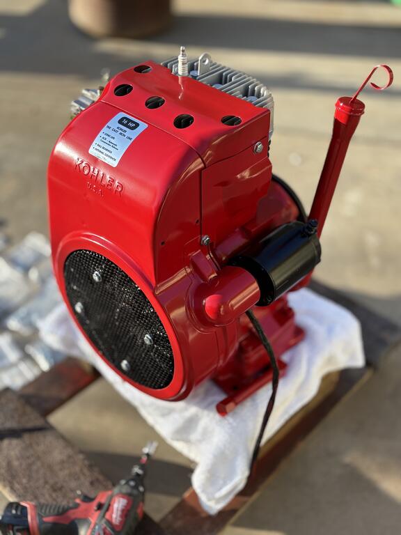

RoubaixRider 284 #94 Posted April 28 OK, boys… So the engine is installed and I’ve done all of the break-in runs as per the instructions of my engine guru, Brian, in San Diego at San Diego Small Engines. Getting the engine fine-tuned now and it is running about 95% of the way I want it… Just small adjustments from this point on. But… Now I need to get the proper engine to transmission drive belt. The information I can find says that it is a 5/8 x 82“, but I just can’t see how that will be possible to fit on… Any advice or ideas guys? I have access to a tractor supply that has tons of belts that are all through 5/8x80 to 5/8x90. I could just go and buy a series of them in returns the ones that don’t fit… Lol, Lord knows I’ve done that a few times in my life.😂😂 Share this post Link to post Share on other sites
RoubaixRider 284 #95 Posted April 28 On 4/20/2026 at 6:27 PM, c-series don said: @RoubaixRider I certainly admire your attention to detail sir! My kinda guy 👍🏻 When I saw that you painted the heads of the set screws on the steering shaft collar it made me smile. @cleat will appreciate this type of work as well! Oh Boy! My OCD-ness has been exposed! I’m so busted. You guys gave me a great laugh noticing those bolt heads were painted. It drove me crazy waiting for them to dry so that I could install the collar… I’m like a kid in a candy store sometimes. 2 Share this post Link to post Share on other sites

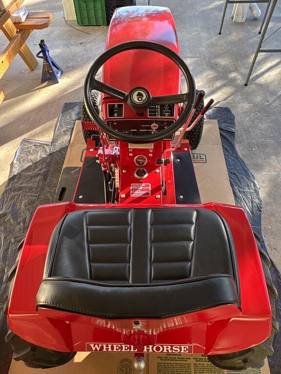

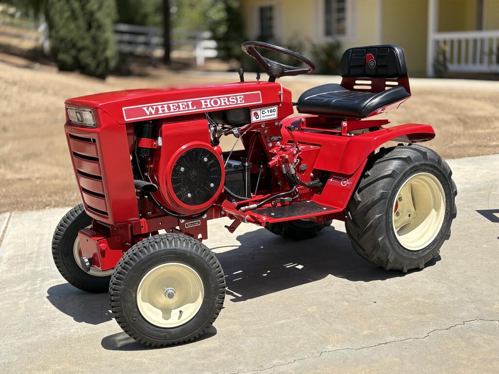

RoubaixRider 284 #98 Posted April 28 Project complete. So much fun. I figured out that it needed an 84 inch belt… It works perfectly and along with a little bit of alignment with the belt cover, it all turned out nice. Thanks for all of the help along the way guys… Appreciate it very much best, Jason. 5 Share this post Link to post Share on other sites
Razorback 1,370 #99 Posted April 28 That is BEAUTIFUL!!! 1 Share this post Link to post Share on other sites
