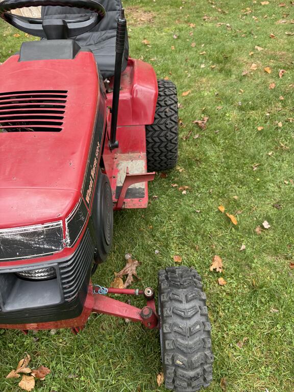

Dgilmored 7 #1 Posted December 17, 2025 I'm in the process of swapping out my front turf tires with some directional snowblower tires, with the hopes of gaining a little more traction, and I think it will look cool matching the ags in the back. I'm getting a little old to wrestle with the process so I thought I would try Pittsburgh's mini tire changer. While researching U tube for reviews I came across a tech that was very informative with how he uses the tool and the tire types as well. He spoke briefly about mounting directional tires on the front. He said he heard from some people that mounting the tires backwards improved with the steering. Does anyone have any experience with this or any thoughts. 1 Share this post Link to post Share on other sites
ebinmaine 80,714 #2 Posted December 17, 2025 28 minutes ago, Dgilmored said: mounting directional tires on the front. He said he heard from some people that mounting the tires backwards improved with the steering. Does anyone have any experience with this or any thoughts. We've experimented with this a few times here at T & E Wheelhorse Stables. To define standard rotation of the front tire, match the tread direction of the rear. The following applies only to 2WD machines. Our findings: On light weight tractors such as a stock mid 60s small block with little to no additional weight - no difference seen in snow or deep leaves. Dirt, maybe a bit better with the treads pointing "backwards." On a heavier machine such as my C160s with a front implement or added weight I found a very noticeable difference with the front AG tires "backwards/ reversed." With the front tires mounted to match the rears I had less steering and more slippage. IMHO and experience - mount them pointing opposite of the rears. 3 Share this post Link to post Share on other sites

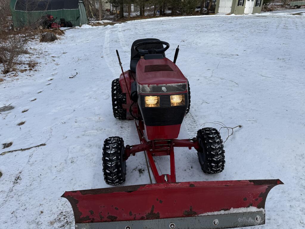

Raider69 125 #8 Posted December 29, 2025 I put these on the front of my B-100 Auto a couple years ago and so far they have not disappointed. They have handled 9" of heavy wet snow and dry fluffy stuff equally well. No additional weight, just the weight of the blade and frame. 5 Share this post Link to post Share on other sites
ebinmaine 80,714 #9 Posted December 29, 2025 20 minutes ago, Raider69 said: these Very similar to a set on one of Trina's tractors. She's been pleased as well. I've considered getting them for my snow pusher. 3 Share this post Link to post Share on other sites

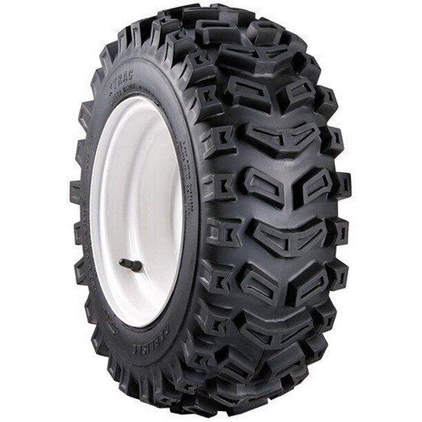

Lagersolut 802 #10 Posted December 30, 2025 8 hours ago, Raider69 said: I put these on the front of my B-100 Auto a couple years ago and so far they have not disappointed. They have handled 9" of heavy wet snow and dry fluffy stuff equally well. No additional weight, just the weight of the blade and frame. Put a set of these on the 416 - liked them so much the 315 got a set too - put a stop to the front slipping on those turf treads even in the summer wet grass - just as good in the ground as snow . 4 Share this post Link to post Share on other sites

Sparky-(Admin) 26,363 #12 Posted January 1 Yep, have these on the front of the 520-8, much improved steering in the snow! 3 Share this post Link to post Share on other sites
