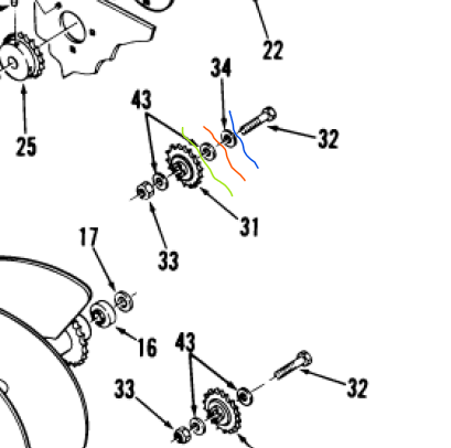

Sbaughman 0 #1 Posted December 14, 2025 Quick, and probably dumb, question: Where does the frame of the blower assembly itself fit in this diagram (Blue Line, Red Line, or Green Line) between washer (#42) and spacer (#34)? Chain jammed and I removed the pulley to clear the chain, in the process, I hadn't realized the spacer and didn't register where it was originally. The parts schematic doesn't make it idiot-proof clear where the space goes in relation to the blower side wall itself. Thanks for any help you can give! Share this post Link to post Share on other sites
Ed Kennell 46,973 #2 Posted December 14, 2025 (edited) I don't have a blower to check, but if that #34 is a lock washer, it's a gimmi that it goes under the bolt head. So blower housing would be your red line. If that sprocket is in a slot for adjustment, then it may be a flat washer and it still goes under the bolt head. Edited December 14, 2025 by Ed Kennell Share this post Link to post Share on other sites
ri702bill 12,791 #3 Posted December 14, 2025 43 minutes ago, Ed Kennell said: If that sprocket is in a slot for adjustment, Then install the shim washer(s) that give you a straight run of the chain without adding a side load to it.... 1 Share this post Link to post Share on other sites
