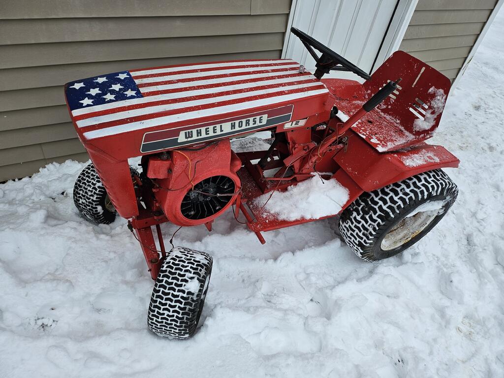

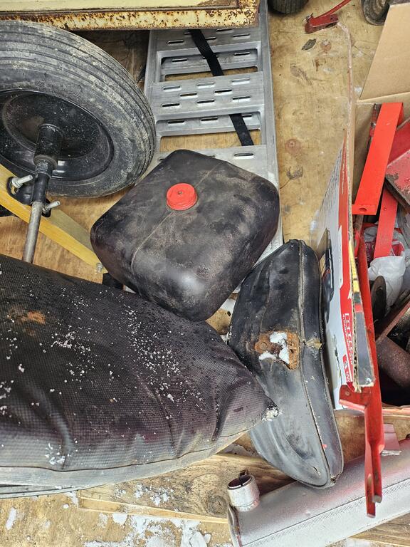

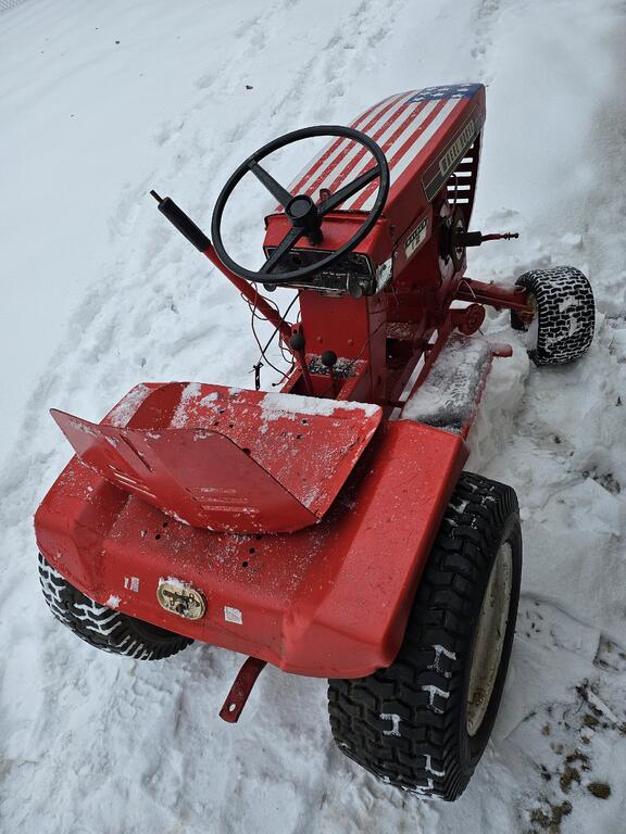

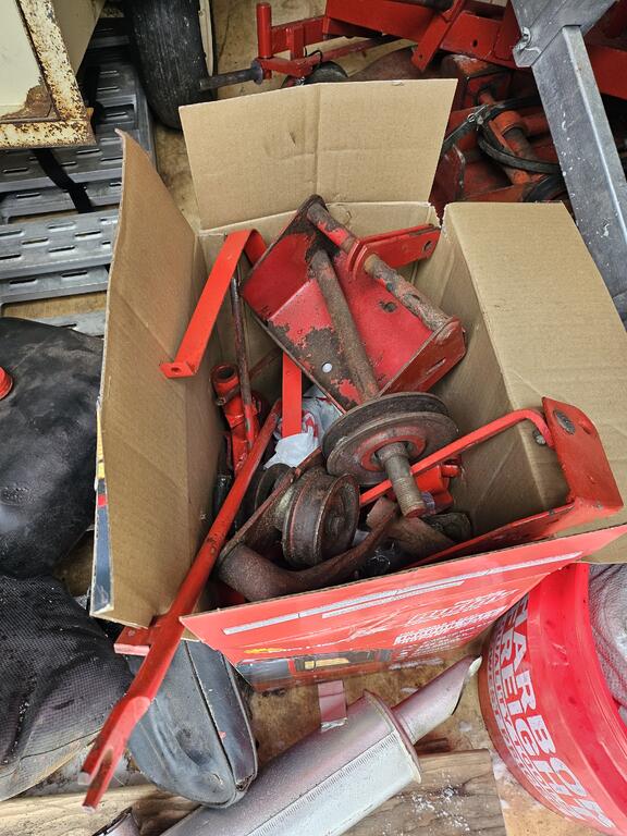

ML3 2,464 #1 Posted December 13, 2025 This showed up today unexpectedly. 12hp Raider with a box full of parts. Guy I bought Workhorse from felt bad bout motor being bad. Last week we spoke & he offered up the 12hp & 8sp if I wanted them. He said they could offset the cost of replacement engine. Thought it was a nice gesture. Shows up today with the entire tractor! 12 Share this post Link to post Share on other sites
ebinmaine 80,068 #2 Posted December 13, 2025 Got some serious potential. That should be a SIX speed which would have Limited Slip Differential. Excellent work tractor. 1 4 Share this post Link to post Share on other sites
pfrederi 20,991 #3 Posted December 13, 2025 Breakerless ignition. Be very careful not to apply any voltage to the wire on the bottom of the coil. When they work breakerless are great systems no points to wear corrode or set...and timing is always spot on. 1 3 Share this post Link to post Share on other sites

Sparky-(Admin) 26,183 #13 Posted December 13, 2025 That hand painted hood is straight up awesome! 5 Share this post Link to post Share on other sites
Troll183 37 #14 Posted December 18, 2025 (edited) Mike, This is helping you fill up that new shed. Can't have too many horses. I like that hood also, great way to show your patriotism. Edited December 18, 2025 by Troll183 3 1 Share this post Link to post Share on other sites
