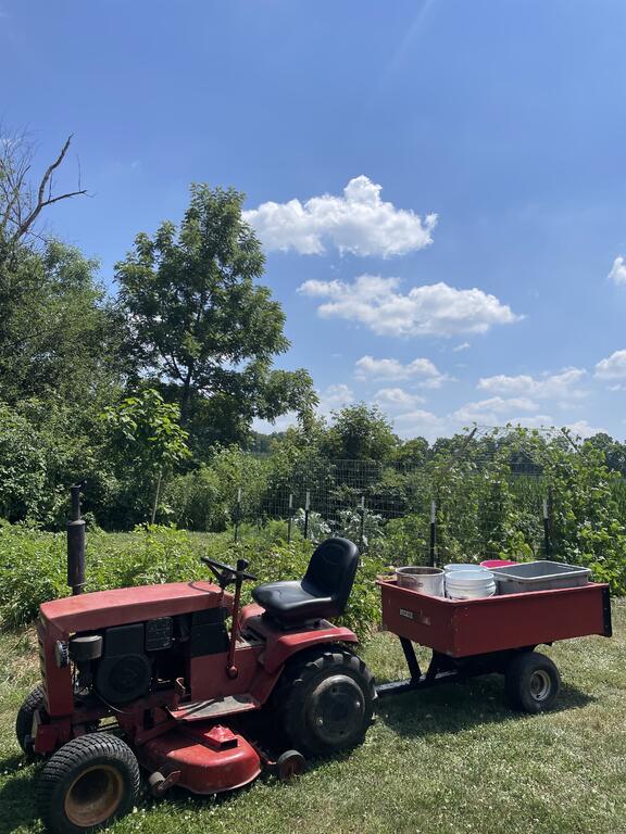

EthanL 69 #55 Posted July 3 Hauling water out of the creek to water the garden. A pump set up would be nice but I haven’t gotten there yet 2 Share this post Link to post Share on other sites

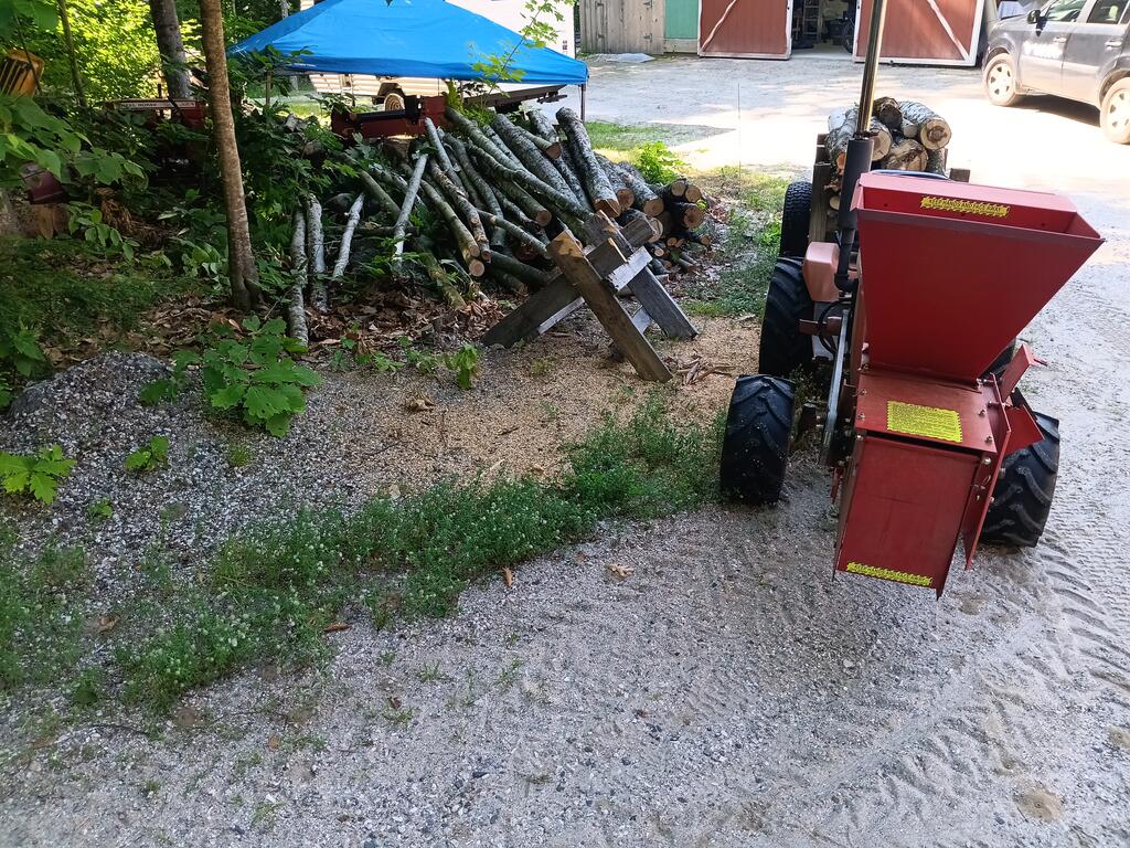

ebinmaine 81,123 #60 Posted July 5 Moving more firewood this morning. This second load was a monster. 4 1 Share this post Link to post Share on other sites

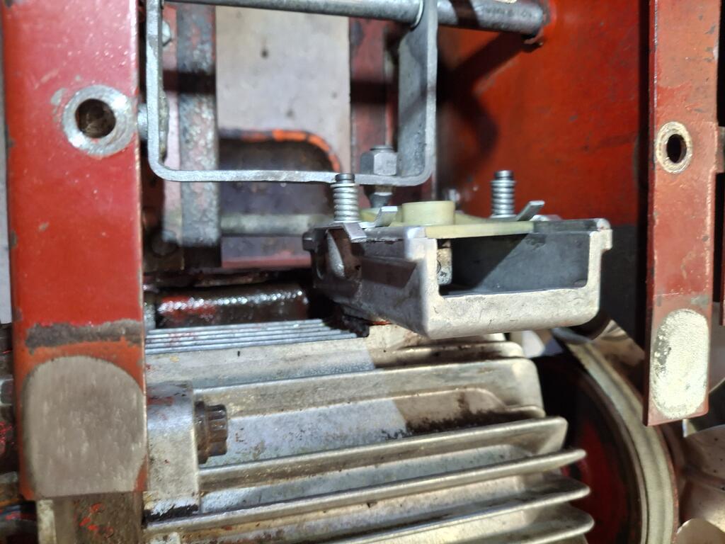

adsm08 5,243 #68 Posted July 18 I ran myself over with the 1076 this morning. Looks like I still have to do some adjusting on the motion-control tension. I was trying to investigate the loss of power with the blades engaged and the vibration of the tractor while running is enough to knock it into gear. 1 Share this post Link to post Share on other sites

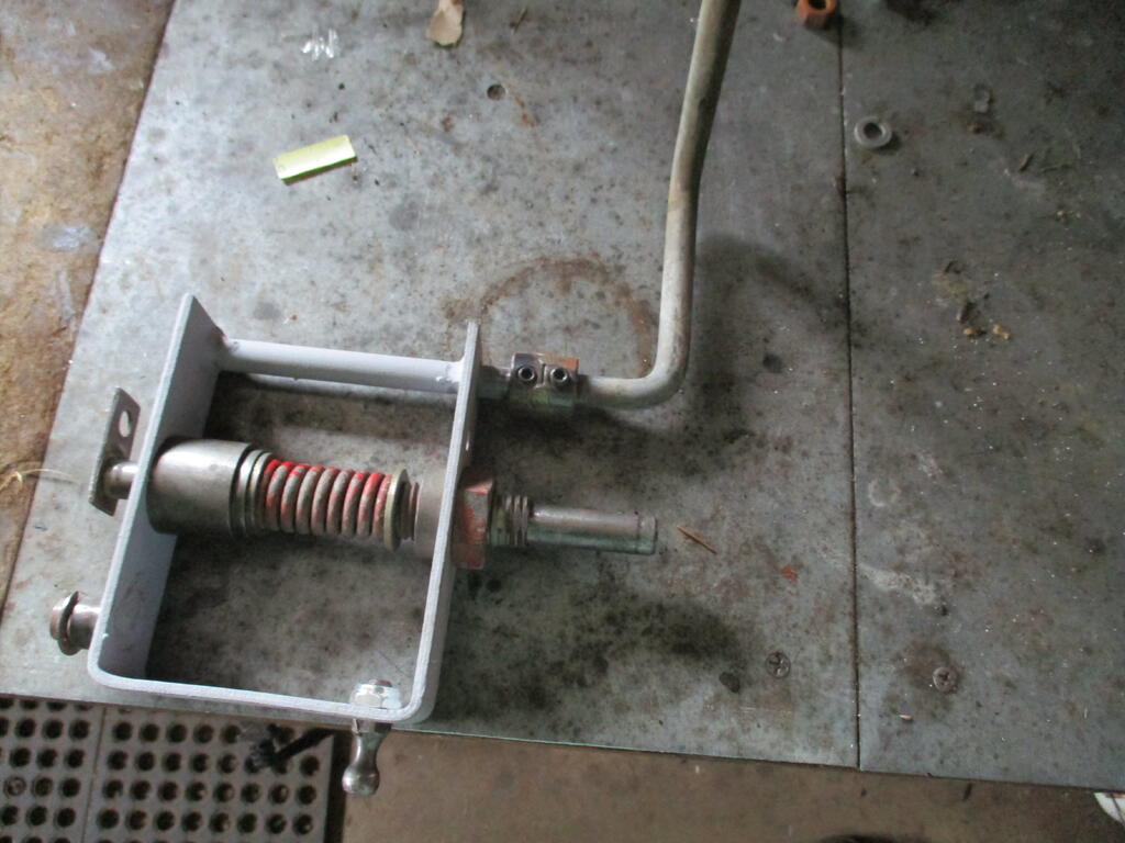

pfrederi 21,292 #69 Posted July 18 41 minutes ago, adsm08 said: I ran myself over with the 1076 this morning. Looks like I still have to do some adjusting on the motion-control tension. I was trying to investigate the loss of power with the blades engaged and the vibration of the tractor while running is enough to knock it into gear. The motion control on Wheelamatics is anemic at best relying on two little springs to hold tension on the placstic plate. Here is something I am setting up to put on my neighbors 1075 or my 875. You need to get the motion control with the big cross spring from any later hydro gear or piston to piston sunstrand. It will fit right in the only glitch is the later one had different bend in the control lever. So I cut off the one from the late model and am grafting on a cut off from the older style. Shaft collars and set screws are temp until I check the alignment . 3 2 Share this post Link to post Share on other sites
adsm08 5,243 #70 Posted July 18 25 minutes ago, pfrederi said: The motion control on Wheelamatics is anemic at best relying on two little springs to hold tension on the placstic plate. Here is something I am setting up to put on my neighbors 1075 or my 875. You need to get the motion control with the big cross spring from any later hydro gear or piston to piston sunstrand. It will fit right in the only glitch is the later one had different bend in the control lever. So I cut off the one from the late model and am grafting on a cut off from the older style. Shaft collars and set screws are temp until I check the alignment . Paul, I do believe I have one of those sitting around, courtesy of some feller I met at the Show. My eventual plan is to attempt to rebuild the one I got from you and put it in this tractor. They look very similar externally. 1 Share this post Link to post Share on other sites

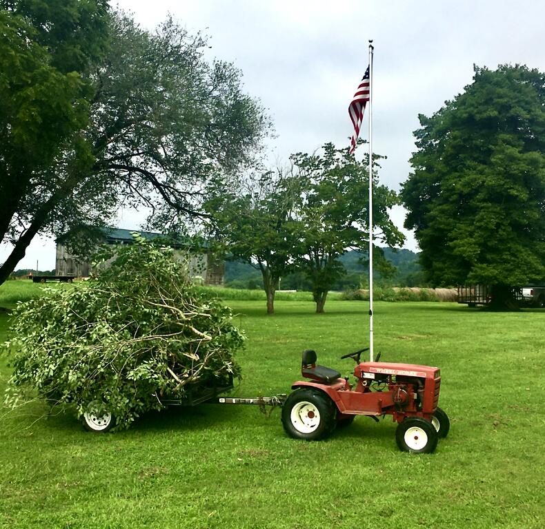

sqrlgtr 4,172 #71 Posted July 23 (edited) Little tree trimming/brush hauling with the C-160. At least I can get under tree with Truck and load of hay now . It dont take long to have a yard full of brush when u get to cutting with the pole saw. Edited July 23 by sqrlgtr 1 Share this post Link to post Share on other sites

squonk 48,319 #74 Posted July 24 (edited) On 7/18/2026 at 1:46 PM, pfrederi said: The motion control on Wheelamatics is anemic at best relying on two little springs to hold tension on the placstic plate. Here is something I am setting up to put on my neighbors 1075 or my 875. You need to get the motion control with the big cross spring from any later hydro gear or piston to piston sunstrand. It will fit right in the only glitch is the later one had different bend in the control lever. So I cut off the one from the late model and am grafting on a cut off from the older style. Shaft collars and set screws are temp until I check the alignment . You can get more tension on the std Wheel a Matics by replacing the 2 slot head screws with longer allen head screws with a couple of washers. You can it tighter with an allen wrench as opposed to a slot head screw . I did this a year ago and it's still tight. Edited July 24 by squonk 5 Share this post Link to post Share on other sites
Bar Nuthin 3,514 #75 Posted July 24 On 7/18/2026 at 1:46 PM, pfrederi said: The motion control on Wheelamatics is anemic at best relying on two little springs to hold tension on the placstic plate. Here is something I am setting up to put on my neighbors 1075 or my 875. You need to get the motion control with the big cross spring from any later hydro gear or piston to piston sunstrand. It will fit right in the only glitch is the later one had different bend in the control lever. So I cut off the one from the late model and am grafting on a cut off from the older style. Shaft collars and set screws are temp until I check the alignment . Thank you for posting this photo! I found a small e-clip on the garage floor and have spent the last week trying to figure out where it belonged. I've done so many different projects over the past few weeks, I forgot about having my motion control apart on my C-120. Share this post Link to post Share on other sites
