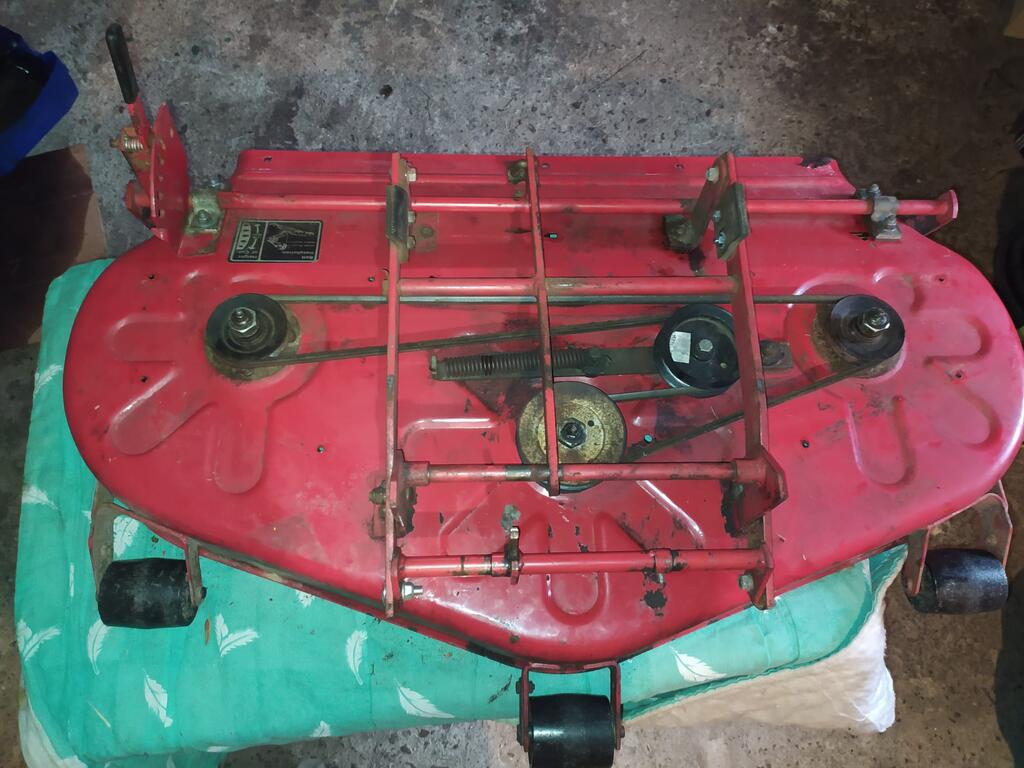

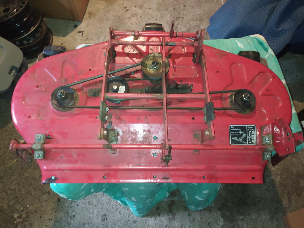

Stan50 231 #1 Posted December 9, 2025 Hi guys, orginal post about my 1985 312-8 https://www.wheelhorseforum.com/topic/113950-312-8-1985/ I do research about my 42" rear discharge deck and I found a lot of data here, I am very grateful for it all. I downloaded some files, I'm not sure but looks like my deck is 05-42MR03 - 42", unfortunately I don't have any serial # on deck. Are there many differences between similar models? I removed deck rear wheels Share this post Link to post Share on other sites
gwest_ca-(File Mod) 12,488 #2 Posted December 9, 2025 Some of the observed differences Mower DNA 42" rear discharge 1976 model 65-42MR01 replaced by - (Has the flat spindle belt idler pulley mounted on a triangular plate.) - (Has multi-link hardware at the gauge wheel support) 1977 model 75-42MR01 - Both use blades with 5/8" x 3/4" double-D center hole unless the spindles have been upgraded. (Has the flat spindle belt idler pulley mounted on a triangular plate) - (Has multi-link hardware at the gauge wheel support) ---------------------------------------------------------------------------------------------------------------------------------------------------------------------------------------------------------------------------------------------------------------- These all use blades with 3/4" center hole. 1977 model 75-42MR02 replaced by - (Has the flat spindle belt idler pulley mounted on a flat bar) (Has multi-link hardware at the gauge wheel support) 1978 model 85-42MR01 - (Has the flat spindle belt idler pulley mounted on a flat bar) (Has multi-link hardware at the gauge wheel support) 1979 model 95-42MR01 - Shares an illustrated parts list with 85-42MR01 - (Has the flat spindle belt idler pulley mounted on a flat bar) (Has multi-link hardware at the gauge wheel support) 1979 model 95-42MR02 - (Has no multi-link hardware at the gauge wheel support) 1980-1983 model 05-42MR01 1984 model 05-42MR02 - Last year for bearings with 3/4" ID 1985 model 05-42MR03 - First year for bearings with 17mm ID unless older spindles were updated. 1986-1988 model 05-42MR04 1989-1990 model 15-42RC01 1990-1992 model 15-42RC02 1993-2012 model 78350 Note - 17mm is .669" With each file description page are thumbnails showing the spindle assemblies used - the original and any that replaced the originals. Compare them to what you have and all three may be different if a replacement has taken place. 1 2 Share this post Link to post Share on other sites
