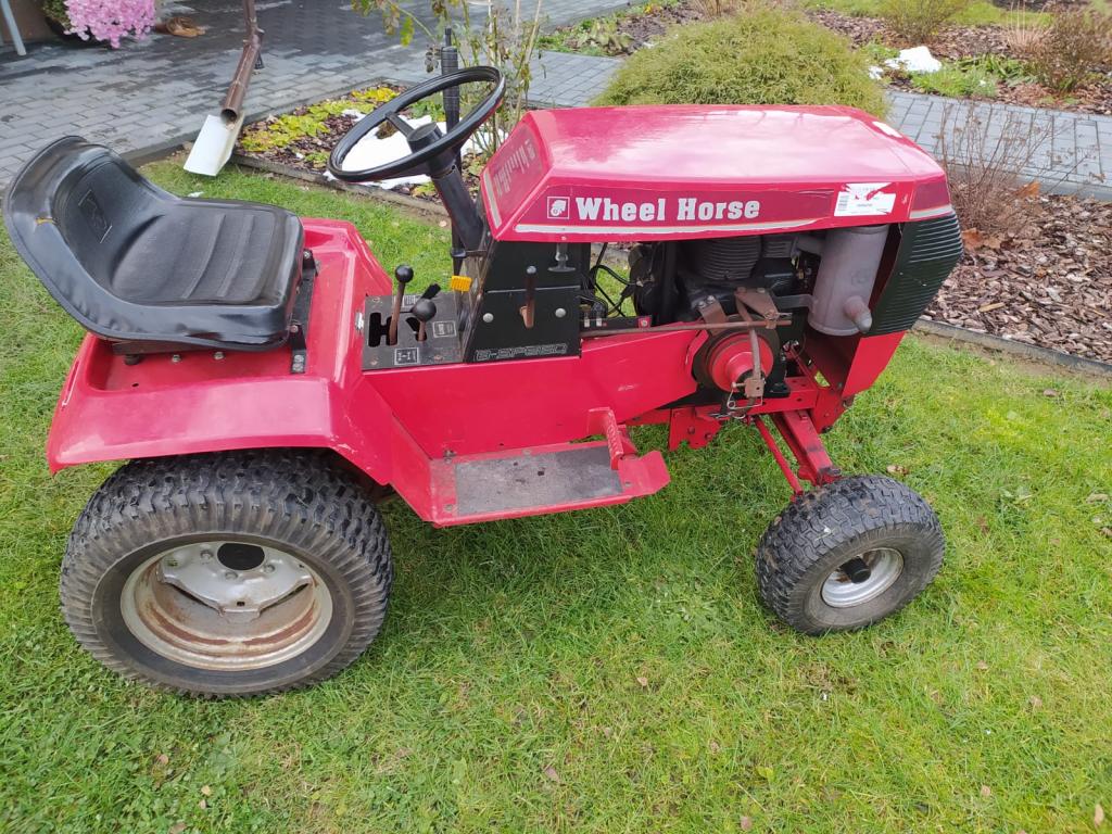

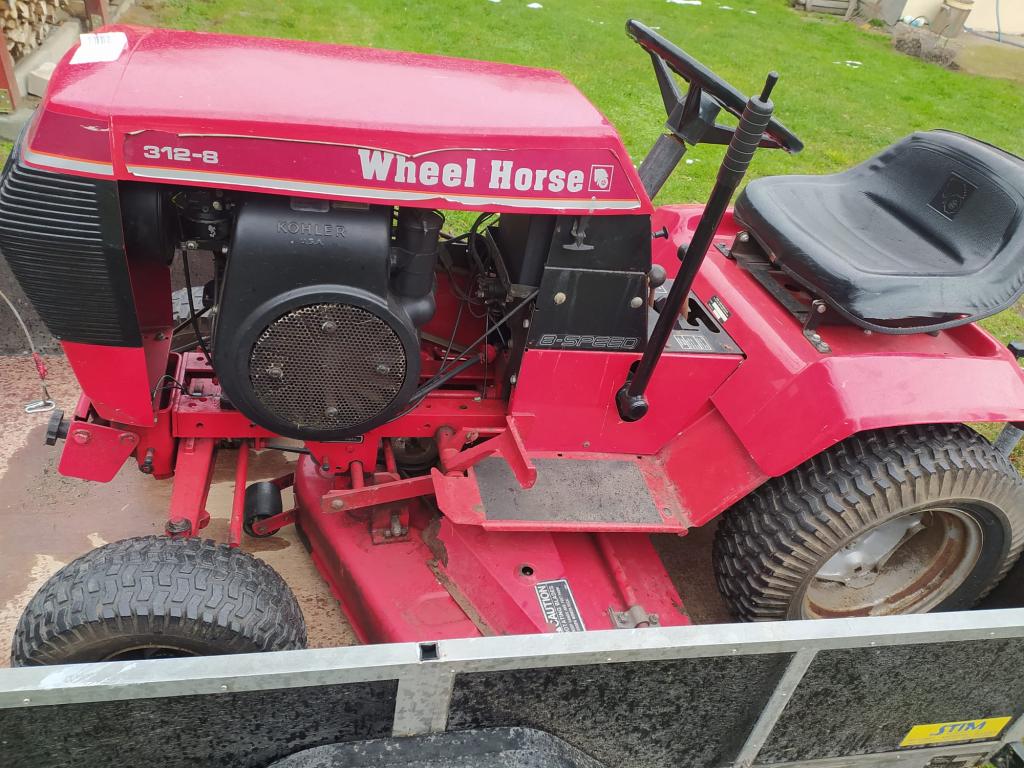

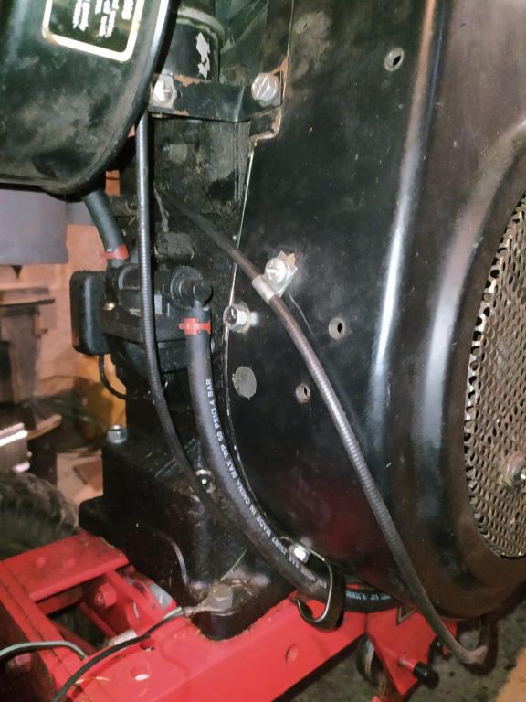

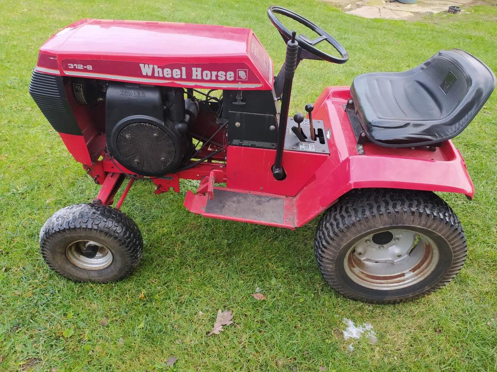

Stan50 257 #1 Posted November 30, 2025 Hi guys, My WH 312-8 finally arrived . I changed engine oil (Mobil 10W-30), transmission fluid in the works, NGK B6L spark plug, air filter. All belts looks decent ,tires keep air. Throttle cable looks too long, but I'll manage something. I have couple questions: when in the idle, trans belt keep running? Does fuel gauge show gas level accurately? I'm just begginer, I 've never seen Wheel Horse before but I saw them on YouTube and just found one on Marketplace. Few months later little tractor is in my possesion and his crudiness and appealing look is better than I imagined. I started engine right away but battery did need recharge (looks new) More questions in the way, but looks like tractor is complete and ready for work,just some TLC needed. 4 7 Share this post Link to post Share on other sites

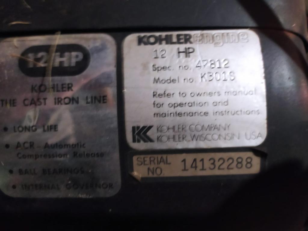

midpack 1,148 #2 Posted November 30, 2025 I have one just like it with the Kohler motor. Very versatile and good on gas too! 5 Share this post Link to post Share on other sites

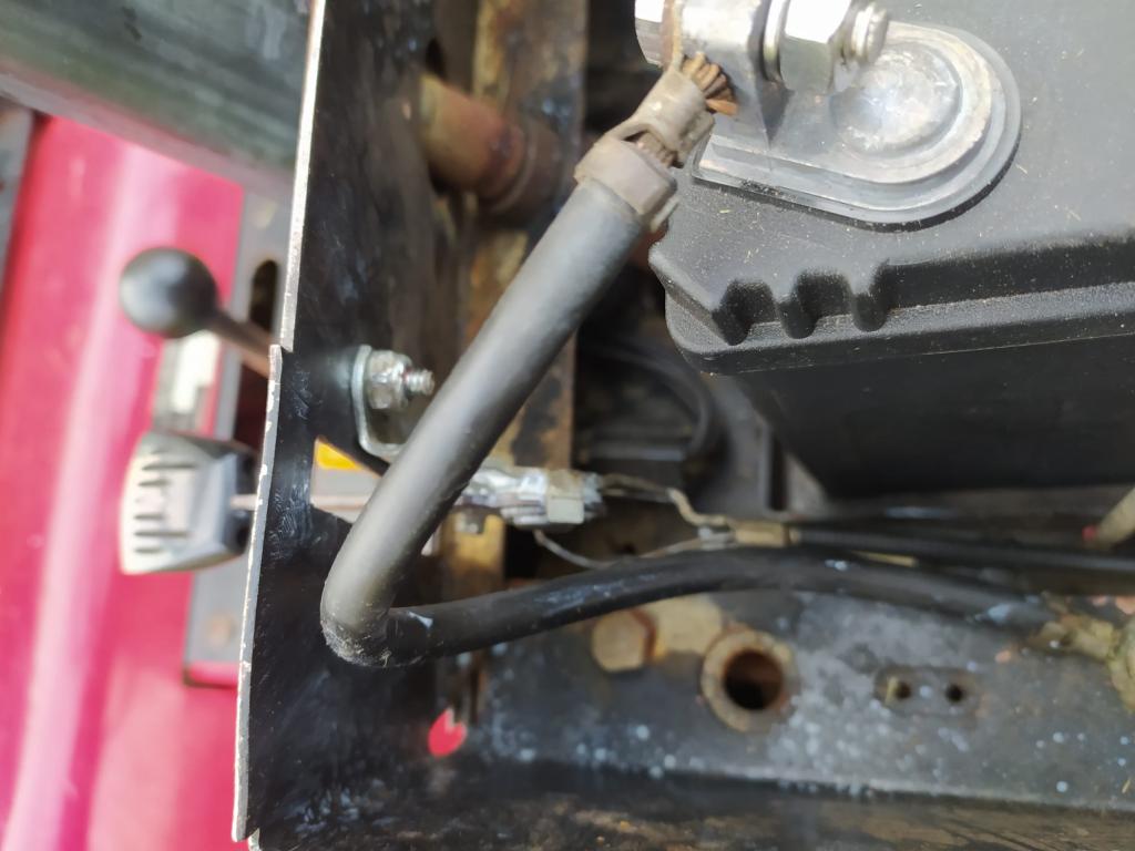

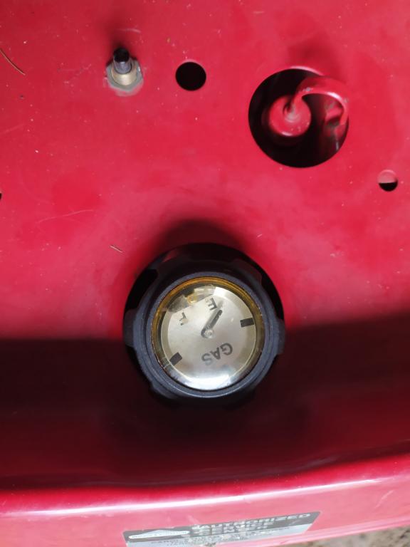

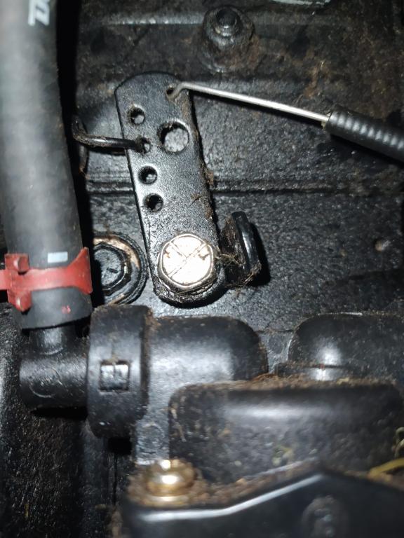

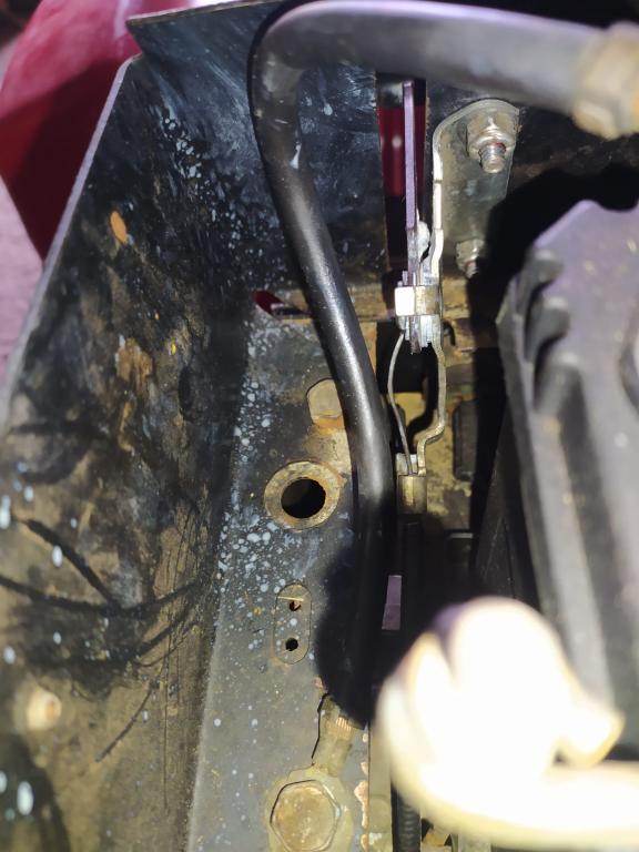

ebinmaine 81,281 #3 Posted November 30, 2025 43 minutes ago, Stan50 said: Throttle cable looks too long, but I'll manage something. Many do. Its necessary to keep an arc for proper operation. Any pics of the cable? 43 minutes ago, Stan50 said: I have couple questions: when in the idle, trans belt keep running? With the clutch pedal up (no foot pressure on it) this is normal. ALWAYS put the clutch pedal allthe way down before shifting and NEVER EVER shift while in motion. Choose a gear and stay in it until you stop. 43 minutes ago, Stan50 said: Does fuel gauge show gas level accurately? Pics of the guage? 4 1 Share this post Link to post Share on other sites
Bill D 3,213 #4 Posted November 30, 2025 Welcome! Looks like a nice low hour machine. Throttle cable routing looks normal to me. There's a checklist thread on here for newly acquired machines. Check it out. Transmission oil is 90W gear lube. Mobil 1 10W-30 is what I use for my engines. If you have any questions be sure to ask. Lots of knowledge here. That's a great worker that will last for a lifetime. 3 Share this post Link to post Share on other sites

953 nut 70,649 #6 Posted November 30, 2025 The 312-8 is a great machine. Powerful enough to get the job done but doesn't use too much fuel. 2 Share this post Link to post Share on other sites

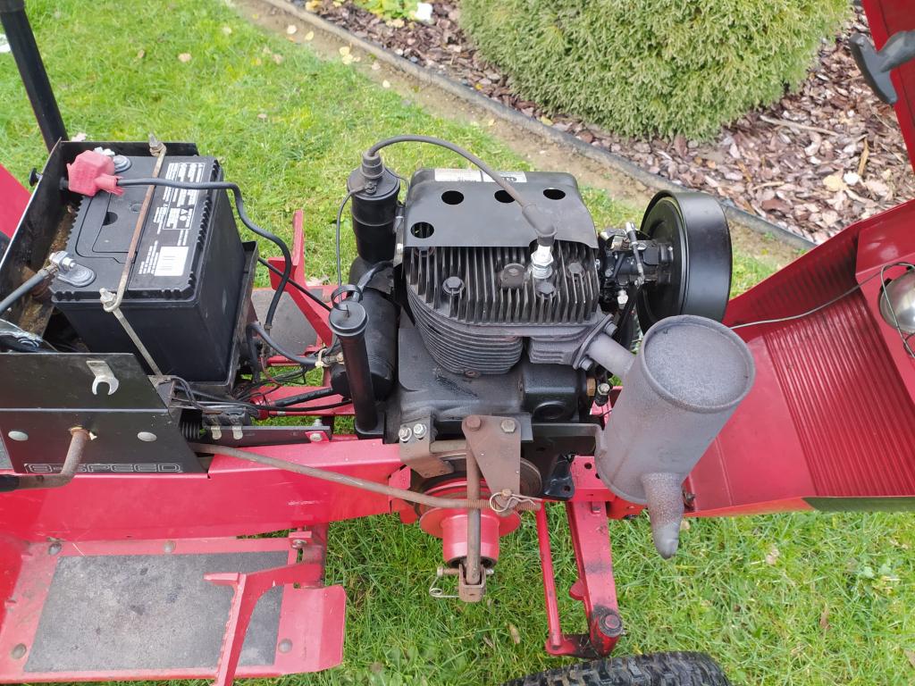

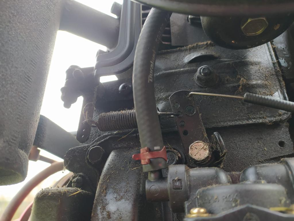

Stan50 257 #7 Posted November 30, 2025 Quote Pics of the guage? Any pics of the cable? Hope that pics are accurate One more pic is that trottle cable hook up correctly? 1 1 Share this post Link to post Share on other sites

Bill D 3,213 #9 Posted November 30, 2025 Throttle cable looks fine to me. They were always a little on the long side. 1 Share this post Link to post Share on other sites

ri702bill 13,392 #11 Posted November 30, 2025 Welcome! 10W30 all year should be just fine. Gas Gauge - Remove the cap from the tank - inside the cap there is a metal spiral track. Sometimes, that metal gets rusty and impedes the vertical movement of the float. Move the float up and down the track & watch the gauge - it should follow the movement as the float twists the inner spiral. Two more - the float or mechanism are damaged or missing. The float is fuel logged and does not float. If so for both, replace the assembly. 3 Share this post Link to post Share on other sites

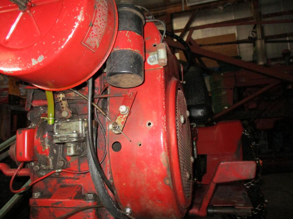

pfrederi 21,342 #14 Posted November 30, 2025 The throttle cable is not hooked up correctly.. you may be missing a couple parts. The cable works on a bell crank which has a solid shaft that goes to the governor linkage. However given how hard it is to get parts in Poland if it works..live with it... Share this post Link to post Share on other sites
Stan50 257 #15 Posted November 30, 2025 (edited) Looks like different setup to me, trottle cable is connected by one solid screw to the left side of flywheel cover? I will look forward to it... Edited November 30, 2025 by Stan50 1 Share this post Link to post Share on other sites
Stan50 257 #16 Posted November 30, 2025 Throttle works properly but yes, I definitely look forward to it Share this post Link to post Share on other sites
peter lena 10,125 #17 Posted November 30, 2025 @Stan50 like a lite hydraulic oil , iNSIDE those cables and related linkage movement points , have a brand called SUPER LUBE , incredible temp range , add at elevated areas for easier run down . unit looks good , shows upkeep and coverage , maintain that , aside from the seat , easily replaced , by duplicating seat 4 bolt measurements , your choice low or hi backed , would personally , get some mineral oil on that paint rub it down with a clean cloth , let it sit without any scratching or rough cleaning . at least a week , then clean oiled cloth for rub in look . just the depth of all that paint , that thing will pop with clean shinny paint . that black engine paint will look new , get the trans oil changed , oil color on stick will tell what's there , you want clean oil or darkened oil , not milky , indicating moisture , maybe a new shift boot . make sur that gas tank cap has a vent hole , if blocked can cause fuel starvation. good luck with it , pete 1 Share this post Link to post Share on other sites

Bill D 3,213 #19 Posted November 30, 2025 (edited) 6 hours ago, Stan50 said: Throttle works properly but yes, I definitely look forward to it That linkage is fine as is. The throttle cable connections on a 300 series are a little different then the older C1xx tractors. Either way if it works, run with it. Edited November 30, 2025 by Bill D 3 Share this post Link to post Share on other sites
pfrederi 21,342 #20 Posted November 30, 2025 1 hour ago, Bill D said: That linkage is fine as is. The throttle cable connections on a 300 series are a little different then the older C1xx tractors. Either way if it works, run with it. Great catch...my stuff is all older wonder why the change??? 1 Share this post Link to post Share on other sites
Ed Kennell 47,942 #21 Posted November 30, 2025 30 minutes ago, pfrederi said: wonder why the change??? The bean counters probably figured a longer throttle cable was cheaper than the bell crank. 2 Share this post Link to post Share on other sites

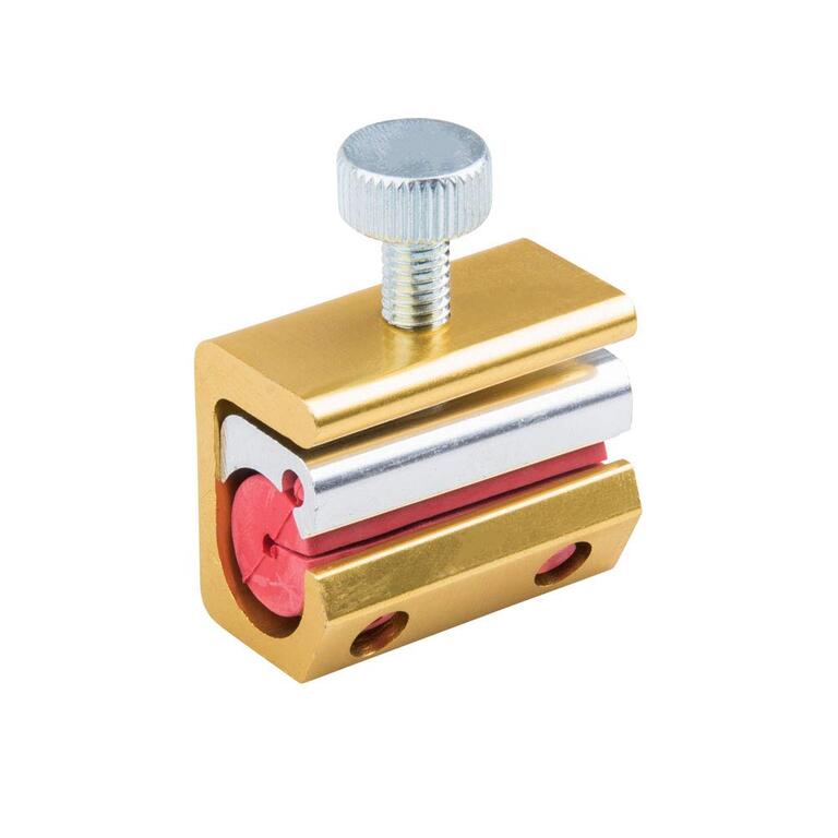

Retired Wrencher 7,043 #22 Posted December 1, 2025 15 hours ago, Stan50 said: Noted. Thank you for advice . These work great for lubing cables.I have had one for about 20 years now. 1 1 Share this post Link to post Share on other sites
Stan50 257 #23 Posted December 1, 2025 (edited) Thank you,any advice appreciated, I'm going to find above item. Throttle setup is little stiff, so I will do proper maintenance. For now I changed fluids, air filter (was available here online), grease couple zirks in the front. In the rear I can see potential spots to grease too . Definitely I'm going to gather up some parts, not readily avaiable in my country, such as belts, maybe other small things, just to have them at hand. Edited December 1, 2025 by Stan50 3 Share this post Link to post Share on other sites
oliver2-44 11,847 #24 Posted December 2, 2025 Your going to engoy that 312-8. I cleaned this one up for my son , it is a great worker. 3 2 Share this post Link to post Share on other sites

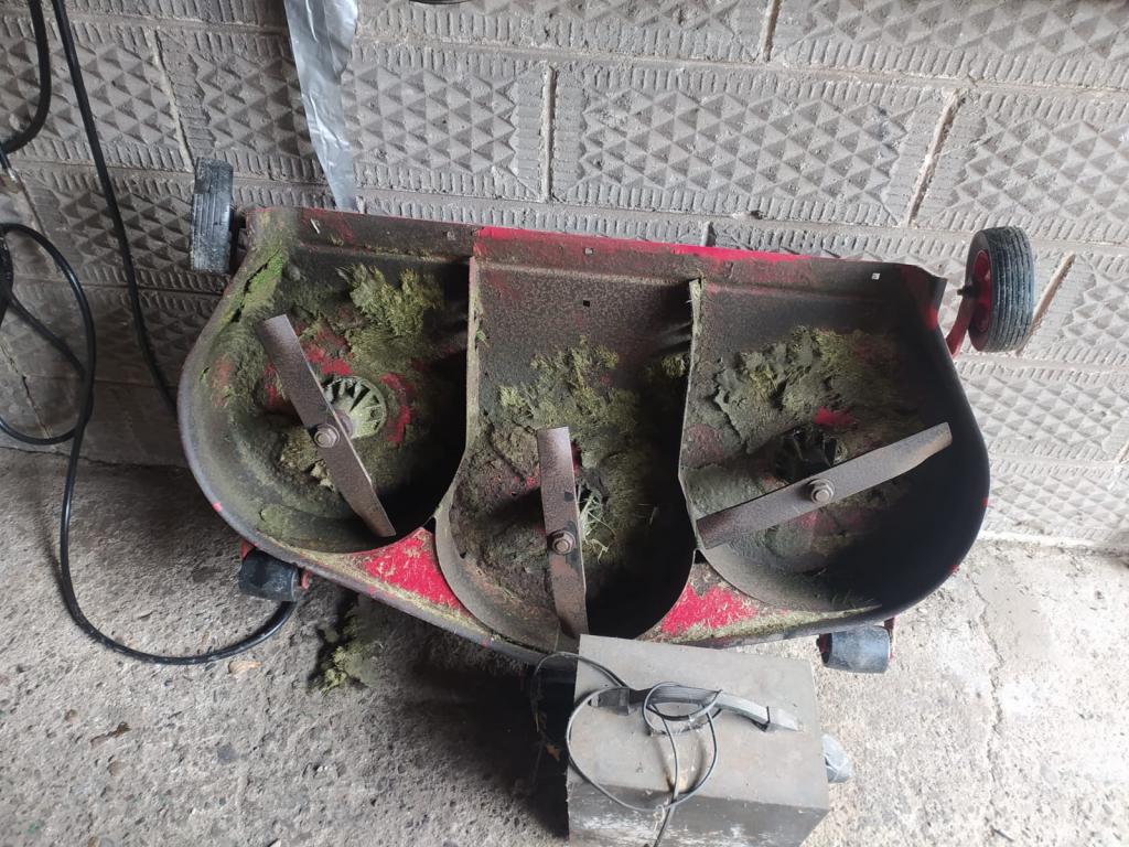

Stan50 257 #25 Posted December 2, 2025 You're right! This little tractor is built like a tank, everybody is surprised that red beast is 40 years old, It is like Christmas time to me . Actually I checked and thoroughly cleaned/greased the deck- deck is complete, except just one small bolt sleeve/spacer in the lift assembly, but this is not real problem. 3 Share this post Link to post Share on other sites
