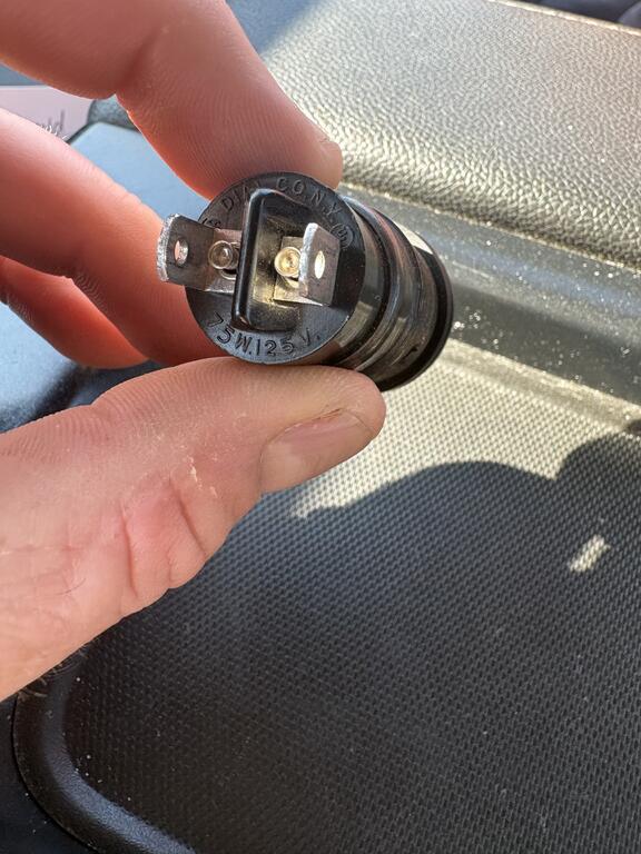

Tonytoro416 1,387 #1 Posted December 8, 2025 I have a nos tail light for my 953 but am confused on what bulb I need. And now second guessing myself on how to wire it. Help plz Share this post Link to post Share on other sites
WHX?? 58,138 #2 Posted December 9, 2025 It's a small base bayonet not sure of the number ... too cold to go out and look ... ...others will be along. For wiring just goes to the headlight switch and ground. If it's like the originals make sure the lens is on securely. May even a dab of silicone if it even feels like it might fall off. Dang near lost mine in the plow field so now just leave it off for fear of that. Tractor 1963 953 Wiring Rev.pdf 2 Share this post Link to post Share on other sites
Tonytoro416 1,387 #3 Posted December 9, 2025 So it need a ground coming off one of the spades on the back of tail light ? It’s not grounded through mounting Share this post Link to post Share on other sites

WHX?? 58,138 #6 Posted December 9, 2025 (edited) Pic of it Tony? if i's only got one wire then most likely grounded through mount. Guessing a NOS one might be as rare as the brass RJ stop button. I'll go out and look to see what bulb is in mine today. Edited December 9, 2025 by WHX?? 1 Share this post Link to post Share on other sites
Tonytoro416 1,387 #7 Posted December 9, 2025 Takes a double contact 1156 style base but the bulb has to be smaller 1 Share this post Link to post Share on other sites

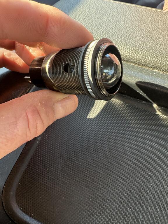

Tonytoro416 1,387 #8 Posted December 9, 2025 Here I have a mini bulb in it and was barely able to twist bulb to secure it in socket. May work as long as the light projects out of the lense out 2 Share this post Link to post Share on other sites
Tonytoro416 1,387 #9 Posted December 9, 2025 The 67 bulb is physically too small. The bulb in it is a 1004 I think. Long narrow bulb and still almost not long enough 1 Share this post Link to post Share on other sites
squonk 48,125 #10 Posted December 9, 2025 (edited) 5 hours ago, Tonytoro416 said: Takes a double contact 1156 style base but the bulb has to be smaller 1004 is too short? How long do you want it? It's just a tail light. Get it too close to the lens and it may melt it Edited December 9, 2025 by squonk 1 Share this post Link to post Share on other sites
squonk 48,125 #11 Posted December 9, 2025 5 hours ago, Tonytoro416 said: Here I have a mini bulb in it and was barely able to twist bulb to secure it in socket. May work as long as the light projects out of the lense out We have some motor control indicator lamps at work the same way. PITA to install and remove but they are the proper lamp 1 Share this post Link to post Share on other sites
Tonytoro416 1,387 #12 Posted December 9, 2025 67 is too short Share this post Link to post Share on other sites
Tonytoro416 1,387 #13 Posted December 9, 2025 What I got will work I believe 1 Share this post Link to post Share on other sites
Tonytoro416 1,387 #14 Posted December 10, 2025 3 hours ago, squonk said: 1004 is too short? How long do you want it? It's just a tail light. Get it too close to the lens and it may melt it The 68 bulb would be too small that you wouldn’t be able to get ahold of it to twist it into position. The 1004 bulb I had to use masking tape on so I could get it twisted in 1 Share this post Link to post Share on other sites
