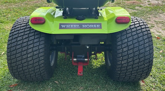

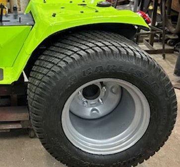

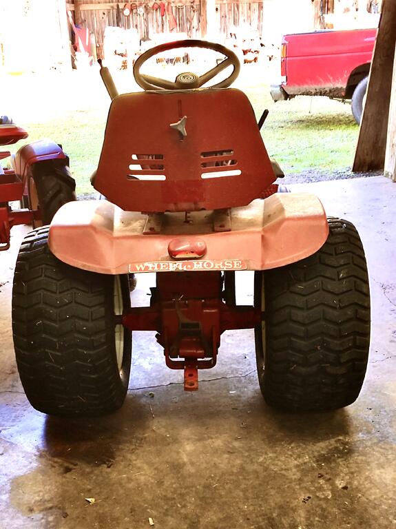

ebinmaine 77,244 #2 Posted December 7, 2025 Check out this post from my 1974 C160-8 Tecumseh engine tractor... 1 1 Share this post Link to post Share on other sites
sqrlgtr 2,129 #3 Posted December 7, 2025 @ebinmaine those tires are one set that I thought about getting. Did you have to use wheel spacers, and did you have to do anything to the fenders? The tires that are on the rims right now are some kind of turf tires but they look big but I've never had any 24-12"s before . They seem to hold air and I will probably try to run them for a while at least until Santa Clause gets paid... BTW yours look great and a C-160 is a tractor that I really wanted to put them on. I have a 1257 that came from @WHX?? that has a set like you have pictured but maybe a different name on side and they are 23-850"s but are a big 8.50... If I missed info in thread blame Andy Griffith he's on tv at moment. 3 Share this post Link to post Share on other sites
ebinmaine 77,244 #4 Posted December 7, 2025 18 minutes ago, sqrlgtr said: those tires are one set that I thought about getting. I got these because they're a good full measurement of the advertised/marked tire size. 18 minutes ago, sqrlgtr said: Did you have to use wheel spacers, and did you have to do anything to the fenders? Definitely nothing to the fender. I believe there are spacers in there but I don't recall thickness. I prefer the extra width for the extra stability. Do you NEED spacers? Maybe not considering the backspacing is good. 2 1 Share this post Link to post Share on other sites
sqrlgtr 2,129 #5 Posted December 7, 2025 (edited) I got some spacers and was just wondering. Really like the look and would welcome the extra stability for these hills around here... glad to hear about nothing done to fender... Edited December 7, 2025 by sqrlgtr 2 1 Share this post Link to post Share on other sites
ebinmaine 77,244 #6 Posted December 7, 2025 9 minutes ago, sqrlgtr said: I got some spacers and was just wondering. Really like the look and would welcome the extra stability for these hills around here... glad to hear about nothing done to fender... I have two more sets of these wide 520H wheels. Likely I'll duplicate the exact setup on other tractors. 2 1 Share this post Link to post Share on other sites

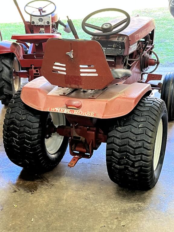

sqrlgtr 2,129 #16 Posted December 11, 2025 Finally got a chance to swap the 24-12-12 to the C160 today. Had plenty of room and wheel back space was perfect for tractor, no spacers needed didnt even come close to hitting anything . The tires hold air but I want to get some loaded ag/tractor tread tires to go on it Probably will be after Santa Claus has time to recoup from spreading cheer everywhere though. 4 Share this post Link to post Share on other sites
ebinmaine 77,244 #17 Posted December 11, 2025 Meeeeaaaat 1 Share this post Link to post Share on other sites
sqrlgtr 2,129 #18 Posted December 11, 2025 These came off of an older craftsman mower and it must be alot narrower than Wheel Horses because I thought they had alot more backspace then they did…. Share this post Link to post Share on other sites
