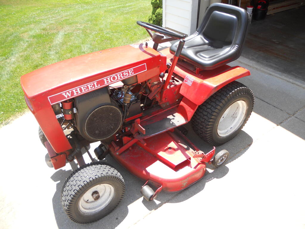

kpinnc 19,107 #2 Posted December 7, 2025 (edited) If the old and new engine have the same ignition type, and the 12HP has the correct oil pan, the swap itself is easy. You will likely need a new drive pulley (1.125 ID) and the associated PTO bearing race. If the 12hp has any oil pan other than what is in the pic below, you'll have some degree of fabrication to do. Even if it is of this type, if it didn't come from a Wheel Horse you'll have to drill and tap the PTO side bolt holes or use J bolts. Many of us have repowered these old tractors so it isn't impossible no matter what fits if you want to swap it. Just makes it easier if you start with the right stuff. Edited December 7, 2025 by kpinnc 3 1 Share this post Link to post Share on other sites

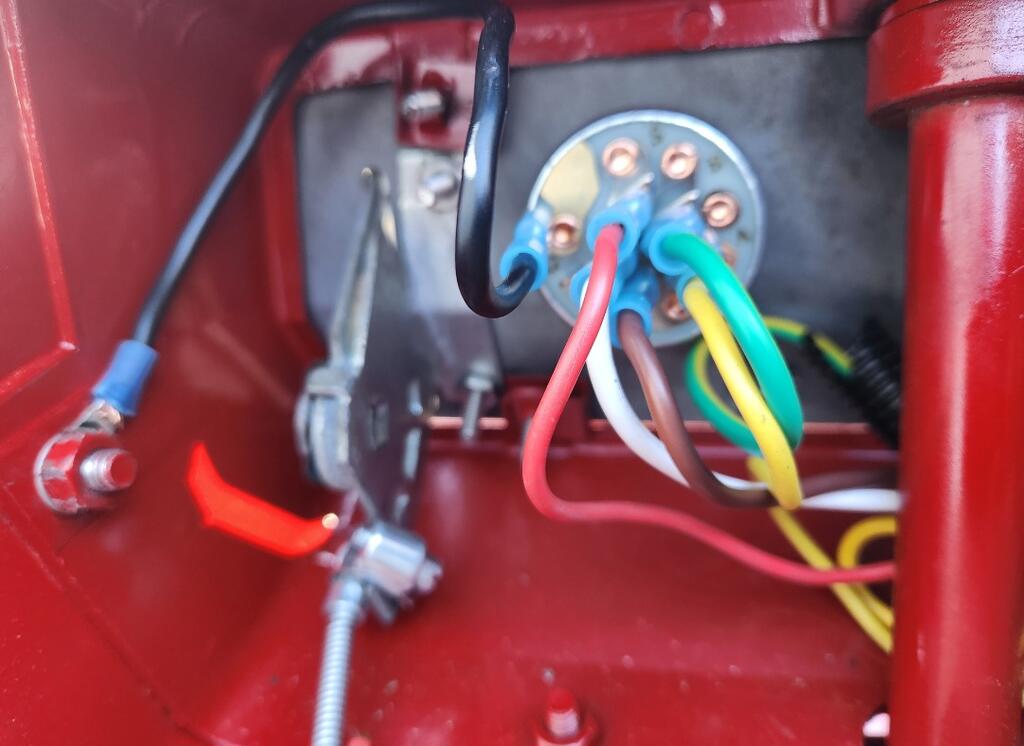

midpack 1,148 #6 Posted December 7, 2025 59 minutes ago, ri702bill said: The B80 had a battery ignition, if you are planning on using a Magnum engine, that has magneto ignition. Doing so requires the correct mag style ignition switch and a bit of re-wiring... I replaced a Kohler with a Magnum and used the original ignition switch and wiring. I had to add a relay, I found the info on how to do the modification on this site. Much easier than changing the wiring and switch. I did one like that too. 2 2 Share this post Link to post Share on other sites

ri702bill 13,393 #8 Posted December 7, 2025 3 hours ago, midpack said: and used the original ignition switch and wiring. I had to add a relay, I found the info on how to do the modification on this site. I take it that the secondary circuit of the relay was the engine kill ground wire?? Share this post Link to post Share on other sites
Goldnboy 1,156 #9 Posted December 7, 2025 (edited) I installed a Magnum in and the wiring is not all that difficult except the that you need to know the correct wire from the engine "M" needs connected to a different key switch for a magnum engine. You may need to enlarge the hole on the dash to accommodate the key switch as that hole varies by mfg. Plus you need to run ground to key switch. Edited December 7, 2025 by Goldnboy 3 Share this post Link to post Share on other sites

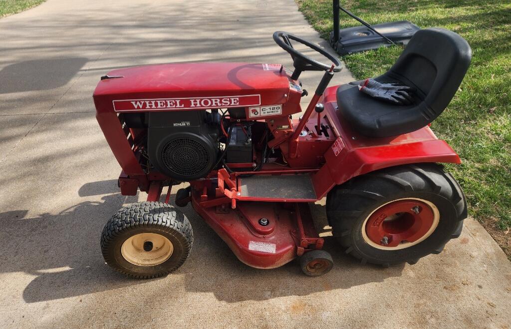

ri702bill 13,393 #10 Posted December 7, 2025 As she sits now.... dressed for the Winter Dance! Share this post Link to post Share on other sites
ri702bill 13,393 #11 Posted December 7, 2025 6 hours ago, midpack said: I had to add a relay, I found the info on how to do the modification on this site. Do you still have that info?? Curious to see the circuitry, particularly to understand the duty cycle. One that has a 100% duty cycle is always on, unlike a starter solenoid. Always energized can shorten its life... 1 Share this post Link to post Share on other sites
midpack 1,148 #12 Posted December 8, 2025 18 hours ago, ri702bill said: Do you still have that info?? Curious to see the circuitry, particularly to understand the duty cycle. One that has a 100% duty cycle is always on, unlike a starter solenoid. Always energized can shorten its life... I'm not sure how to copy the link but if you search Magnum wiring you'll find the info. It shows up about 4-5 posts down the list. I have no idea about the duty cycle but mine's been like that for over 5 years so I'm guessing it's ok 1 Share this post Link to post Share on other sites
ri702bill 13,393 #13 Posted December 8, 2025 1 hour ago, midpack said: I have no idea about the duty cycle but mine's been like that for over 5 years so I'm guessing it's ok Good. Car relays, like for the electric fuel pump, have a 100% duty cycle and they do just fine.... Share this post Link to post Share on other sites
953 nut 70,653 #14 Posted December 10, 2025 On 12/7/2025 at 1:19 PM, ri702bill said: Do you still have that info?? Curious to see the circuitry, particularly to understand the duty cycle. One that has a 100% duty cycle is always on, unlike a starter solenoid. Always energized can shorten its life... Here ya' go. 1 Share this post Link to post Share on other sites
