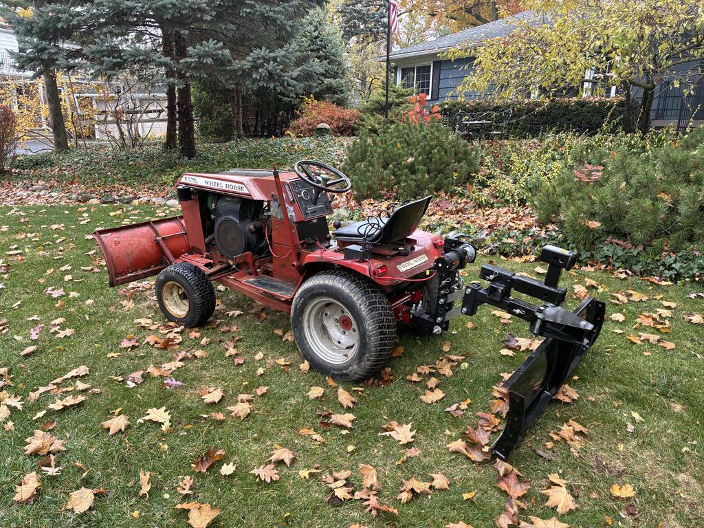

NCSteve 24 #1 Posted December 6, 2025 I finally got my box blade assembled and attached to my C120 with my clevis/sleeve hitch. I have hooked up the chain to my clevis hitch,but I cannot raise the box blade using the lift handle. I am not strong enough! Is there a solution for this problem other than the Charles Atlas strength building program? 1 2 Share this post Link to post Share on other sites

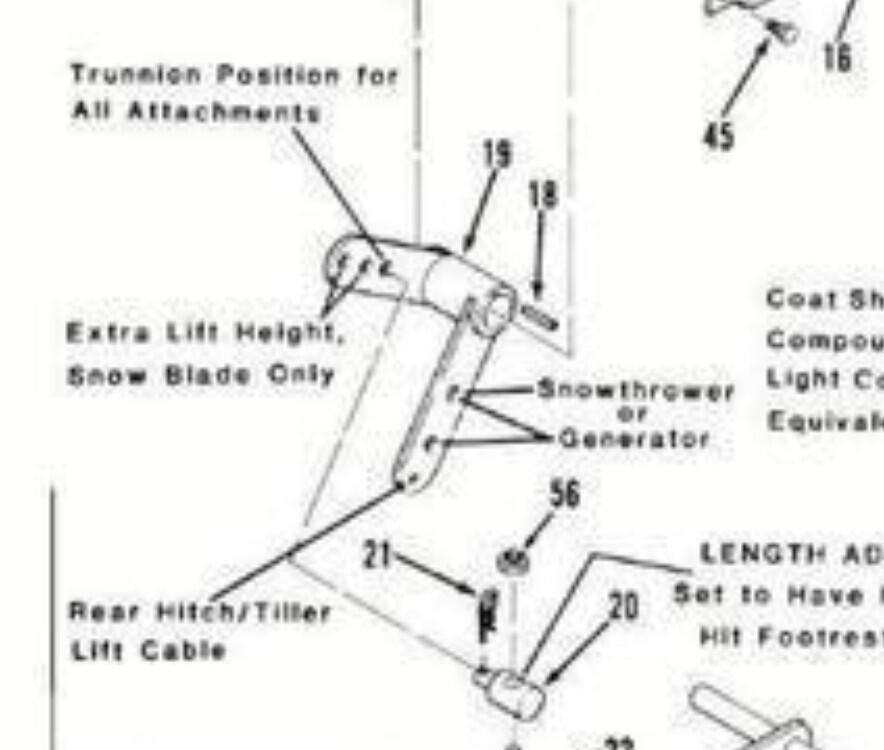

kpinnc 18,884 #7 Posted December 7, 2025 (edited) Wondering if you could move the front clevis on the lift cable up one hole at the bellcrank? You'll loose some travel but increase leverage... The diagram below shows using the bottom hole for the rear lift. Maybe try the next one up? Just spit balling. I have no idea if it would work or not. Edited December 7, 2025 by kpinnc 2 Share this post Link to post Share on other sites
ineedanother 2,800 #8 Posted December 7, 2025 7 minutes ago, kpinnc said: Wondering if you could move the front clevis on the lift cable up one hole at the bellcrank? You'll loose some travel but increase leverage... Shortening the tongue on the box blade could be significant as well. No idea what you're lifting but the greater the distance from the hinge point, the heavier the lift which is a greater strain on all of the lifting components. 1 Share this post Link to post Share on other sites
ineedanother 2,800 #9 Posted December 7, 2025 1 hour ago, kpinnc said: Wondering if you could move the front clevis on the lift cable up one hole at the bellcrank? You'll loose some travel but increase leverage... The diagram below shows using the bottom hole for the rear lift. Maybe try the next one up? Just spit balling. I have no idea if it would work or not. You might also consider the attachment point on the box blade. Altering connection point on the implement will change the ratio of distance and angles between the levers and pivot point. Essentially like gear reduction to sacrifice output (like slower steering response or less implement movement) in exchange for less energy needed on the lever or steering wheel. Lengthening the lever on the tractor (or installing a larger steering wheel) would be similar but not always practical. 1 Share this post Link to post Share on other sites
