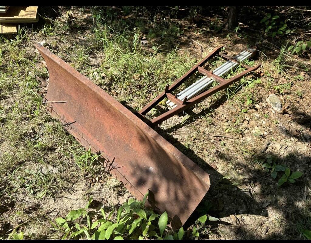

thekevin 51 #1 Posted December 6, 2025 I have a 95 416-8 and a 69 Raider 12. Would this fit either of those? Share this post Link to post Share on other sites
ebinmaine 80,904 #2 Posted December 6, 2025 Neither.... That's a short frame plow. Early model at that. 3 Share this post Link to post Share on other sites
ebinmaine 80,904 #3 Posted December 6, 2025 What you need is a Long Frame plow. See how that one has a frame like a triangle 🔺️? A Long frame has about 25 or 30 inches near the back that's parallel. 1 Share this post Link to post Share on other sites

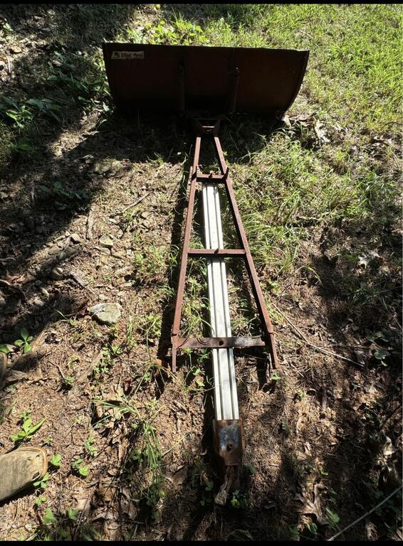

702854boy 1,153 #4 Posted December 6, 2025 Is this plow yours? If so could you take a better arial view for reference to use with my plow? 1 Share this post Link to post Share on other sites
ri702bill 13,189 #5 Posted December 6, 2025 11 minutes ago, ebinmaine said: Neither.... That's a short frame plow. Early model at that. That it is...so early that it does not attach using the Unidrive quick mount bracket. Most likely pivots off the lower sides of the frame "F" plate... Interesting use of the modern rectangular aluminum extrusion as a stiffener though... 2 Share this post Link to post Share on other sites
702854boy 1,153 #6 Posted December 6, 2025 2 minutes ago, ri702bill said: That it is...so early that it does not attach using the Unidrive quick mount bracket. Most likely pivots off the lower sides of the frame "F" plate... On ours it has two angle pieces of angle iron that go around the axel tube and two bolts to hook the plow, it does not hook up to the f plate 3 Share this post Link to post Share on other sites
Ed Kennell 47,587 #7 Posted December 6, 2025 IIs that a frame for a WH Senior? 1 Share this post Link to post Share on other sites
gwest_ca-(File Mod) 12,508 #8 Posted December 6, 2025 22 minutes ago, Ed Kennell said: IIs that a frame for a WH Senior? Blade Dozer 54" wide 15" high swivels left and right model 2354 1 Share this post Link to post Share on other sites
