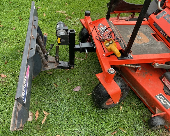

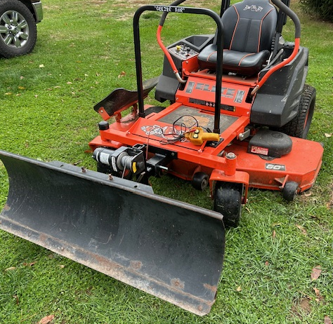

JoeM 10,120 #14 Posted December 7, 2025 58 minutes ago, WHX?? said: Guessing you mean a front blade ... don't even wanna see The Pullstart dropping his Scag in a furrow! Let's not give him ideas shall we?!?!? Oh my that PS thing is funny. Here is the project. One pin and two clips, there is room for tire chains but IDK. I added the snow plow and Geezer Bar. The bar is for helping the dude to get on and off cause he ain't to steady. I cut a little grass with it while it was here, it is fast but just don't like it. Also it was not good on the slopes. Share this post Link to post Share on other sites
kpinnc 18,851 #15 Posted December 7, 2025 4 hours ago, JoeM said: cut a little grass with it while it was here, it is fast but just don't like it. Also it was not good on the slopes. I can't see how a snow blade would be remotely effective. ZTRs certainly have the torque to push it, but if the blade was angled only one rear wheel would carry the load. No fixed front wheels to hold track... Maybe the ability to spin one wheel faster would add directional stability. Just seems difficult like mowing along a hillside. It can be done but wheel slip is common. Share this post Link to post Share on other sites
JoeM 10,120 #16 Posted December 7, 2025 3 hours ago, kpinnc said: how a snow blade would be remotely effective I know, defies logic, but I went on you tube and folks are using them. I will say most I have watched were on level ground. Share this post Link to post Share on other sites
kpinnc 18,851 #17 Posted December 8, 2025 3 hours ago, JoeM said: know, defies logic, but I went on you tube and folks are using them. I will say most I have watched were on level ground. If, and it's a big if- traction can somehow be maintained then a ZTR would be an effective snow pusher. Share this post Link to post Share on other sites
wh500special 2,453 #18 Posted December 21, 2025 (edited) Toro/WH offered blades for the 700 and 600-series zero turns. Given how weak they were just lugging around an operator and the tractor itself I’m guessing it turned out being a regrettable decision. Seems like adding a snow blade would be asking a lot of the transmissions and potentially way beyond their sustained capacity. By the time you weight it down to gain traction I think you’re inviting Trouble in the front door. And, yes. That’s Trouble with a capital T that rhymes with P… Harold Hill Edited December 21, 2025 by wh500special Share this post Link to post Share on other sites

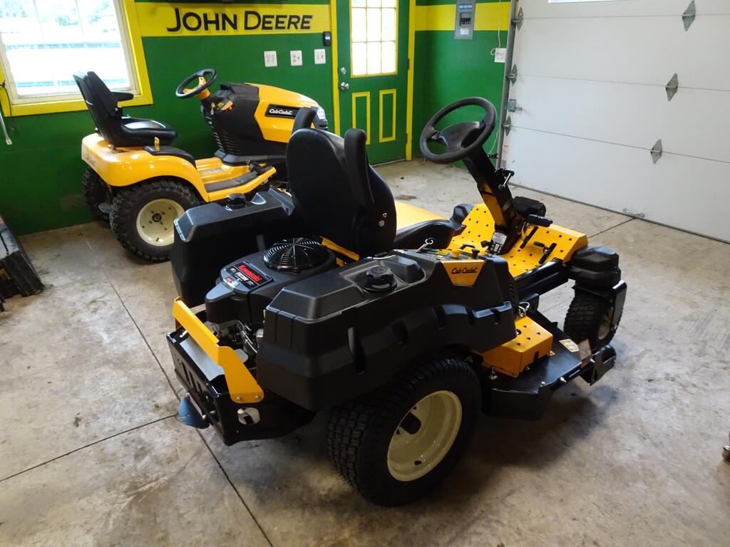

Handy Don 17,189 #21 Posted December 21, 2025 (edited) 3 hours ago, wh500special said: Seems like adding a snow blade would be asking a lot of the transmissions and potentially way beyond their sustained capacity. The Cub Z-Force, the Altoz, the Toro 800--these are at the highest end of the “commercial grade” models built for intense duty. They were deliberately built to deliver lots of power to the drive train. They do not even remotely compare with consumer-level or even modest landscaper models in construction, capability, or price. To me, this is not unlike WH's decision to field the Eaton 700 as well as the Eaton 1100. The 700 is a perfectly fine unit for grass mowing or snowblowing, but not designed to carry enough power from the engine to the drive wheels to permit snowplowing or dirt busting. As such, it carried a lower price point along with lower expectations. Also, to @sergeant’s comparison, WH tractors were never sold as able to do ANYTHING or EVERYTHING. They aimed at a segment of the market that appreciated the quite-a-bit that they were capable of doing at a price people were willing to pay. I think few owners of ¼, ½, or 1 acre lawns would pony up to buy a top-of-line Z-turn today. Edited December 21, 2025 by Handy Don 2 Share this post Link to post Share on other sites
sergeant 350 #22 Posted December 22, 2025 (edited) 8 hours ago, Handy Don said: The Cub Z-Force, the Altoz, the Toro 800--these are at the highest end of the “commercial grade” models built for intense duty. They were deliberately built to deliver lots of power to the drive train. They do not even remotely compare with consumer-level or even modest landscaper models in construction, capability, or price. To me, this is not unlike WH's decision to field the Eaton 700 as well as the Eaton 1100. The 700 is a perfectly fine unit for grass mowing or snowblowing, but not designed to carry enough power from the engine to the drive wheels to permit snowplowing or dirt busting. As such, it carried a lower price point along with lower expectations. Also, to @sergeant’s comparison, WH tractors were never sold as able to do ANYTHING or EVERYTHING. They aimed at a segment of the market that appreciated the quite-a-bit that they were capable of doing at a price people were willing to pay. I think few owners of ¼, ½, or 1 acre lawns would pony up to buy a top-of-line Z-turn today. The Cub Z-Force is a higher-end residential model, not a commercial model. The only thing it has that is commercial is the entry-level Commercial Hydro-Gear ZT3100 transmissions. which was Only in the Z-Force SX series. The Z-Force S series had a ZT2800 (top-of-the-line residential-grade transmission), but most of the Cubs with steering wheels can take a front blade and can climb very steep hillsides that many 2WD lawn & garden tractors, regardless of brand, can't climb.(unless they have some type of traction assist). The lap bar zero-turn, whether residential or commercial, usually gives you a slide down a steep hillside because of the dummy wheel front axles. Cub Cadet Residential-grade steering wheel zero turns https://www.cubcadet.com/en_US/ultima-zts-zero-turn-mowers Cub Cadet 2026 Residential-grade steering wheel zero turns https://www.cubcadet.com/en_US/ultima-zs-zero-turn-mowers Cub Cadet Premium residential-grade steering wheel zero turns (replace the Cub Cadet Z-force in 2023) https://www.cubcadet.com/en_US/ultima-ztxs-zero-turn-mowers Just about every level of Lap Bar Steering Cub Cadet-MTD/Stanley makes has a front blade available for it. https://www.cubcadet.com/en_US/zero-turn-mower-accessories/52-inch-all-season-plow-blade-attachment/19A70063OEM.html?fitsOnModel=false The commercial-grade Cub Cadet zero-turns Tanks were at the commercial level in the past and have been replaced by the PRO models listed below in recent years. https://www.cubcadet.com/en_US/commercial-equipment/commercial-zero-turn-mowers Dixon in the past made both front blades and snow blowers for every level of zero turn they made prior to being bought by Husqvarna. The Toro Wheel Horse 600 series, which was made in the late 1980s through the 1990s, had a front blade for . Even after 2000 until about 2007, Toro offered a snow blade for many of there zero turns. Ariens was another manufacturer that did make front blades for their entry-level zero turns at the beginning part of this century. Many of the Bad Boy residential line zero turns are not that low in price either. The Maverick is in the $7,000 price range. The ZT Elite is in the $6,000 price range. The ZT Avenger is in the mid-$5,000 price range. The MZ Magnum is in the high $4,000 price range. The MZ Rambler is in the $3,200 to $3,700 price range. It seems only Bad Boys commercial line has a front blade available for them. Garden tractors In General were sold to Be the Sub compact tractor of there day from late 1940's with Bolens till the early 2000'S when the Sub Compact started coming on the scene. Wheel Horse regardless of parent company was Marketing there tractors to be and every Job type of tractor for all terrains as well My 1992 416H is a great Garden tractor (except for the Onan) I see a Honda or Briggs In it's future . It one of the Best cultivating Garden tractors I have owned The Eaton 11's are Great transmissions and for a Non traction assist GT there great at Plowing snow But My 416H is also Limited do to it's clevis hitch lift height (for Transporting sleeve Hitch 10-inch plows from Barn to Garden bed) and steep Hill climbing ability I am still on the look out to add to My collection with a 312H or a 314H I have always loved the Pre 1997 wheel Horses because of there Narrow size Edited December 22, 2025 by sergeant Share this post Link to post Share on other sites
