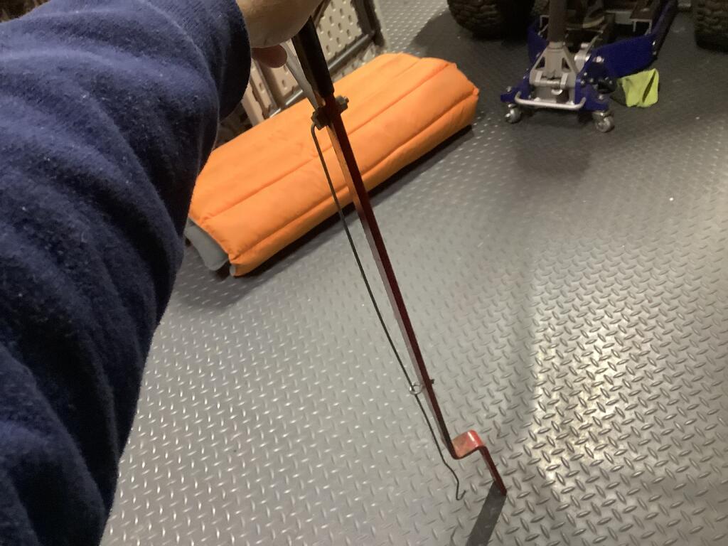

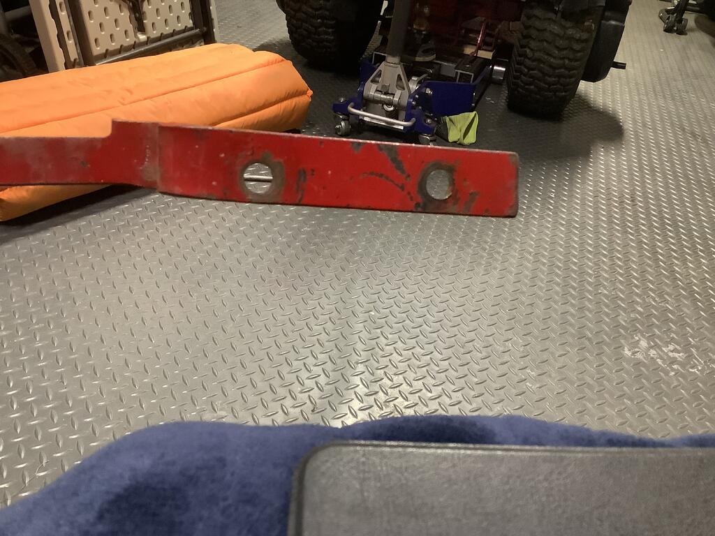

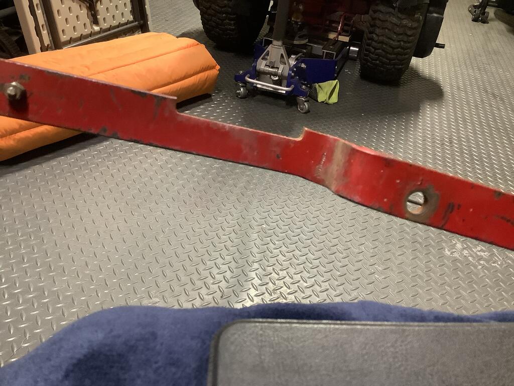

Gabe 32 #1 Posted December 4, 2025 Can someone tell me the correct measurement from the center of the top hole that attaches to the triangle on the frame to the center of the bottom hole for the rod, the one I have was cut off, so I’m unable to attach the rod, any advice is appreciated. I have 1/4”. Flat bar to weld the extension 78658322934__48619B84-BD31-4CF4-A483-E951B9A54A84.MOV Share this post Link to post Share on other sites

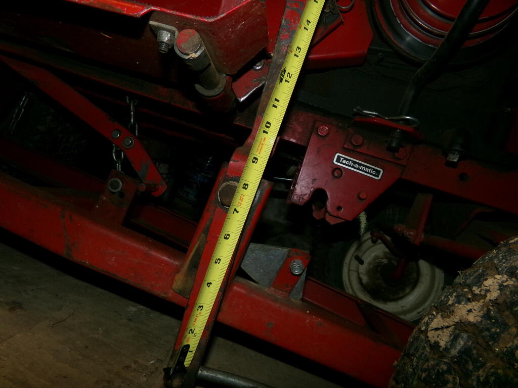

Ed Kennell 47,368 #2 Posted December 4, 2025 (edited) Mine is on 7.75" centers, and the triangle does not connect to the lever. It has its own support bar. Edited December 4, 2025 by Ed Kennell Share this post Link to post Share on other sites
Gabe 32 #3 Posted December 4, 2025 Yes you are correct, I didn’t know how to explain that, but the lever looks identical, thank you! 🫡🇺🇸 Share this post Link to post Share on other sites
Gabe 32 #4 Posted December 5, 2025 My attachment points where the hanger attaches to the triangle is slanted to the right it is not 90 degree position, is this normal? I used it like this before I found the rod that swivels the blade, so at that time I did not know the lever was short until this year lol, I used to use snow or get out to move the blade left or right. Appreciate the reply a photo👍 Share this post Link to post Share on other sites
Ed Kennell 47,368 #5 Posted December 5, 2025 That looks correct. Mine is also slanted. Share this post Link to post Share on other sites

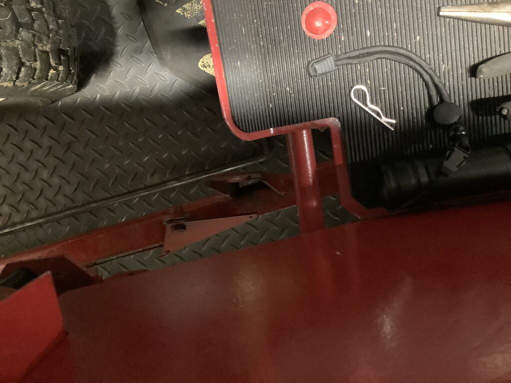

Gabe 32 #6 Posted December 5, 2025 Awesome, looks like that top mount is threaded, I never had the correct threaded bolt, just a smaller one that slid thru and had a nut ago keep it in place, couldn’t find the bolt size to thread count, but I manage with it the other way.. I have some chains sittting in vinegar lol to get red of the rust, then I’ll probably have to cut them, my tires are 22/7.5/12 thanks again Share this post Link to post Share on other sites
Ed Kennell 47,368 #7 Posted December 5, 2025 (edited) That should be a 1/2-13 thread. Edited December 5, 2025 by Ed Kennell 1 Share this post Link to post Share on other sites
Gabe 32 #9 Posted December 5, 2025 Ed, I just ran a tap thru it, you were 100% correct👊 thanks again 3 Share this post Link to post Share on other sites
ri702bill 13,068 #10 Posted December 5, 2025 45 minutes ago, Ed Kennell said: That should be a 1/2-13 thread. Use a 1/2-13 full threaded hex bolt long enough to have 4 to 6 threads protruding out the back to allow the use of a jam nut. That way, set the handle gap and tighten the jam nut to hold the adjustment... Share this post Link to post Share on other sites
