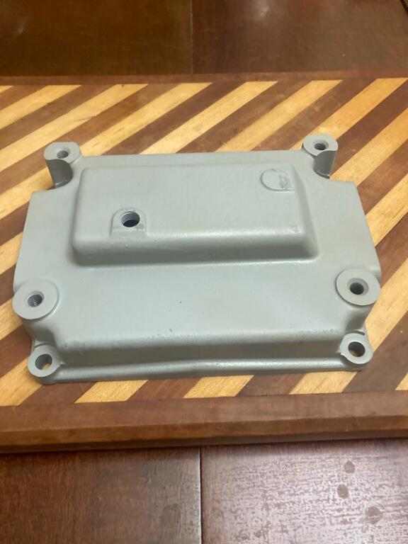

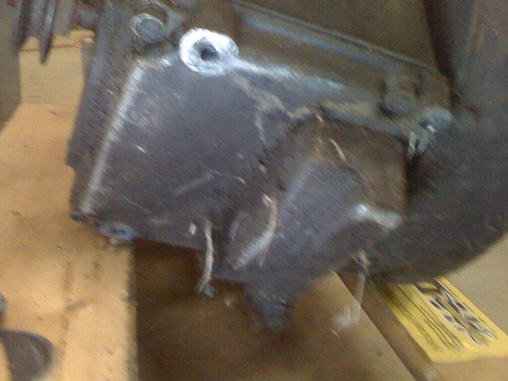

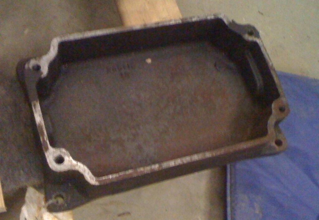

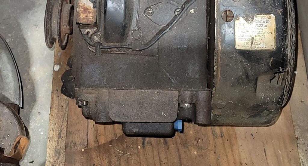

BradKahler 407 #101 Posted January 1 (edited) After much thinking about it I think I've sort out just where I stand with the K341 oil pan situation. When I got the engine it had this oil pan on it. After poking around on the internet I found that other pans might work so I found this one and ordered it. It obviously wouldn't fit my K341 so I started looking again. After looking some more I came up with the oil pan in this picture. Here is a different view of the pan that I bought. The question I have is would this engine fit on a B100 chassis? I think the crank diameter is 1" but I need to verify that number. After more research I found this thread about Wheel Horse Shaker engines. I think the oil pan I have is the same as on the shaker engines. Edited January 1 by BradKahler Share this post Link to post Share on other sites

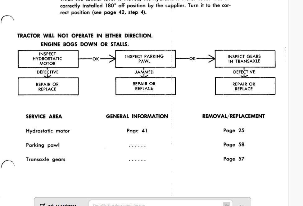

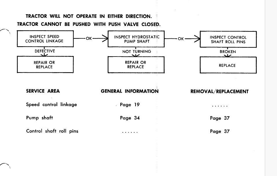

pfrederi 21,151 #104 Posted January 1 Time to look at the manual 1 Share this post Link to post Share on other sites

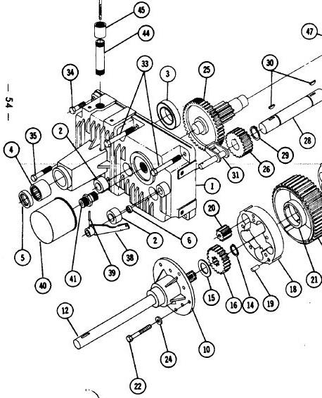

pfrederi 21,151 #105 Posted January 2 There is a roll pin (#39) in between the brake lever and the shaft that goes inside the tranny, if it shears the parking pawl may not dispense even when the lever is moved. 1 Share this post Link to post Share on other sites
BradKahler 407 #106 Posted January 2 58 minutes ago, pfrederi said: Time to look at the manual Thanks for the link , looks like I've got some reading to do. If the work requires the hydro unit to be removed then this tractor might have to be put on the back burner. With the motor most likely needing internal work and the same for the hydro unit, I don’t have excess room for two tractors to be in pieces (i.e. the 656). It might be time for this tractor to swap places with the B100 8-speed to see what condition it's in. Share this post Link to post Share on other sites

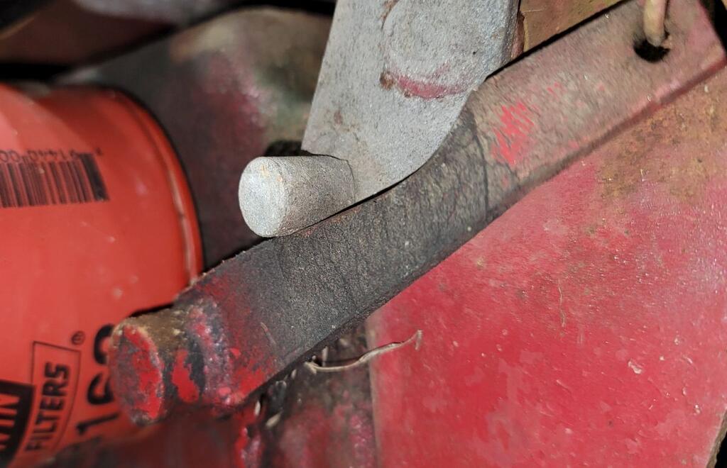

BradKahler 407 #107 Posted January 2 37 minutes ago, pfrederi said: There is a roll pin (#39) in between the brake lever and the shaft that goes inside the tranny, if it shears the parking pawl may not dispense even when the lever is moved. Oops, I missed this reply. I believe these two pictures show the arm #38 from the diagram above. I can confirm that the arm does move when operating the brake handle. However, I can't say that the roll pin isn't broken and the arm may be moving only partially. I will look closer at the arm/roll pin tomorrow to see how it looks. Thanks for the tip! Share this post Link to post Share on other sites

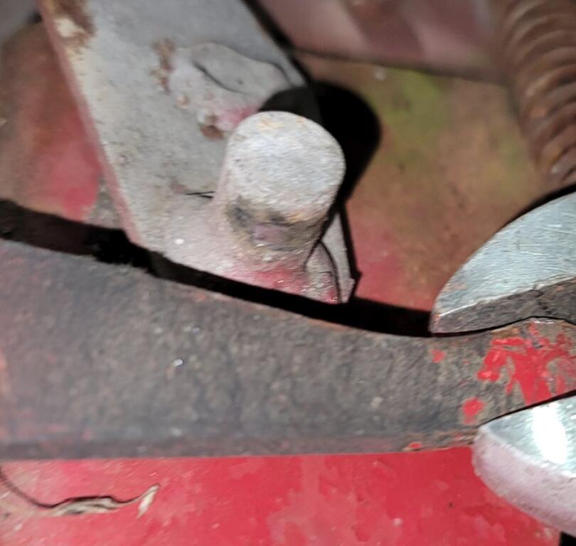

BradKahler 407 #108 Posted January 2 I took a closer look at the linkage for the parking brake and it does have some slop in it. The attached picture shows a little bit of wear in the stud on the parking brake lever. Compared to some pictures I found while searching, this one doesn't look all that bad. I've also included a short video showing the Brake Lever Slop in the parking brake linkage. The video doesn't show it too well but the arm with the pin does move up and down a little bit. Are there ways to tight up the slop or do I live with it? In order to help troubleshoot, would it be beneficial to hold or clamp the brake lever a little lower than where it is currently being pushed to by the brake lever? Or does that make any sense at all? 1 Share this post Link to post Share on other sites

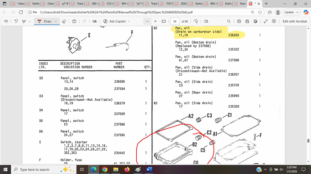

953 nut 69,341 #109 Posted January 3 That oil pan looks much like the one used on the K-241AS that was used on the 1055 and 1066 so it should work though I don't know if it will be a direct bolt-up and the bottom drain could present a problem when changing oil. That appears to from a Cub Cadet and the drain would have been facing forward, not toward the frame. Here is a screen shot of the 1055 oil pan. 1 Share this post Link to post Share on other sites

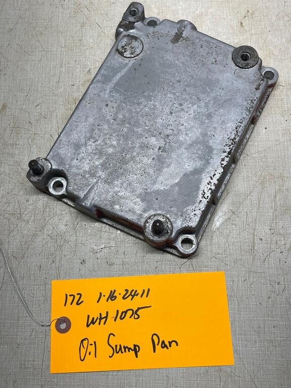

BradKahler 407 #110 Posted January 3 2 hours ago, 953 nut said: That oil pan looks much like the one used on the K-241AS that was used on the 1055 and 1066 so it should work though I don't know if it will be a direct bolt-up and the bottom drain could present a problem when changing oil. That appears to from a Cub Cadet and the drain would have been facing forward, not toward the frame. Here is a screen shot of the 1055 oil pan. I found this oil pan from a listing on ebay. I think it's B2 in your reference above. Its not a match for mine, although the mounting holes might be the same. I also found this one on ebay that is listed for K241/K301/K341 engines. I believe it looks just like the oil pan on my engine with the exception of where the oil drain hole is located. I could easily tap a new hole for the oil drain so that it's on the bottom. Share this post Link to post Share on other sites
