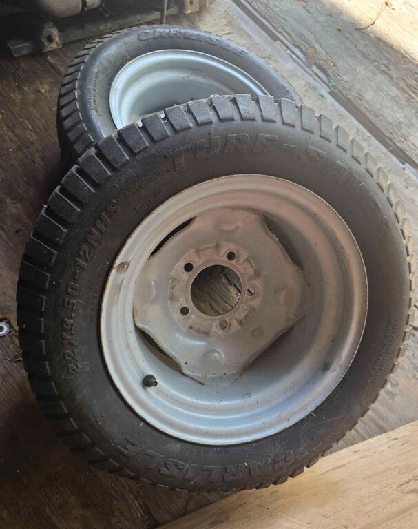

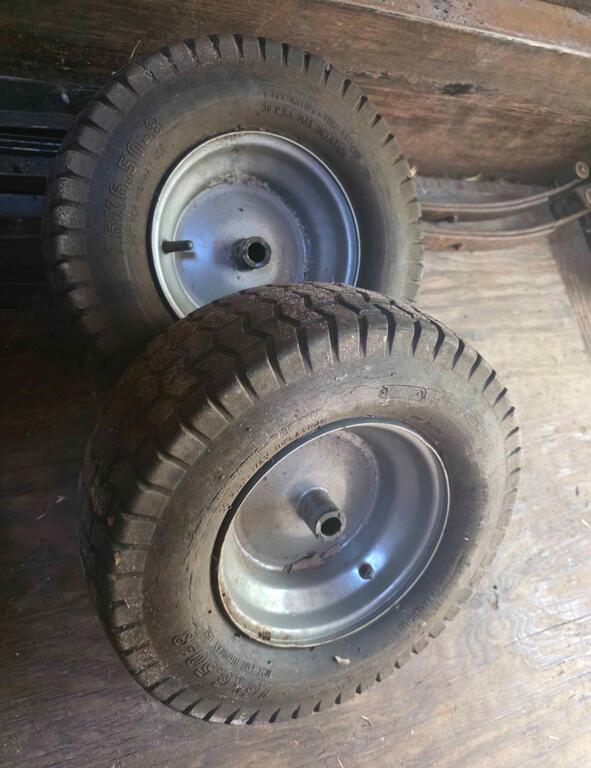

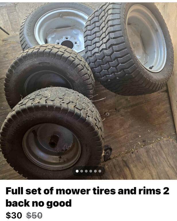

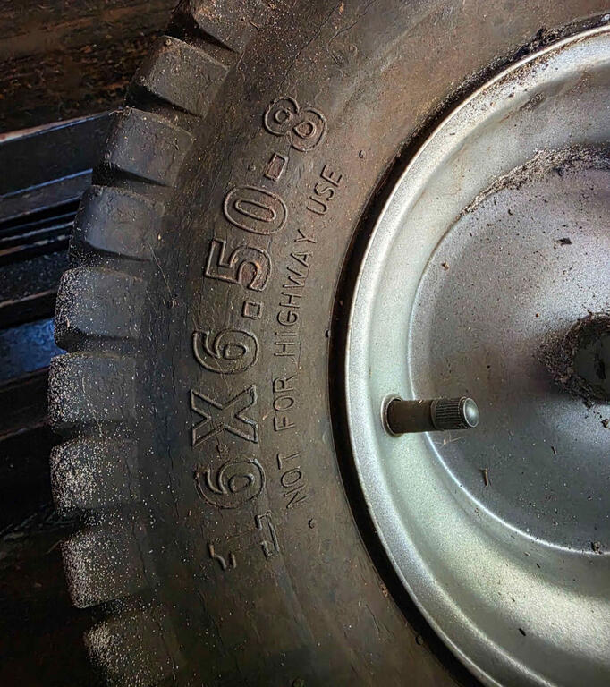

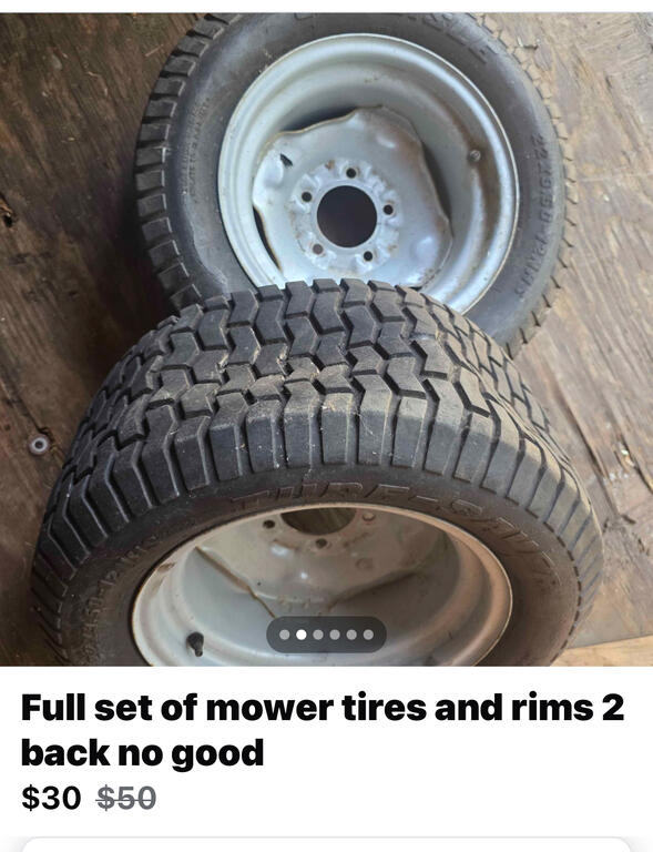

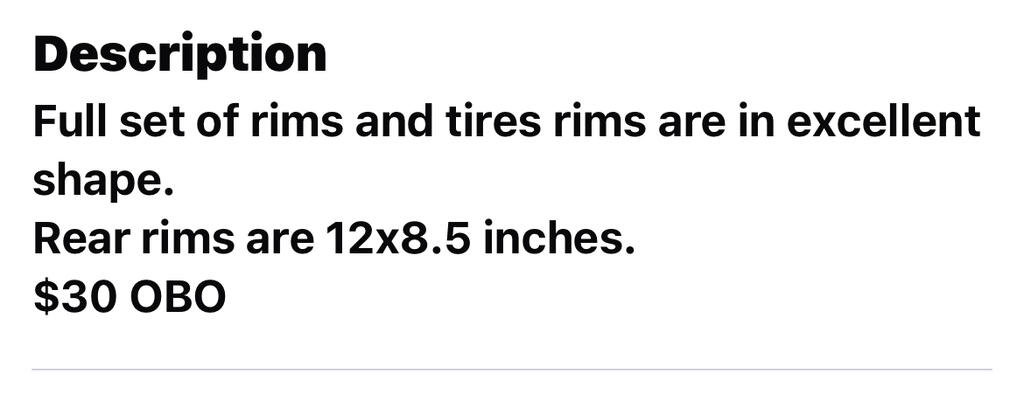

FLtractor 253 #5 Posted December 4, 2025 (edited) Just found these within a resonable driving distance… would these work with 23x8.50x12? Even if buy them just for the wheels? Seller said: back wheels unusable but rims excellent condition.. are they alone worth $30.00?? And are they what I need? I took Eric’s recommendation and found some Deestone turf tires for $125.00 shipped.. so I’d be about $150.00 in for these used rims and new tires. Which I think is resonable considering my current 856 rears are Orignal Wheelhorse branded tires and Calcium filled wheels haha. Edited December 4, 2025 by FLtractor 1 Share this post Link to post Share on other sites
kpinnc 19,107 #6 Posted December 4, 2025 (edited) 1 hour ago, FLtractor said: Just found these within a resonable driving distance… The rear wheels and tires will fit any traditional Wheel Horse that used 12 inch wheels. Just be aware that the rear tire size is what would be considered slightly smaller on the size scale. 308-8 and similar tractors used those tires. Looks like they will also need inner tubes due to the weather cracking. That will likely be another $40 or more. The front tires will work with any 8 inch front rims on a Wheel Horse, but those wheels will not. They do not have the right hubs for bearings. Personally, I would continue to look for new tires. These are already well torwards being worn out. If they were dirt cheap, they could work for a short while but not worth much at all. Edited December 4, 2025 by kpinnc 2 1 Share this post Link to post Share on other sites
