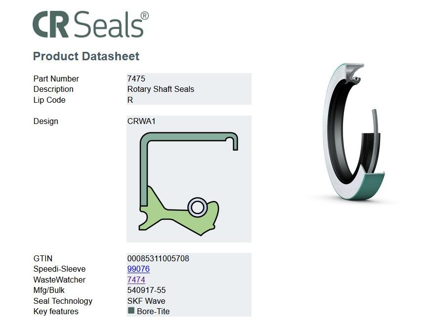

pfrederi 21,103 #5 Posted December 1, 2025 You might want to try to save your old seals. Push the new one in enough to get your old one back on but wrong direction.. may help keep out some the mud and crap. Sort of like a double lip seal. I took a quick look but didn't see a 11050 with CRWA double lip. Probably is one just didn't look hard enough. Share this post Link to post Share on other sites
mudmowerdiesel 236 #6 Posted December 1, 2025 2 minutes ago, pfrederi said: You might want to try to save your old seals. Push the new one in enough to get your old one back on but wrong direction.. may help keep out some the mud and crap. Sort of like a double lip seal. I took a quick look but didn't see a 11050 with CRWA double lip. Probably is one just didn't look hard enough. Thanks Share this post Link to post Share on other sites
