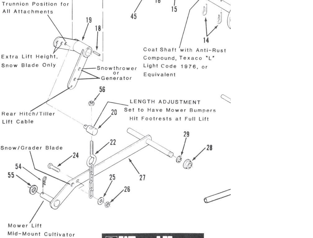

Cathie 2 #1 Posted December 1, 2025 Tractor: 312-A Snowblower: 06-42ST05 The snowblower blower came with my first 312-A. It wasn't easy, but I could lift it with two hands and not feel like the lever was going to break. I have a second 312-A I just tried attaching the blower to, and I cannot lift it on my own using the lever at all. The lift rod does not have the spring assist bracket on it. It's part #1986 Lift rod is attached on the highest hole of the bellcrank. (First 312-A is down for repairs) Any recommendations for a solution appreciated! Share this post Link to post Share on other sites

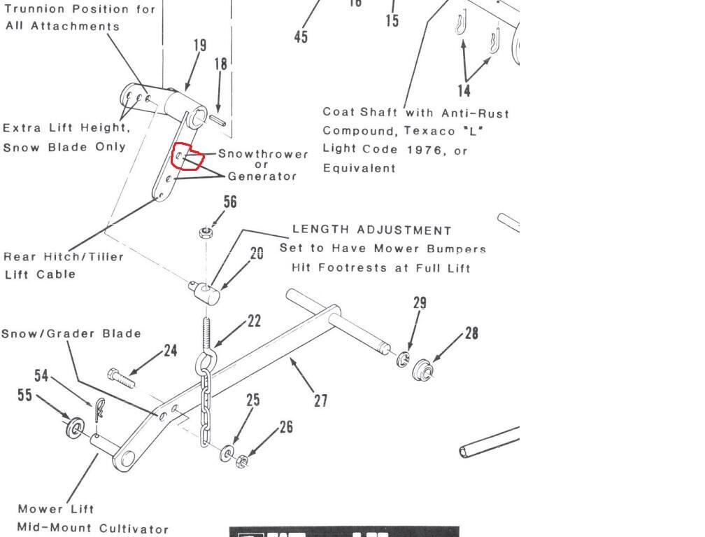

wallfish 19,533 #2 Posted December 1, 2025 (edited) The lift flag is probably connected in the wrong hole on the bell crank lever. Connect it in the closest hole to the center. Edited December 1, 2025 by wallfish 2 1 Share this post Link to post Share on other sites
gwest_ca-(File Mod) 12,092 #3 Posted December 1, 2025 3 1 Share this post Link to post Share on other sites
Racinbob 12,878 #4 Posted December 1, 2025 I pretty much consider a lift assist spring a must on a show thrower. Adjusted properly and with the flag connected to the proper hole as shown it's a pretty easy lift even for a wimpy guy like me. I would find a flag with a tab or modify the one you have. Some guys have add an assist on the front so maybe they can chime in here with their ideas. to 3 1 Share this post Link to post Share on other sites
ri702bill 11,617 #5 Posted December 1, 2025 Yup - the assist spring, when properly adjusted, helps greatly. The NOS 1963 one I scored did not have the tab on the flag; I added one. Over-adjust the tension and the snowblower bounces and rides up over the snow.... 2 1 Share this post Link to post Share on other sites
squonk 45,888 #6 Posted December 1, 2025 Yes, make sure the flag is in this hole. 2 1 Share this post Link to post Share on other sites
Ed Kennell 45,524 #7 Posted December 1, 2025 Should require the same force if the flag was in the top hole on both tractors. The only differences I can think of is the orientation of the push rod where it attaches to the blower and/or the lubrication of the lift arm bell crank. to the 1 1 Share this post Link to post Share on other sites

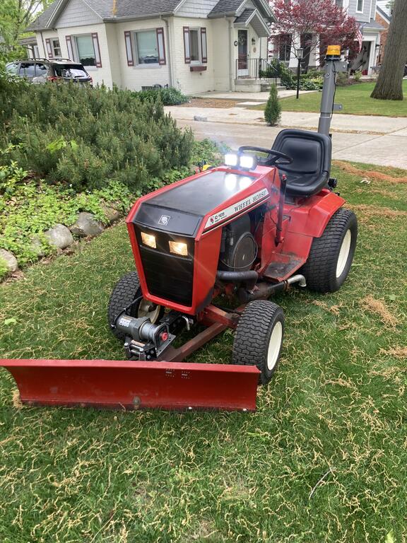

953 nut 64,843 #8 Posted December 1, 2025 (edited) @SylvanLakeWH has a small electric winch mounted up front to lift the snow plow, perhaps he can share some pictures. Edited December 1, 2025 by 953 nut fat finger 1 1 Share this post Link to post Share on other sites
Cathie 2 #9 Posted December 1, 2025 Thanks all for the ideas! The flag was mounted on the highest hole. I'll add a tab to my flag and putt in a lift spring. 1 Share this post Link to post Share on other sites
SylvanLakeWH 30,923 #10 Posted December 1, 2025 1 hour ago, 953 nut said: @SylvanLakeWH has a small electric winch mounted up front to lift the snow plow, perhaps he can share some pictures. Here ya go... works great! 2 Share this post Link to post Share on other sites
