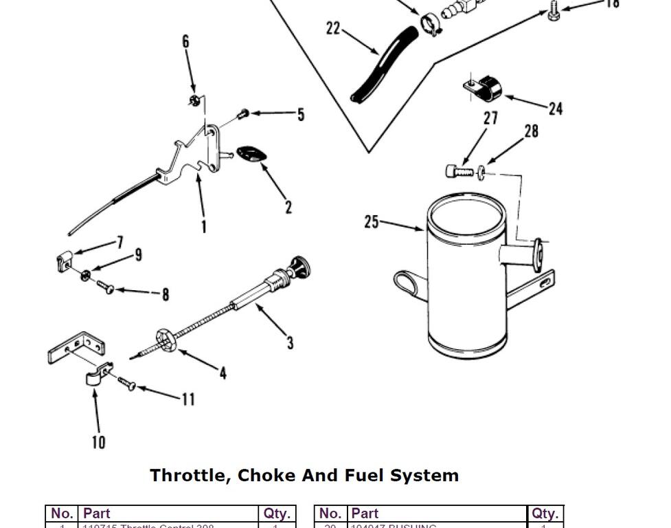

Stan50 213 #30 Posted December 5, 2025 (edited) On 11/30/2025 at 3:38 PM, Stan50 said: Throttle works properly but yes, I definitely look forward to it I just examined Manual for 1985 312-8 with K301S engine, looks like this throttle cable setup on engine cover is correct,good for me . Above this "1 screw high level setup" for throttle cable is bracket for choke cable. Edited December 5, 2025 by Stan50 1 Share this post Link to post Share on other sites

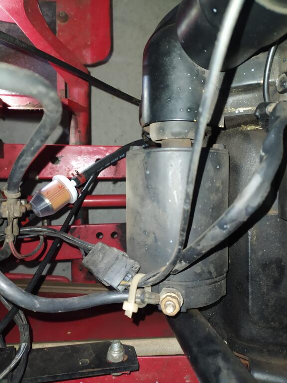

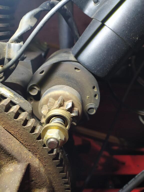

Stan50 213 #31 Posted December 6, 2025 My K301 starter drive, some teeth are worn. Should I worry and buy that drive in advance ? Right now everything works smoothly I don't have any problems with starting engine. Share this post Link to post Share on other sites
953 nut 68,125 #32 Posted December 6, 2025 4 hours ago, Stan50 said: Should I worry and buy that drive in advance If parts availability is not easy where you live it would be good to buy in advance. 1 Share this post Link to post Share on other sites

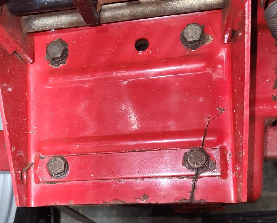

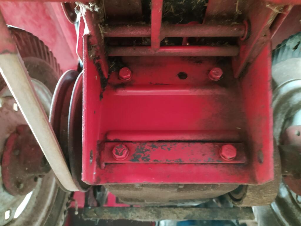

Brockport Bill 2,448 #33 Posted December 6, 2025 bought a 312-8 new in 1989 - still have it 36 years later - over 2,000 hours --- always had enough power for every use - plowing, tiller, cart hauling, mowing, etc - - simple to maintain - son, daughter and now 4 grandsons all learned the basics of operating and tool use at early age - One suggestion if you have not already looked ? Check the underneath frame plate that connects tractor to transmission to be sure there is not a stress crack which can happen on wh from prior heavy plow or tiller use. 1 1 Share this post Link to post Share on other sites
Handy Don 17,167 #34 Posted December 6, 2025 7 hours ago, Stan50 said: My K301 starter drive, some teeth are worn. Should I worry and buy that drive in advance ? Right now everything works smoothly I don't have any problems with starting engine. The teeth on starter motors are often beveled at the ends to ease engagement with flywheel teeth as the bendix pushes the gear outward. There may be less wear than you think. I do’t see any corresponding wear on the edges of your flywheel teeth. That said, if having this machine sidelined while sourcing a replacement starter is untenable, then a spare might be a good investment. 1 Share this post Link to post Share on other sites
8ntruck 9,171 #35 Posted December 6, 2025 (edited) I used to work witha guy who flew scout helicopters for the Army in the middle east. One of his sayings was "spare parts are life". Edited December 6, 2025 by 8ntruck 2 Share this post Link to post Share on other sites

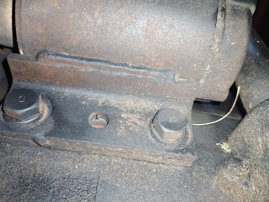

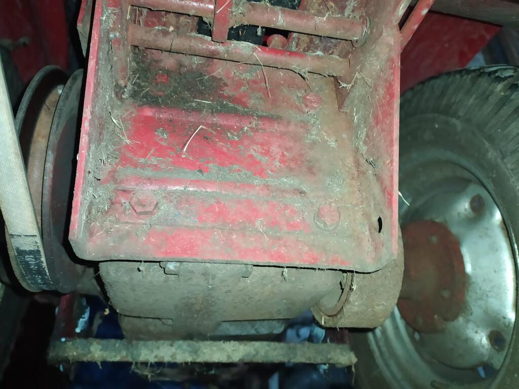

Stan50 213 #36 Posted December 6, 2025 (edited) 1 hour ago, Brockport Bill said: One suggestion if you have not already looked ? Check the underneath frame plate that connects tractor to transmission to be sure there is not a stress crack which can happen on wh from prior heavy plow or tiller use. thank you for tip, looks like that part of the frame is OK, but higher, where first tube is, there is crack? I think.. Edited December 6, 2025 by Stan50 1 Share this post Link to post Share on other sites
Stan50 213 #37 Posted December 6, 2025 1 hour ago, Handy Don said: The teeth on starter motors are often beveled at the ends to ease engagement with flywheel teeth as the bendix pushes the gear outward. There may be less wear than you think. I do’t see any corresponding wear on the edges of your flywheel teeth. That said, if having this machine sidelined while sourcing a replacement starter is untenable, then a spare might be a good investment. I wrote down a few spare parts and worn out ones, so I will order them soon. Share this post Link to post Share on other sites
Handy Don 17,167 #38 Posted December 6, 2025 35 minutes ago, Stan50 said: Edited 30 minutes ago by Stan50 Cracks can easily be small and concealed by dirt. Clean thoroughly before final judgement! 1 Share this post Link to post Share on other sites
Stan50 213 #39 Posted December 6, 2025 (edited) Right, I took the picture in a hurry, I will check this tomorrow Ok, looks solid to me,no cracks. Edited December 8, 2025 by Stan50 checked again 1 2 Share this post Link to post Share on other sites

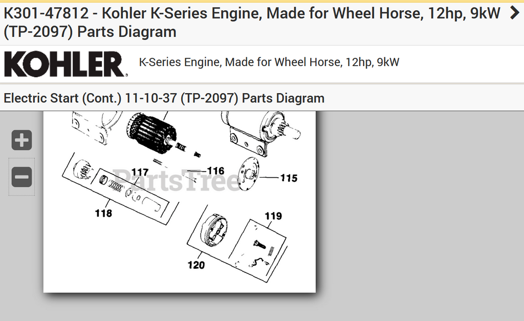

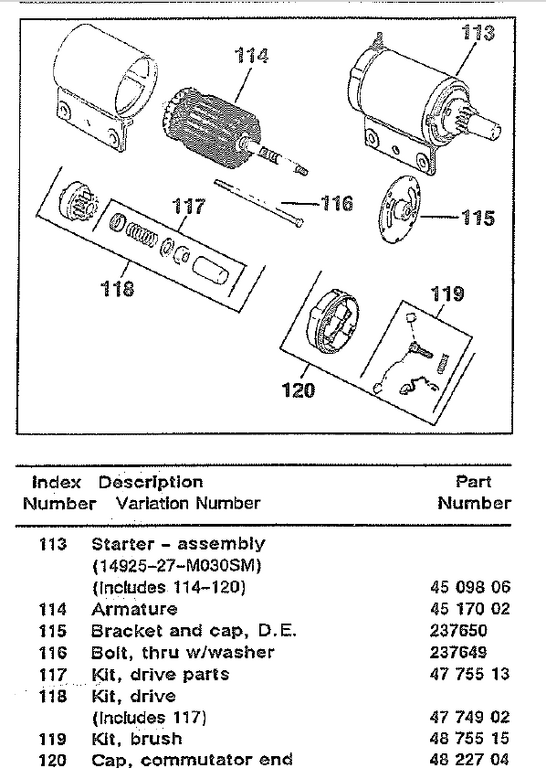

Stan50 213 #40 Posted December 14, 2025 (edited) As I mentioned I need to stash some parts in advance and I started doing it. I've ordered belts,points, spark plug cable kit, etc. I think to order starter repair kit and drive for my starter, I found this diagram and 118 brush kit, drive kit ( I think that I need just a gear) but I'm not sure.. My starter looks almost identical, no number on it Rebuilding the starter is always better than buing aftermarket one? Maybe do you know eventually good aftermarket replacement? Edited December 14, 2025 by Stan50 more info Share this post Link to post Share on other sites
Handy Don 17,167 #41 Posted December 14, 2025 15 minutes ago, Stan50 said: Rebuilding the starter is always better than buying aftermarket one A sluggish but working starter is nearly always rebuildable. Fatal issues are when the windings in the shell or armature are compromised (shorts caused by overheating or attempts to clean with solvents), or the commutator on the armature (where it contacts the brushes) is badly worn or gouged. Clean with air (and protective clothing), add relief between armature contacts, and replace brushes and/or bearings as needed and a sluggish starter will miraculously come alive. 1 Share this post Link to post Share on other sites
Stan50 213 #42 Posted December 14, 2025 So rebuild kit with brushes is way to go,anyway? I'm not sure whether my starter is original, looks old and proper one Share this post Link to post Share on other sites
Handy Don 17,167 #43 Posted December 15, 2025 (edited) 20 hours ago, Stan50 said: So rebuild kit with brushes is way to go,anyway? I'm not sure whether my starter is original, looks old and proper one I haven’t worked on that specific kind of starter so I cannot confirm one way or another. In general, the rebuild kits are not pricey. Since I prefer not getting partway through something to then have to order parts I do the kit and then replace what is needed. Last one I worked on needed only cleaning, some very minor filing on the mica separating the commutator contacts, and one new bearing. The rest (brushes, connector posts, and the other bearing) are now on my spares shelf along with a handful of other leftovers from earlier starters. I’ve yet to service a starter that needed a new drive gear or helical shaft, but I’m sure others have. For me, a thorough cleaning and a small amount of graphite lubricant has worked. (NOTE: follow the lubricant specs for your starter--they vary!) I, personally, don’t much care about age or originality. I’m focused on “does it do its job properly for me." Post the starter and engine's specs and someone more familiar with that setup will likely come along and chip in their experience. Edited December 15, 2025 by Handy Don 1 Share this post Link to post Share on other sites

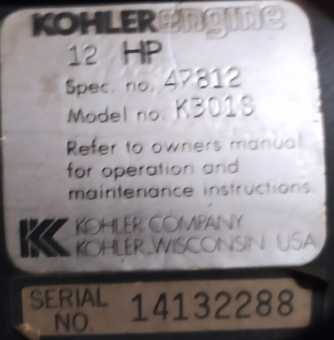

Stan50 213 #45 Posted January 14 Hi guys, this fuel pump will fit my Kohler K301S, 47812? Part# 47 559 04 according to Engine Manual. https://www.amazon.com/dp/B01LZTB7R4?ref=ppx_yo2ov_dt_b_fed_asin_title It is very frustrating to find correct part, so many part numbers I'm using correct K301 engine manual with variation numbers etc, but pictures are confusing sometimes... Share this post Link to post Share on other sites
Handy Don 17,167 #46 Posted January 14 What I’m seeing is a molded plastic fuel pump with inlet and output adaptors that snap into the pump body to accommodate fuel lines with different IDs and angles. (Almost certainly, once the adaptor is in, it should never be removed.) I recall some members have reported disappointment with plastic pumps--I’m not sure why. Durability? Leaks? I’ve not yet touched one. The washers would be very important to spread the force of the mounting screws on the plastic flanges. Have you tried calling AtoZ to see about getting a good used pump that could be refurbished with a quality kit from ThenAndNow auto? Share this post Link to post Share on other sites

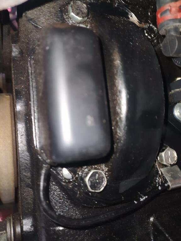

Stan50 213 #49 Posted February 27 I put my tractor for some work today: hauling wood mostly. Recently I've installed cheap new fuel pump, which works Ok I think, but I have another "problem" probably camshaft cover gasket leak? Just in case I ordered 2 of them :) Share this post Link to post Share on other sites

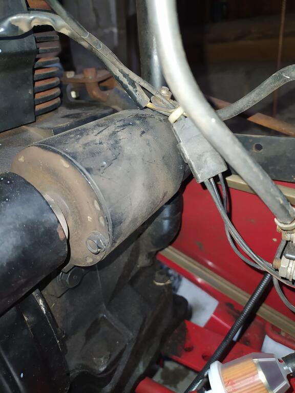

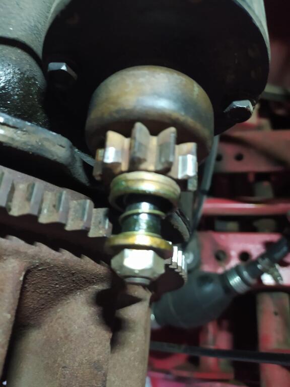

Stan50 213 #50 Posted May 21 Ok, I had some problem with starter, I don't know if it is big one. I mowed some grass in the morning, a few hours later I was going to startthe engine again and boom, no start, starter was working but not engaging motor/flywheel. Problem was off course bendix , didn't push the gear out, was stuck. I used spray grease on both ends etc, move the sucker a little and try start tractor again. It worked like always,but is this just start my problem,is this common thing in dirty conditions? Maybe greasing (obviously) is needed from time to time but what kind of lube? I used some spray grease, what I had on hand but maybe it was not good idea, greasy is greasy and sticky Share this post Link to post Share on other sites
