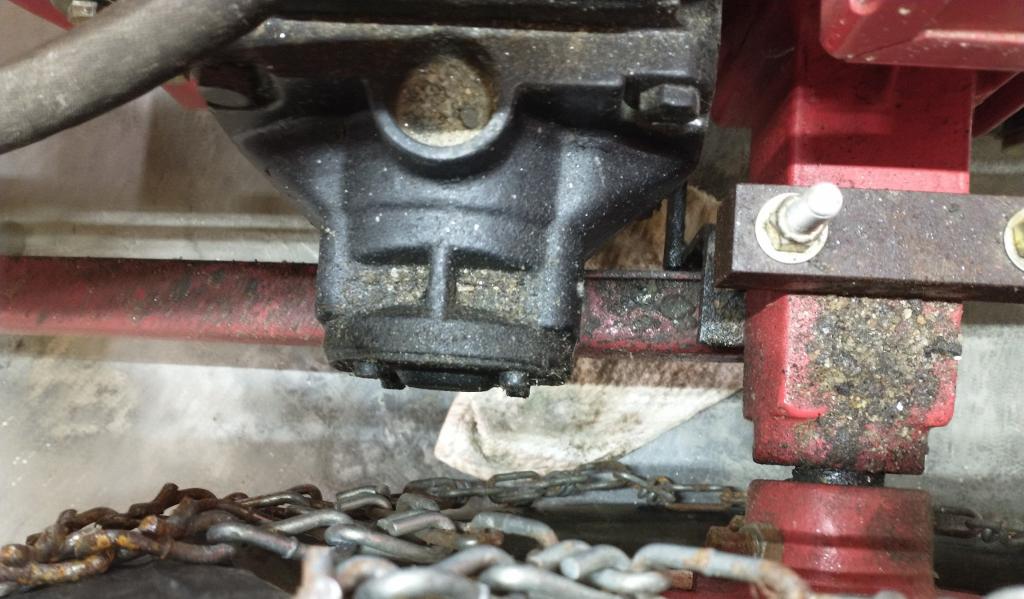

ebinmaine 80,081 #1 Posted November 29, 2025 I have a leak at or near the end of the transmission pump on my 1975 C160 Automatic. Is there a common problem or place to start looking? Possibly this end cap? Share this post Link to post Share on other sites
pfrederi 20,992 #2 Posted November 29, 2025 The picture is the Hydro motor not the pump. I can't see the leak... 1 Share this post Link to post Share on other sites
pfrederi 20,992 #3 Posted November 29, 2025 There are no seals on the motor just gaskets between it and the transaxle, and an O ring behind the circular end plate of the motor. There are also o rings to seal the acceleration valve on the front and back of the motor but I have not seen them leak. Share this post Link to post Share on other sites
ebinmaine 80,081 #4 Posted November 29, 2025 33 minutes ago, pfrederi said: The picture is the Hydro motor not the pump. I can't see the leak... There's a puddle on the floor but I wiped off the transmission before getting the picture. 21 minutes ago, pfrederi said: gaskets between it and the transaxle, That's been replaced but obviously could still be a source. 21 minutes ago, pfrederi said: and an O ring behind the circular end plate of the motor I'd start here... How do I find the oring size? Remove it and bring to a hydraulic shop? Share this post Link to post Share on other sites
squonk 47,733 #5 Posted November 29, 2025 Make sure the control shaft seal isn't leaking and clinging to the frame making it look like something else. 1 2 Share this post Link to post Share on other sites
Bar Nuthin 2,931 #6 Posted November 30, 2025 5 hours ago, squonk said: Make sure the control shaft seal isn't leaking and clinging to the frame making it look like something else. Also make sure it's not leaking at the input shaft. They can mist fluid and the hydro fan will spread fluid to parts unkown making it look like it's leaking from somewhere else. 1 Share this post Link to post Share on other sites
pfrederi 20,992 #7 Posted November 30, 2025 (edited) Sunstrand hydo leaks are 99% of the time pump input seal, motion control o rings or hydro hose failures...and manifold leaks on D series. That your motor is painted black makes me wonder if some one separated it from the pump. Is the pump black also??? If someone did separate the pump and motor then that is a potential leak just like the manifold leaks on D series. Wipe it down and see if you can isolate the leak point Edited November 30, 2025 by pfrederi 1 1 Share this post Link to post Share on other sites

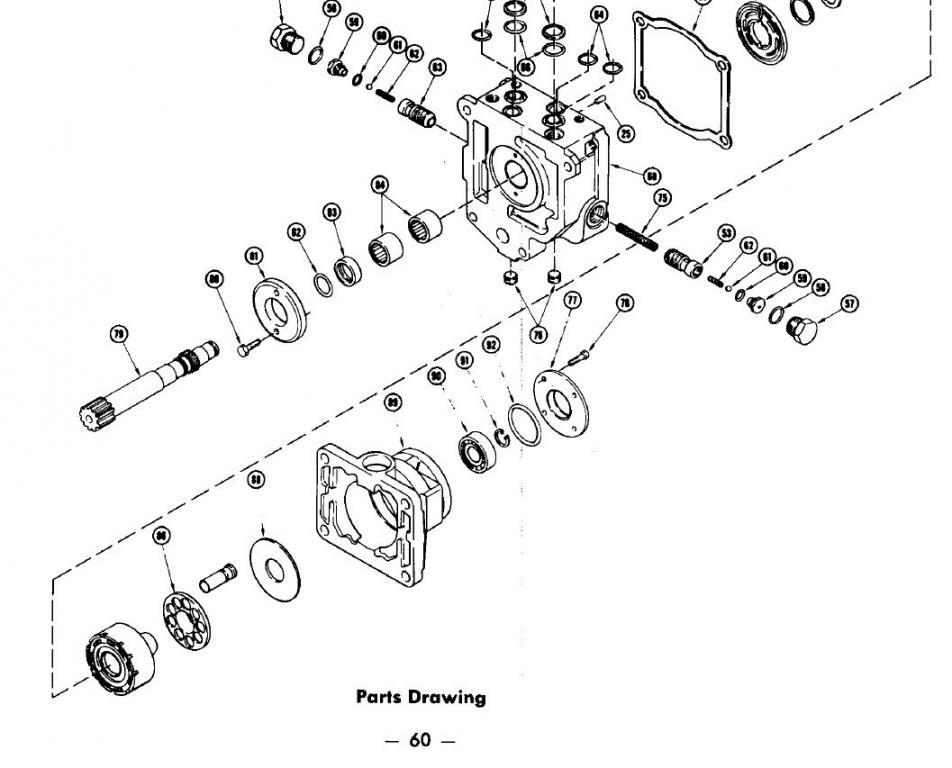

pfrederi 20,992 #8 Posted November 30, 2025 Based on experience with WH O-ring part numbers i would say #92 is a Dash 132 1 Share this post Link to post Share on other sites

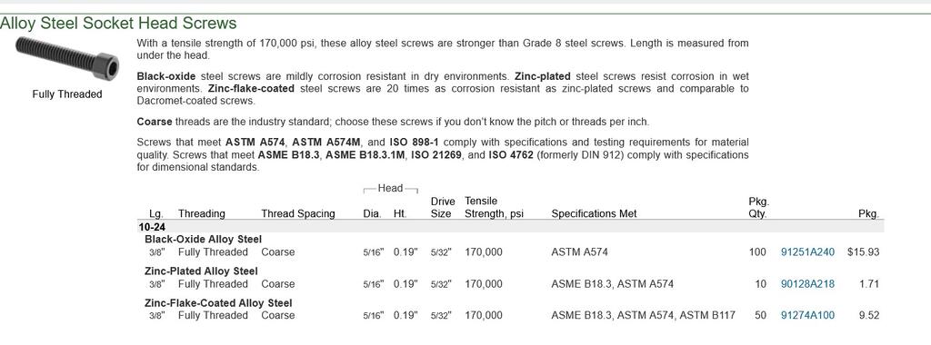

ebinmaine 80,081 #10 Posted December 26, 2025 On 11/30/2025 at 8:25 AM, pfrederi said: Based on experience with WH O-ring part numbers i would say #92 is a Dash 132 On 11/30/2025 at 8:14 AM, pfrederi said: Wipe it down and see if you can isolate the leak point Best I can tell it's that #92 oring. Dash 132... What's the shape? McMaster Carr shows several crosscuts of round, rectangular etc... Also, that bolt #78 appears to be an Allen head? but I can't get the size right. Worn, rusted, or filled with paint. Any way to tell what that should be? Share this post Link to post Share on other sites
pfrederi 20,992 #11 Posted December 26, 2025 10-24 3/8" Socket head O ring is round 1 Share this post Link to post Share on other sites

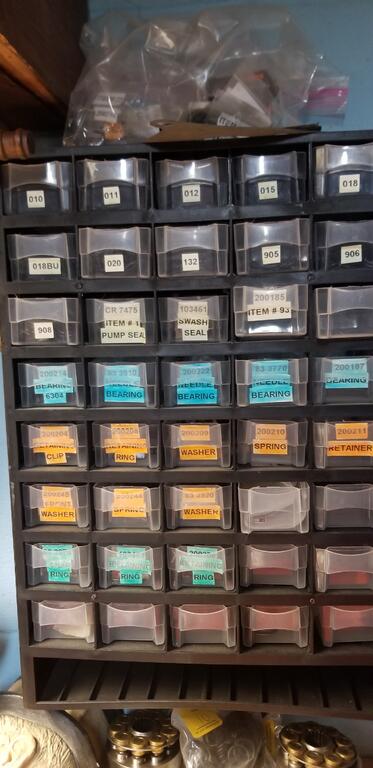

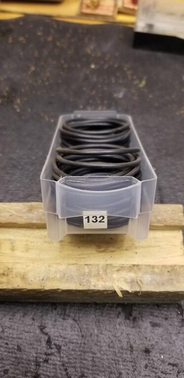

gt14rider 1,275 #12 Posted December 27, 2025 Happy New Year, if a dash 132 is what you need I can send you some. I also have all other O rings you may need let me know. 1 1 Share this post Link to post Share on other sites
ebinmaine 80,081 #13 Posted December 27, 2025 12 minutes ago, gt14rider said: Happy New Year, if a dash 132 is what you need I can send you some. Yes! I'd like to have a few please. Share this post Link to post Share on other sites
gt14rider 1,275 #14 Posted December 27, 2025 That all you need, they will be in the mail on Monday. 1 1 Share this post Link to post Share on other sites
ebinmaine 80,081 #15 Posted December 27, 2025 6 minutes ago, gt14rider said: That all you need, they will be in the mail on Monday. Much appreciated sir. I believe that's it .. for now. Share this post Link to post Share on other sites
gt14rider 1,275 #16 Posted December 30, 2025 Hi Eric, there on the way. Had ice storm Monday didn't go to postoffice yesterday. Hope all is well, Happy New Year 1 1 Share this post Link to post Share on other sites
