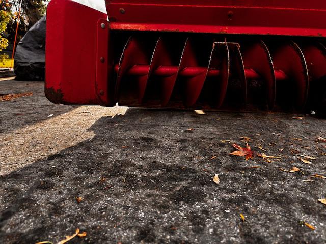

jsp_333 286 #1 Posted November 27, 2025 For the past 5 years or so my blower does not sit flush to the ground. I thought this is the year I'm going to ask for help. • the skids are both fully retracted. • the blower mounts as it should to the front mount (attach-a-matic) • the blower is on level ground • the left side is a good 1" to 1.5" off the ground (as I'm standing in front looking at the blower). Short of the frame being twisted I got nothing else. What Have I missed? It was fine the first couple of years I owned it. Share this post Link to post Share on other sites

jsp_333 286 #5 Posted November 27, 2025 "Left and right is always from the operator's position in the seat so this is the right side" Thanks for that gwest So I undid the drive belt. No change. Raised the blower and it still wasn't "level". Some pics Share this post Link to post Share on other sites

Ed Kennell 44,667 #11 Posted November 27, 2025 (edited) 2 hours ago, ri702bill said: lift rod is too long, Yeah, now that the blower is completely lowered, maybe we should change those side wings that are not installed correctly. Edited November 28, 2025 by Ed Kennell 3 Share this post Link to post Share on other sites
c-series don 11,245 #12 Posted November 28, 2025 @Ed Kennell Good eye Ed! Side wings on backwards is something I usually look for and missed it this time! When I first read this I was thinking about rear tire pressure. I’m glad to hear that’s all it was! 👍🏻 2 Share this post Link to post Share on other sites
jsp_333 286 #13 Posted November 28, 2025 The side wings are on Backwards?!?!? Who knew there was a side. So it sits flush to the ground when not attached to the lift flag. I added the spacer because without it the blower was barely raised off the ground. So how high should I be able to lift the blower - 1 inch, 2 inch 3 inch. The rear tires are loaded so I don't worry about tire pressure too much. However I let air out to keep the tire chains from getting caught on the seat pan. Share this post Link to post Share on other sites

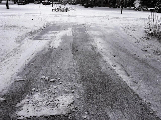

Ed Kennell 44,667 #22 Posted November 29, 2025 May be this will help. When I set up a new blower, I park the tractor on a flat surface. With the blower down and the flag installed in the top hole and the lift lever or hdro lift lowered. Hook the lift pipe to the blower lug and hold it beside the lift flag rod. Then you can determine the amount you must remove or add to the lift pipe. If I need to shorten the pipe, I always cut it 1/8" short and plan to add two 1/16" washers so I have some adjustment. Note, it is not necessary to remove the flag when making the adjustment by adding or removing washers. You can disconnect the pipe at the blower and install the pipe on the flag while it is in place. 1 Share this post Link to post Share on other sites
jsp_333 286 #23 Posted December 10, 2025 UPDATE; Got about 6 inches of heavy wet snow today and so far blower is scraping the driveway down to the asphalt. So thanks all 3 Share this post Link to post Share on other sites
