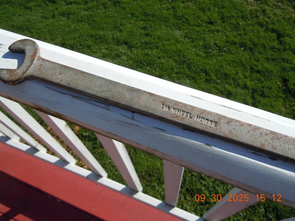

Wayne0 1,632 #1 Posted November 26, 2025 Found this browsing CL. Never seen one. 2 1 Share this post Link to post Share on other sites
ebinmaine 80,471 #2 Posted November 26, 2025 Spindle wrench. I've read about them here. But I don't want to call ever seeing one in person. No need either. We don't mow with tractors. 1 Share this post Link to post Share on other sites

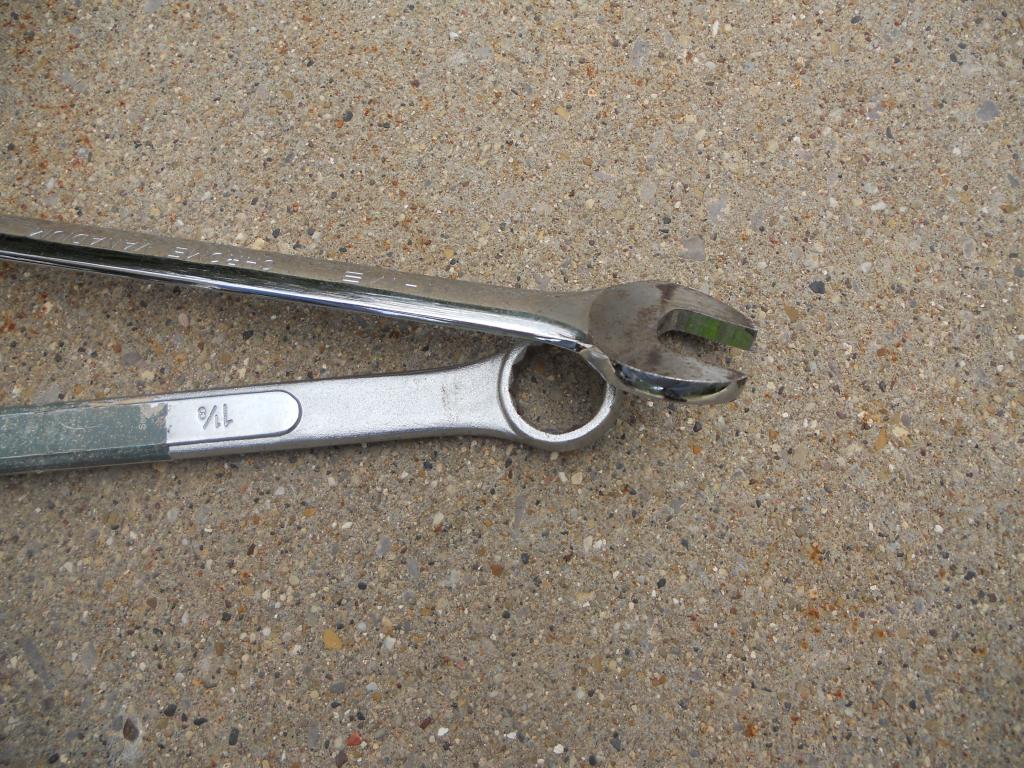

ri702bill 12,930 #3 Posted November 26, 2025 Yup - some of the newer ones for sale are cast. Nope... I have not had an issue with the 1-1/8" nut; the difficult one is the 15/16 flats on the spindle. I bought a "yard sale" one and thinned the width to fit. That works. 2 Share this post Link to post Share on other sites
stevasaurus 23,816 #4 Posted November 26, 2025 If you search "Wheel Horse wrench" a number of threads will come up. Here is a good one... 2 Share this post Link to post Share on other sites
JoeM 10,207 #5 Posted November 26, 2025 That wrench is used to hold the spindle hex between the blade and spindle. It is long enough to catch the side of the deck so the nut can be loosened that holds the blade. Some have tried to use it to tighten the nut and doesn't work good for that application, just to hold the shaft from turning. 2 Share this post Link to post Share on other sites

953 nut 68,890 #7 Posted November 26, 2025 Much like @ri702bill I took one of my 1 1/8' combination wrenches and cut it down with a port-a-band just enough to slip into the space above the blade. 3 Share this post Link to post Share on other sites

Racinbob 13,122 #9 Posted November 27, 2025 I've had a few of those through the years. Actually they are more of a wall hanger. I have a Reese saved from our RV'ing years and milled down another one to get to the top nut. 3 Share this post Link to post Share on other sites
