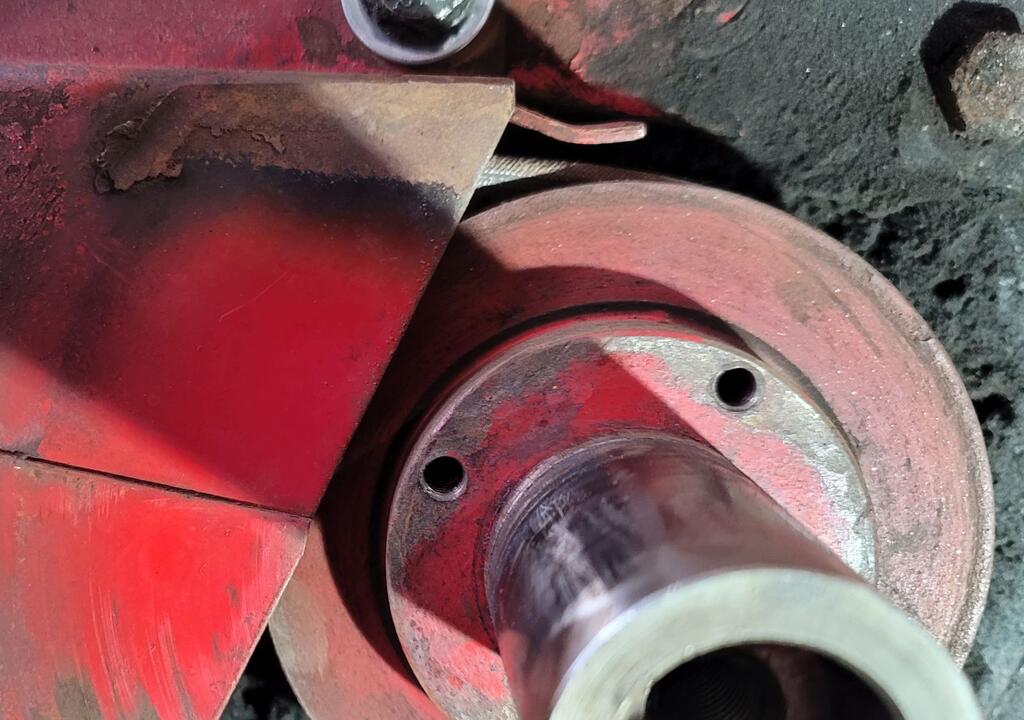

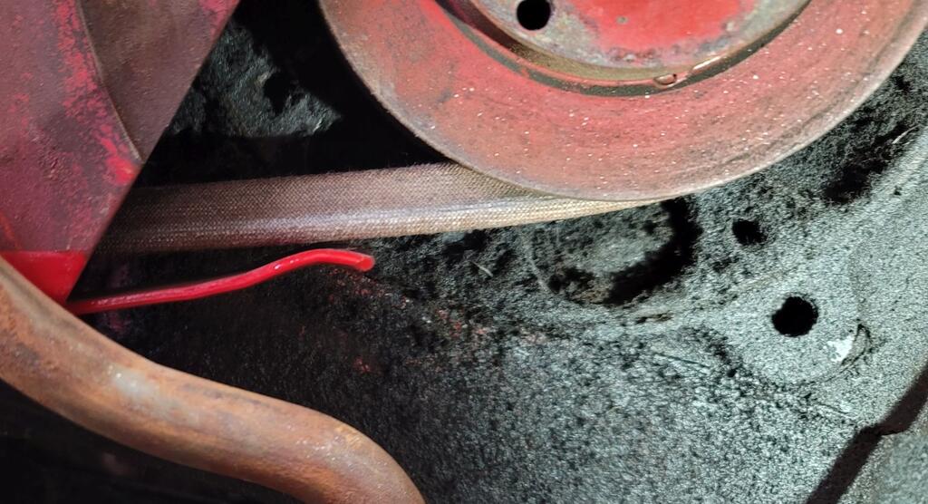

BradKahler 407 #101 Posted December 15, 2025 1 hour ago, Handy Don said: Brad you are making great progress! To my eye, and agreeing with your assessment, it looks more like the belt guard is mounted a bit higher than I'd expect which makes that gap to the guide bigger. Once you have the top tab where you want it and correctly spaced, then gently bending the bottom will get you home. And yes, in the interest of having the drive belt stop promptly when the clutch is fully disengaged, the close gaps are important. Thanks for the info. Your comment about the belt guard position, reminded me about the mounting hole in the top bracket. It has been enlarged and I'm not sure why. I think I'll take a closer look to see what's going on there. I do know the bolt in the middle bottom line up without issue as did the two at the top rear. Only the front hole had issues. Also, does the belt look a little loose? The clutch is not pushed in so I would think the belt would be a bit tighter. I'll remove the guard and take another picture. Thanks. Share this post Link to post Share on other sites

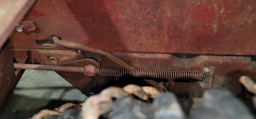

Handy Don 17,475 #102 Posted December 15, 2025 (edited) On 12/15/2025 at 1:58 PM, BradKahler said: Also, does the belt look a little loose? The clutch is not pushed in so I would think the belt would be a bit tighter. I'll remove the guard and take another picture. I thought you got the picture with the clutch disengaged! Definitely loose. The belt in the manual picture show the belt nicely snug. The trick is to have the clutch/idler arm still be tilted forward some when the clutch is fully engaged. If the arm is too vertical, then it cannot keep the belt taut. Some members have reported weakened or over-stretched clutch tensioner springs, so that’s something to keep in mind as well. The larger hp WHs that I’ve seen use ⅝” drive belts and I’m sure you already know that belts wear on their sides and hence over time ride deeper in the pulleys, creating the erroneous impression the belt has “stretched." Edited December 19, 2025 by Handy Don Share this post Link to post Share on other sites
BradKahler 407 #103 Posted December 19, 2025 On 12/15/2025 at 5:33 PM, Handy Don said: I thought you got the picture with the clutch disengaged! Definitely loose. The belt in the manual picture show the belt nicely snug. The trick is to have the clutch/idler arm still be tilted forward some when the clutch is disengaged. If the arm is too vertical, then it cannot keep the belt taut. This is what mine looks like with the clutch pedal at rest (not pushed). On 12/15/2025 at 5:33 PM, Handy Don said: Some members have reported weakened or over-stretched clutch tensioner springs, so that’s something to keep in mind as well. The larger hp WHs that I’ve seen use ⅝” drive belts and I’m sure you already know that belts wear on their sides and hence over time ride deeper in the pulleys, creating the erroneous impression the belt has “stretched." I'm almost certain the belt is worn. I took it for a drive up and down my driveway this morning and it slips in 2nd and 3rd and maybe a little bit in 1st gear. When in 2nd or 3rd, a slight incline will cause it to slip. I ordered a Toro brand replacement belt last night and should have it before the end of the year. I don't plan on adjusting the belt guard guides until the new belt is installed. Share this post Link to post Share on other sites

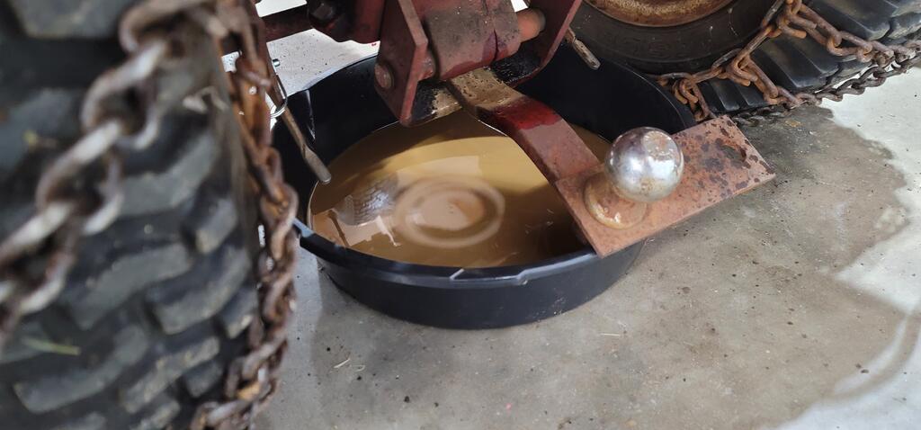

BradKahler 407 #104 Posted December 19, 2025 Yesterday I finished up the electrical wiring and this morning I took it out for a test drive, mainly to circulate the diesel fuel that is currently in the gearbox. Right now the diesel is being drained (drip drying!) and then I refill with diesel again and go for another drive. The diesel is dirty but doesn't seem to have any debris of any kind mixed in it. I'm hoping one more run with diesel will be enough. Getting the last bit of diesel out While replacing all the wiring I went ahead and re-installed the old regulator along with a ground wire from the battery to one of the mounting screws. The regulator does work. The only odd thing I noted was as I brought the engine down to idle, the needle started bouncing back and forth rapidly. I slowly brought the idle back up and I could got it to stop bouncing, however the idle speed was a little higher than I would like. Is this a normal situation or does that mean only half of the regulator is working? 2 1 Share this post Link to post Share on other sites

Handy Don 17,475 #106 Posted December 19, 2025 Progress! 37 minutes ago, BradKahler said: This is what mine looks like with the clutch pedal at rest (not pushed). I see that the spring hasn’t got a lot of tension--the arm is tilted rearward pretty far. The pulley (on the other end) is likely nearly at the top of its arm’s swing. Plus belt slipping under load. I don’t see anything mechanically damaged. Correct new belt ought to solve all. 32 minutes ago, BradKahler said: The diesel is dirty The mocha coloring is likely mostly from water/moisture. Not surprising. All but impossible to completely eliminate without opening the transaxle. Once filled with the appropriate gear oil, trace residual amounts in the transaxle are inconsequential. Please be environmentally conscious when disposing the drained diesel. 35 minutes ago, BradKahler said: needle started bouncing back and forth rapidly Hooray that you won’t need a new VR. When the stator’s output voltage at low RPM (going into the VR) is close to the same as the battery’s already stored voltage, the VR can “flutter” back and forth between trying and not trying to continue sending charging current to the battery. Normal. As @pfrederi noted, the recommended idle speed (check the manual for your engine) is often higher than many folks realize. I set my K181 to 1100 RPM using a free optical tachometer app on my phone (it’ll idle as low as 500 RPM, and sound cool doing it, but NOT recommended). 2 Share this post Link to post Share on other sites
sqrlgtr 3,950 #107 Posted December 19, 2025 1 hour ago, Handy Don said: As @pfrederi noted, the recommended idle speed (check the manual for your engine) is often higher than many folks realize. I set my K181 to 1100 RPM using a free optical tachometer app on my phone (it’ll idle as low as 500 RPM, and sound cool doing it, but NOT recommended). Very good advice here, remember thes are aircooled and need the rpms at idle to stay cool . 2 Share this post Link to post Share on other sites
BradKahler 407 #108 Posted December 20, 2025 19 hours ago, Handy Don said: Progress! I see that the spring hasn’t got a lot of tension--the arm is tilted rearward pretty far. The pulley (on the other end) is likely nearly at the top of its arm’s swing. Plus belt slipping under load. I don’t see anything mechanically damaged. Correct new belt ought to solve all. I was wondering about the spring. Once the new belt is installed, if there are still issues I'll replace the spring. 19 hours ago, Handy Don said: The mocha coloring is likely mostly from water/moisture. Not surprising. All but impossible to completely eliminate without opening the transaxle. Once filled with the appropriate gear oil, trace residual amounts in the transaxle are inconsequential. Please be environmentally conscious when disposing the drained diesel. The second draining of the diesel was much better. It was still brownish but the diesel odder was still extremely strong, unlike the first go round. Yeah, I recycle all used fluids. Once a year the county has a free drop off day. 19 hours ago, Handy Don said: Hooray that you won’t need a new VR. When the stator’s output voltage at low RPM (going into the VR) is close to the same as the battery’s already stored voltage, the VR can “flutter” back and forth between trying and not trying to continue sending charging current to the battery. Normal. As @pfrederi noted, the recommended idle speed (check the manual for your engine) is often higher than many folks realize. I set my K181 to 1100 RPM using a free optical tachometer app on my phone (it’ll idle as low as 500 RPM, and sound cool doing it, but NOT recommended). I have a digital tach (somewhere!) that I'll use to set the idle. For the time being I bumped up the idle to stop the fluttering. Thanks! Share this post Link to post Share on other sites

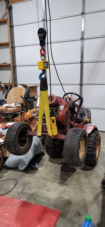

BradKahler 407 #109 Posted December 20, 2025 This afternoon I started filling the gearbox with 80-90 gear oil. It took exactly 1-quart and started to overflow the filler port. When I drained the fluids, I elevated the front of the tractor to about 40 degrees or so and let it set that way overnight. I'm having a hard time there was still 1/2 quart of fluid in there somewhere. I was expecting to be able to add 1-1/2 quarts. What if anything did I do wrong? Share this post Link to post Share on other sites
702854boy 1,150 #110 Posted December 20, 2025 You didn't do anything wrong, Wheel Horse just designed these trannys to hold less than what we think they need so a lot of guys just take the shifter or one of the seat bolts out to fill them up with 1 1/2 to 2 quarts of oil instead of just the one. 5 Share this post Link to post Share on other sites
BradKahler 407 #111 Posted December 20, 2025 20 minutes ago, 702854boy said: You didn't do anything wrong, Wheel Horse just designed these trannys to hold less than what we think they need so a lot of guys just take the shifter or one of the seat bolts out to fill them up with 1 1/2 to 2 quarts of oil instead of just the one. Well, since I bought two quarts, I might as well add the extra 1/2 quart. Thanks 1 Share this post Link to post Share on other sites
sqrlgtr 3,950 #112 Posted December 21, 2025 46 minutes ago, BradKahler said: Well, since I bought two quarts, I might as well add the extra 1/2 quart. Thanks I find easier going through the shifter hole myself, of course you risk breaking the shifter set screw if it hasn't ever been removed or has been years since removal . I would rather be a tad to low as overfilled myself just my . 1 Share this post Link to post Share on other sites
BradKahler 407 #113 Posted December 23, 2025 The new drive belt came in yesterday and it's now installed. I adjusted the belt guides as shown in the pictures below and went for a test drive, it's like a totally different machine now. When I push in the clutch the belts stops turning almost immediately and there is no belt movement until I put it in gear and release the clutch. The left front tire wouldn't hold air so I replaced the inner tube so the tractor is now a working, usable machine. Later this week I'll put the dozer blade back on and see what I can do about the quadrant arm where it interferes with the brake pedal. The engine smokes a little on startup but clears up after a few minutes. I'm hoping that issue clears itself up as I start using it more regularly. 2 2 Share this post Link to post Share on other sites
Handy Don 17,475 #114 Posted December 23, 2025 2 hours ago, BradKahler said: the tractor is now a working, usable machine Ain't it a treat when it just works? My neighbors never really noticed when I was mowing the lawn with the WH, but boy they have REALLY noticed what it can do with wet sticky snow that is too heavy for easy shovel and seems to quickly jams the two-stage snow blowers. 2 1 Share this post Link to post Share on other sites

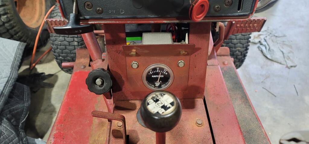

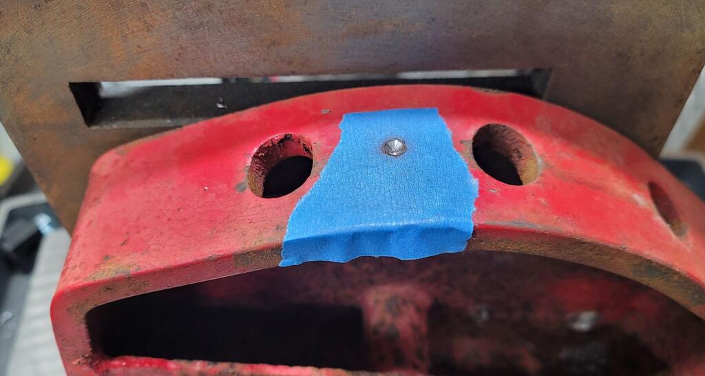

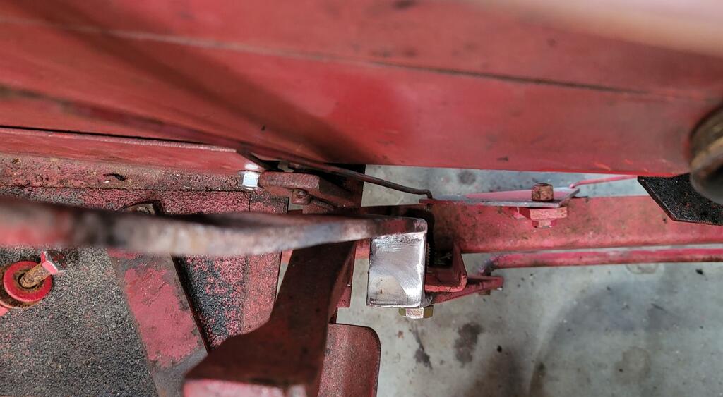

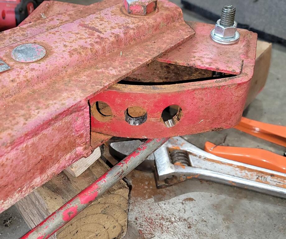

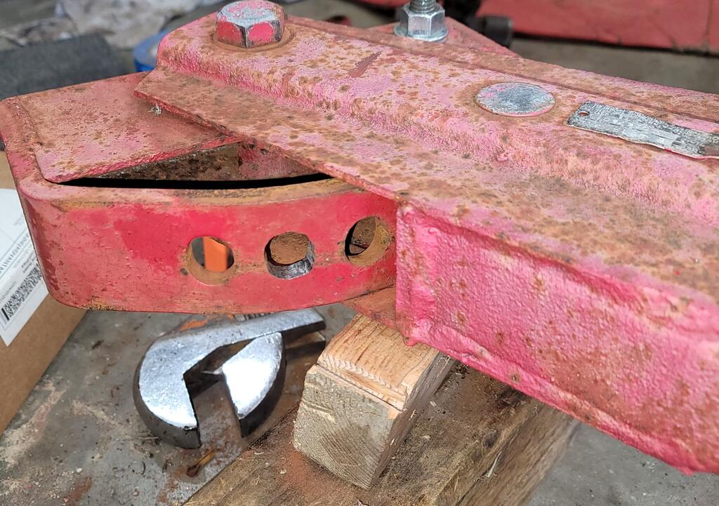

BradKahler 407 #120 Posted December 27, 2025 I spent some time the last couple of days installing the dozer blade. I needed to rework the quadrant control lever, add a couple of extra holes in the quadrant, and modify the quadrant control rod for easier installation and removal. I ran across this thread where PA Horseman appears to have made a change to the quadrant control rod that allowed for easy access to the hair pin. The only 1/2" diameter rod I had laying around was a long 1/2" bolt so I opted to leave the threads and just use a nut to hold it in place. When its all done I will use a nyloc nut to keep it in place. The two extra holes in the quadrant came out ok. I didn't like the grinding job I did to enlarge the holes a little but it is what it is. It works, that's all I care about. Here's the mod I made to the quadrant control lever. Everything seems to work, but it does take a strong grip to get the pin to retract. Is the pin supposed to be greased or is there some other way to make the operation a little smoother? 4 Share this post Link to post Share on other sites
sqrlgtr 3,950 #121 Posted December 27, 2025 (edited) Looks good to me and a little grease sure want hurt any thing. I really know don't how the push/pull rod is fastened on yours, but I went with Heim joints front and back on mine and I never unhook rod from plow end just on lever end. You will like the extra holes. Edited December 27, 2025 by sqrlgtr 1 Share this post Link to post Share on other sites
BradKahler 407 #122 Posted December 27, 2025 4 minutes ago, sqrlgtr said: Looks good to me and a little grease sure want hurt any thing. I really know how the push pull rod is fastened on yours but I went with Heim joints front and back on mine and I never unhook rod from plow end just on lever end. You will like the extra holes. Heim joints sound like a pretty decent idea. There is a lot of slop in the original configuration. Using the nut like I did doesn't do anything for the slop, it just makes removing the rod a lot easier. Originally you had to access the inside of the quadrant to remove a pin before you could remove the rod. A real pain in the..... 1 Share this post Link to post Share on other sites
sqrlgtr 3,950 #123 Posted December 27, 2025 5 minutes ago, BradKahler said: Heim joints sound like a pretty decent idea. There is a lot of slop in the original configuration. Using the nut like I did doesn't do anything for the slop, it just makes removing the rod a lot easier. Originally you had to access the inside of the quadrant to remove a pin before you could remove the rod. A real pain in the..... yeah they can be hard to get to. The last one I fooled with had a hair pin in it and somehow got bent almost around in a circle and I like to have never got it out. I finally just took blade off and turned it upside down for easier access, just the one pivot bolt holding it on. I put Heim joints on it. 1 Share this post Link to post Share on other sites
BradKahler 407 #124 Posted December 27, 2025 7 minutes ago, sqrlgtr said: yeah they can be hard to get to. The last one I fooled with had a hair pin in it and somehow got bent almost around in a circle and I like to have never got it out. I finally just took blade off and turned it upside down for easier access, just the one pivot bolt holding it on. I put Heim joints on it. Yep, that's what I did. I took the blade off and turned the frame upside down. Still had to fight it because they used a cotter pin which was frozen in place. I might try the heim joint on my other blade. No one said I had to keep both dozer blades the same Share this post Link to post Share on other sites
sqrlgtr 3,950 #125 Posted December 28, 2025 I went to local getting place and got 1/2" round stock and made it out of it and put original rod on another plow that had rod missing. Used the one with the Heim joints on the plow that I planned on using the most. I cut the threads on a lathe but don't see why you couldn't use a good die to do it, also made it just a hair shorter to place lever closer to operator. Made my threads 1/2-20 but that's what the Heim joint thread is that I had. 1 1 Share this post Link to post Share on other sites
