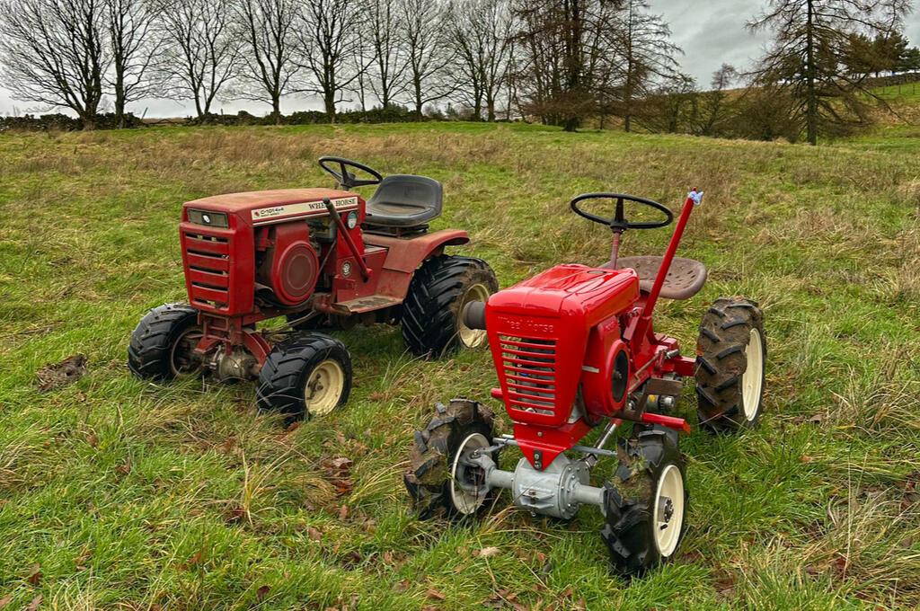

meadowfield 3,210 #33 Posted December 9, 2025 Well it lives! I left Ewan with an axle bolted on, he’s done the clutch and got it running. next step will be a test drive. Might be a run out with C4 and some extreme testing 6C4FCCBD-20EA-45AD-BE02-F5A70638B51A.mov 1 3 2 Share this post Link to post Share on other sites

meadowfield 3,210 #38 Posted December 10, 2025 16 hours ago, Pullstart said: @meadowfield Mark did you guys cast those weights? Weights are copies of the weights shipped here, a friend of ours Shaun made moulds for all the weights and then had a ton of them cast from the old brake discs and drums he's stockpiled for years. They do look really good! 2 1 2 Share this post Link to post Share on other sites
meadowfield 3,210 #39 Posted December 10, 2025 (edited) Heres a set painted in the summer Edited December 10, 2025 by meadowfield 2 4 2 Share this post Link to post Share on other sites

meadowfield 3,210 #46 Posted December 14, 2025 Well it lives and runs 1 4 Share this post Link to post Share on other sites
Handy Don 17,735 #47 Posted December 14, 2025 2 hours ago, meadowfield said: Well it lives and runs I get that there are separate differentials for the front and rear axles, but how did your son solve the front-rear differential? Frankly, it’s the complication this introduces that would make me opt for a motor-generator and either axle or wheel electric motors! Share this post Link to post Share on other sites
meadowfield 3,210 #48 Posted December 14, 2025 (edited) 1 hour ago, Handy Don said: I get that there are separate differentials for the front and rear axles, but how did your son solve the front-rear differential? Frankly, it’s the complication this introduces that would make me opt for a motor-generator and either axle or wheel electric motors! he didn’t solve it, I did…. the rear ratio is 12:28 The front was 8.6:1. but because the front tyres are smaller that makes the interaxle ratio 0.89:1 so I made that using a 20/23 sprocket ratio. This is our third 4x4 wheel horse, so it’s getting easier each time. Edited December 14, 2025 by meadowfield 2 1 Share this post Link to post Share on other sites
meadowfield 3,210 #49 Posted December 14, 2025 Here’s the test drive 1 6 Share this post Link to post Share on other sites
