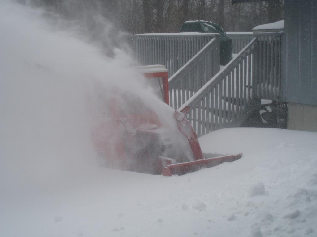

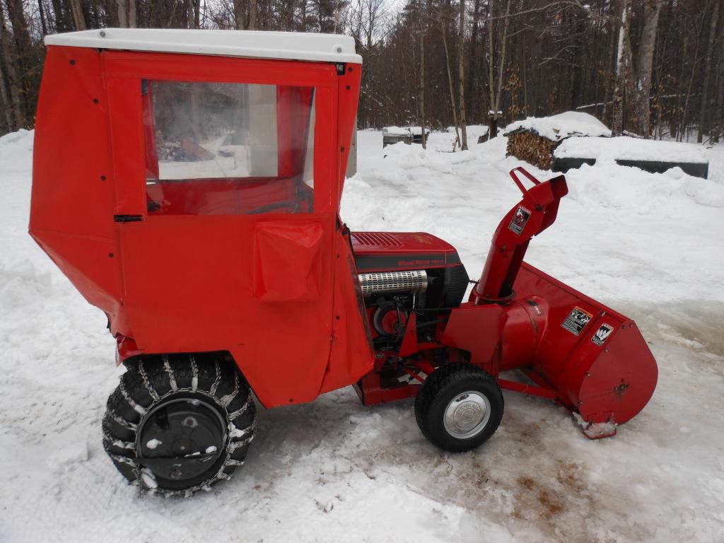

JCM 11,419 #4 Posted November 24, 2025 1991 520-H with 44'' 2 stage # 79361 Share this post Link to post Share on other sites
