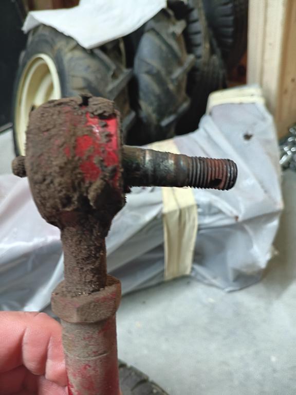

wallfish 19,533 #2 Posted November 22, 2025 (edited) Yeah, here's what they look like Those tie rods don't go in on a locking tapered fit like automotive ball joints do. Loosen the nut to the end of the threads (to protect them) and hit it with a hammer to knock it through the hole if it's rusted together. If the nut is locked on the threads and it's just spinning, try twisting the rod by the locking nut with a wrench which will add friction to the joint. Edited November 22, 2025 by wallfish 6 1 2 1 Share this post Link to post Share on other sites

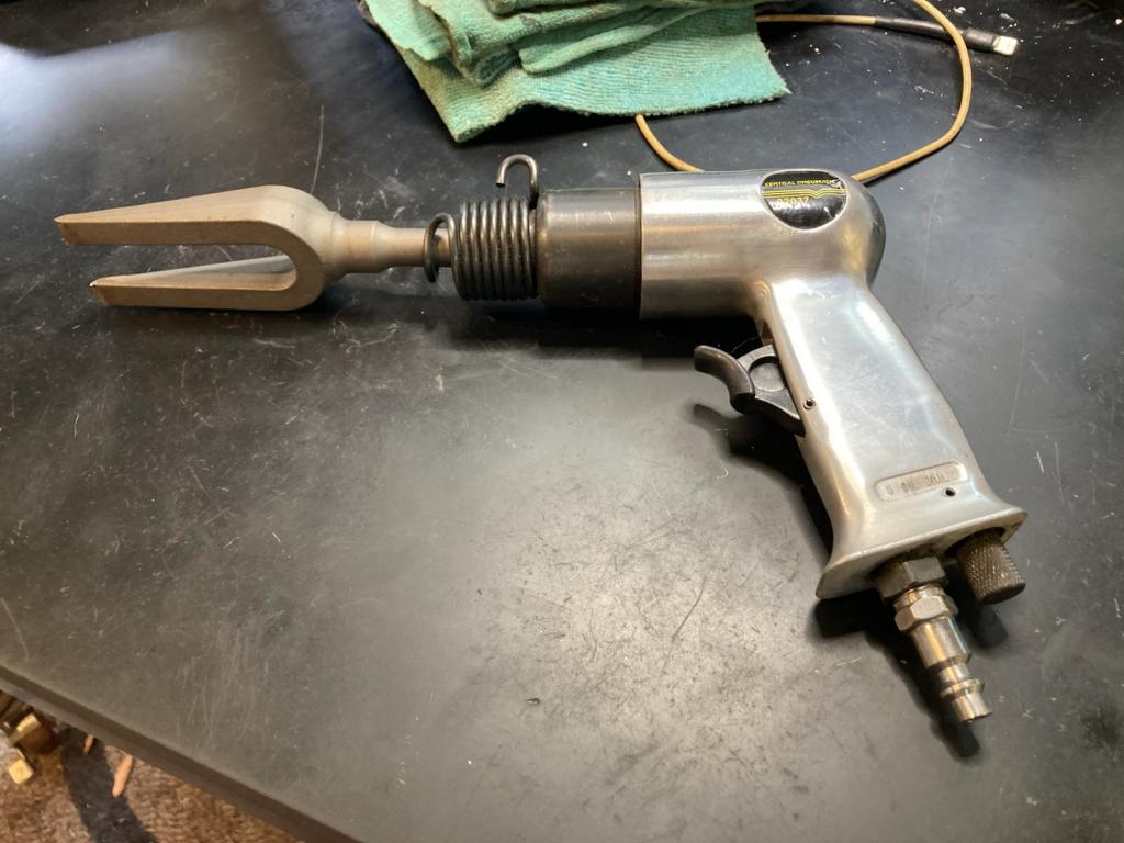

ineedanother 1,992 #4 Posted November 22, 2025 50 minutes ago, ebinmaine said: Is there a home shop made or alternative tool to a small pickle fork? I subscribe to @wallfish 's solution as well but try this first. This was inexpensive at HF and I use it for more than ball joints. 3 2 1 Share this post Link to post Share on other sites

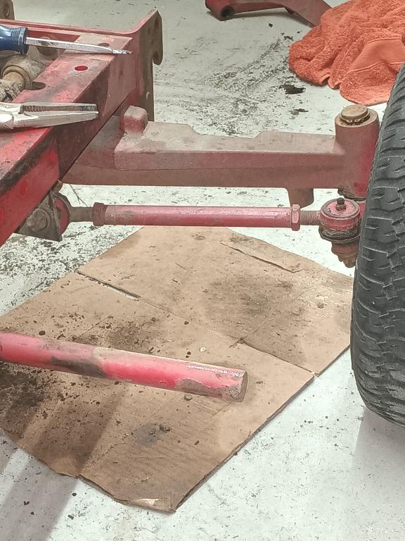

ebinmaine 77,973 #5 Posted November 22, 2025 23 minutes ago, wallfish said: Yeah, here's what they look like Those tie rods don't go in on a locking tapered fit like automotive ball joints do. Loosen the nut to the end of the threads (to protect them) and hit it with a hammer to knock it through the hole if it's rusted together. If the nut is locked on the threads and it's just spinning, try twisting the rod by the locking nut with a wrench which will add friction to the joint. Turns out in my case the rod itself is freed up but the castle nut is frozen onto the threads... Share this post Link to post Share on other sites

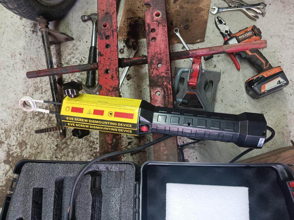

ebinmaine 77,973 #6 Posted November 22, 2025 GOT EM!! I used my induction heater I picked up a few months ago. 5 4 Share this post Link to post Share on other sites

ebinmaine 77,973 #14 Posted November 22, 2025 1 hour ago, 8ntruck said: Cool! Details, please? That looks like it could be a real help with rust welded pieces parts. Maybe help with assembly and disassembly of press fit parts, too. See the loops? That's a copper (?) coil wrapped in heat resistant cloth. I have only 3 coils. There are many versions. You find the coil of rhe smallest diameter that doesn't make contact with the heated item. Press the button on the tool. Wait 60 to 80 seconds and the heated item is a nice cherry red. Attempt removal. Lather. Rinse. Repeat. I had to heat each side twice. 4 1 Share this post Link to post Share on other sites

adsm08 4,293 #16 Posted November 23, 2025 8 hours ago, ri702bill said: the fork can fly out Look into getting a quick-release chuck instead of that spring retainer chuck. Makes them a lot less dangerous. 3 Share this post Link to post Share on other sites

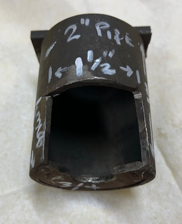

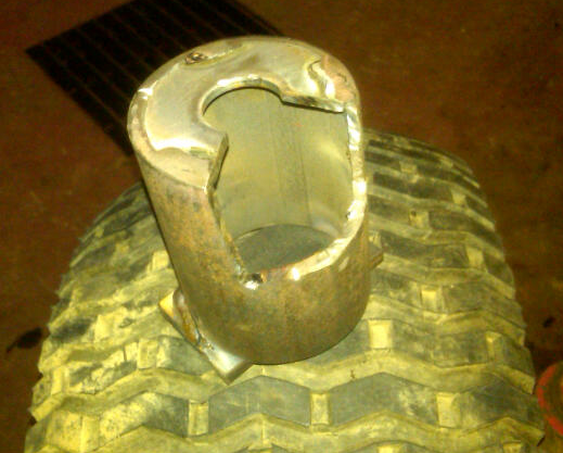

JoeM 9,709 #17 Posted November 23, 2025 (edited) Here you go EB added the dimensions 2 inch pipe 3 inches long the washer is 3/4 Edited November 23, 2025 by JoeM 2 3 Share this post Link to post Share on other sites

ebinmaine 77,973 #20 Posted November 23, 2025 11 hours ago, adsm08 said: One of the best tools I ever bought. I can see that. I'm my case there's no availability of a decent torch set and using the small bottles is VERY expensive. This heater has been extremely handy for the couple occasions I've remembered to use it. @Joe M niiiiice. 1 1 Share this post Link to post Share on other sites
cleat 8,867 #21 Posted November 23, 2025 I have never had one put up too big a fight (yet). A lot of time the cotter key is the hardest to get out. I just use an impact to remove the nut then flip it over and screw it back on most of the way until the tie rod stud is flush to the end of the nut. Then one or two good nice even (so as not to bend anything) whacks with a hammer (I use a brass hammer for this) and the tie rod should pop free. Hopefully at this time you can just unscrew the nut. Holding the tie rod in as tight as possible while spinning the nut off with an impact should do it. 1 1 Share this post Link to post Share on other sites

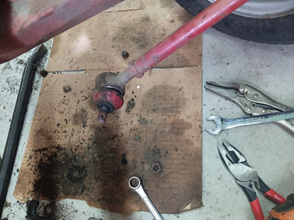

ebinmaine 77,973 #22 Posted November 23, 2025 1 minute ago, cleat said: Holding the tie rod in as tight as possible while spinning the nut off with an impact should do it. This is where our issue was. This particular tractor was living outside. Some areas were rusted. Others spotless. On this task the rusted part was the nut & thread. The spotless part was the plain stud. The stud popped right out leaving us with no way to hold the rest from spinning. After a soak with penetrant and a super heating it decided to free up. Share this post Link to post Share on other sites

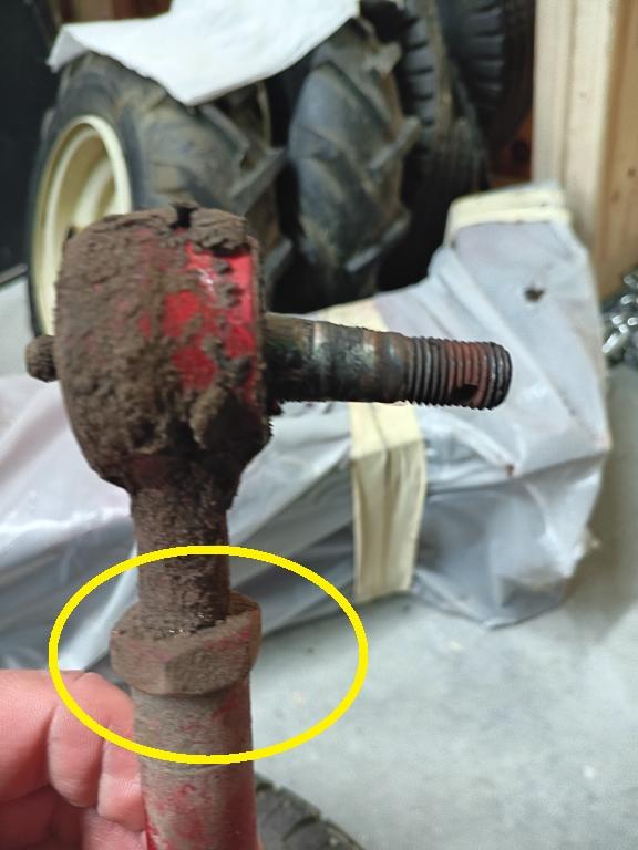

wallfish 19,533 #23 Posted November 23, 2025 23 hours ago, wallfish said: If the nut is locked on the threads and it's just spinning, try twisting the rod by the locking nut with a wrench which will add friction to the joint. Share this post Link to post Share on other sites
ebinmaine 77,973 #24 Posted November 23, 2025 4 minutes ago, wallfish said: try twisting the rod by the locking nut with a wrench which will add friction to the joint. I saw that post earlier but I don't see any way to grab anything on these other than the nut that is already frozen on the threads. The thread shaft is round from top to bottom. Share this post Link to post Share on other sites
wallfish 19,533 #25 Posted November 23, 2025 (edited) Twist this nut with a wrench to crate friction in the joint so the stud has resistance and the nut will come off Edited November 23, 2025 by wallfish 2 1 Share this post Link to post Share on other sites
