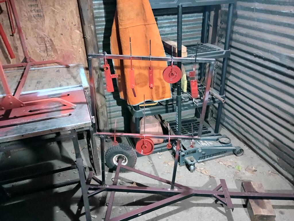

Chrishar 1,035 #30 Posted January 3 Painted more parts today 2 1 Share this post Link to post Share on other sites

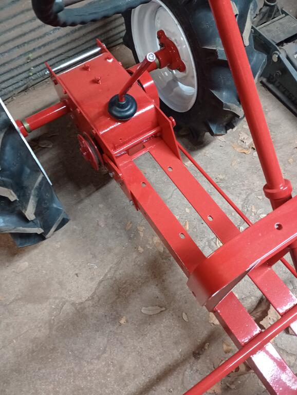

Chrishar 1,035 #31 Posted January 9 Had I little time to put more pieces on brake band and pulley the transmission drive pulley and the clutch lever assembly on 2 3 Share this post Link to post Share on other sites

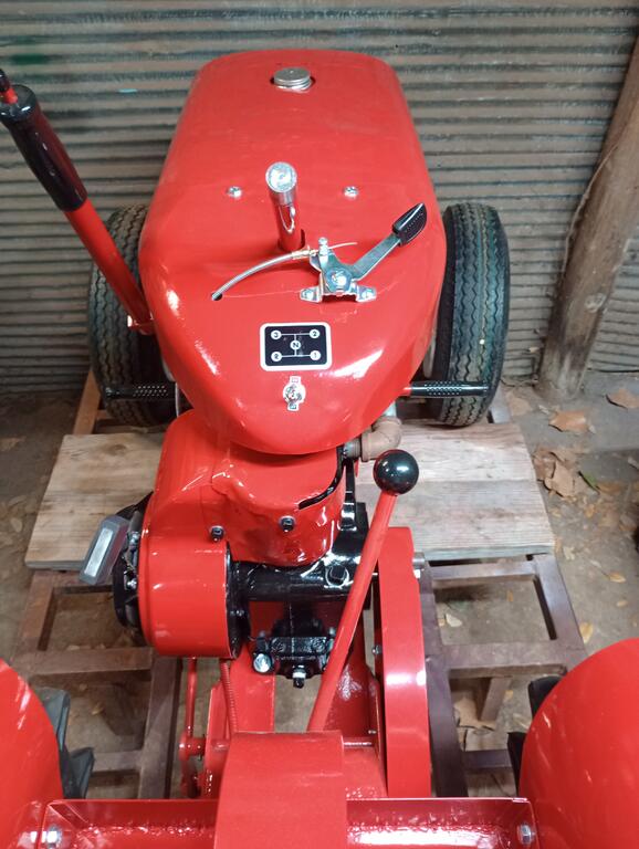

Chrishar 1,035 #32 Posted January 12 the left handle and the clutch pedal are on and add rubber pieces were your feet set next thing is getting the engine together and on the frame and the fenders and the pan painted gas tank mounted on the hood and both of them painted too a lot of work to go still 2 7 Share this post Link to post Share on other sites

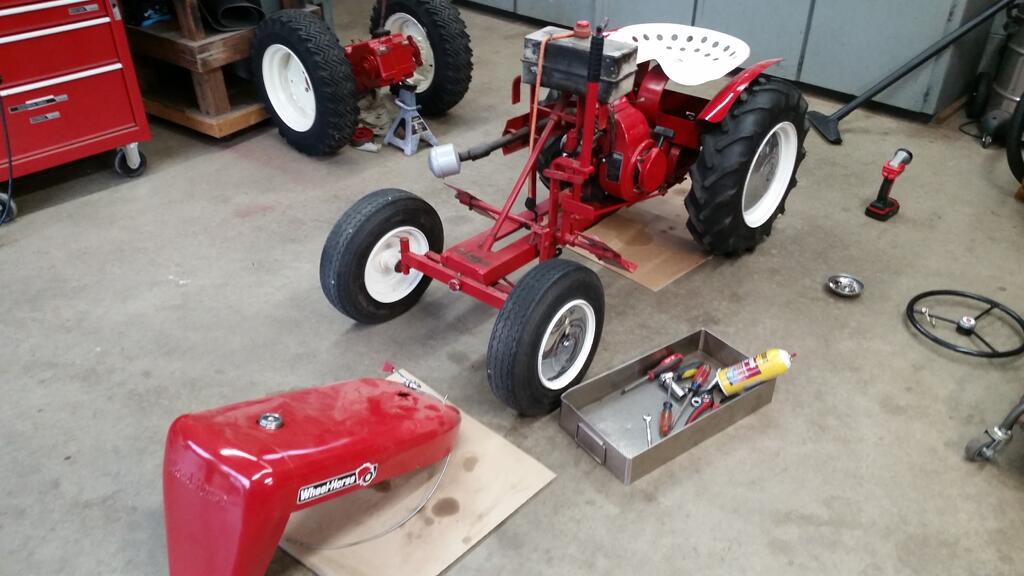

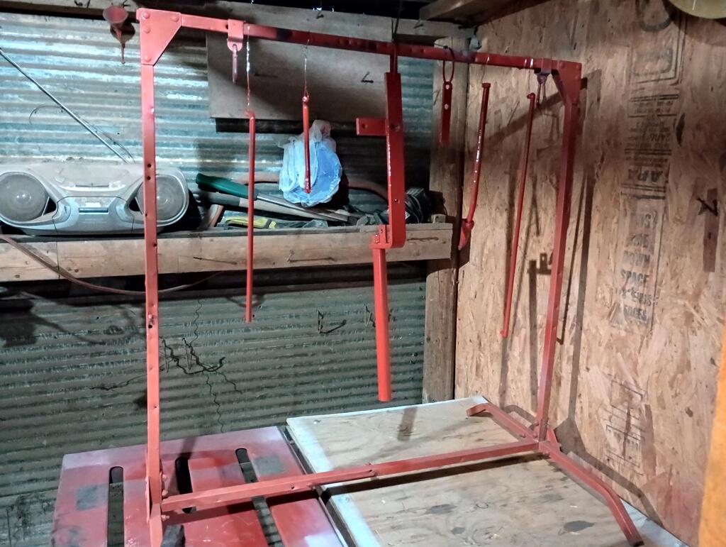

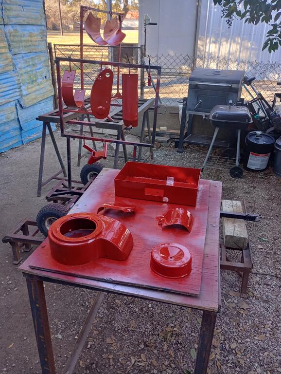

Chrishar 1,035 #34 Posted February 7 Finally had time to work on RJ the last two days got some pieces painted 5 4 Share this post Link to post Share on other sites

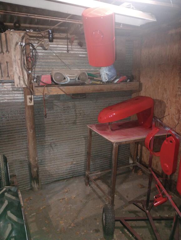

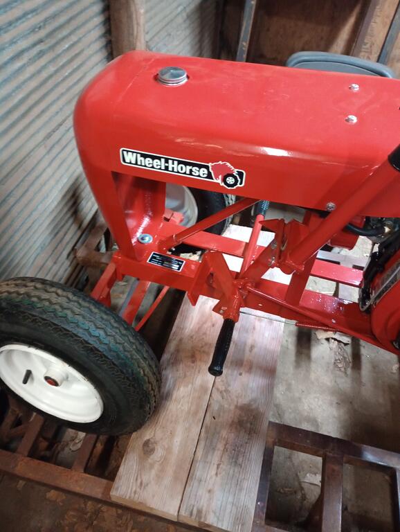

Chrishar 1,035 #35 Posted February 10 Hood and gas tank painted 5 3 Share this post Link to post Share on other sites

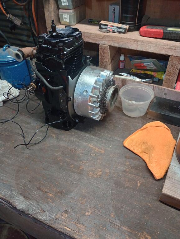

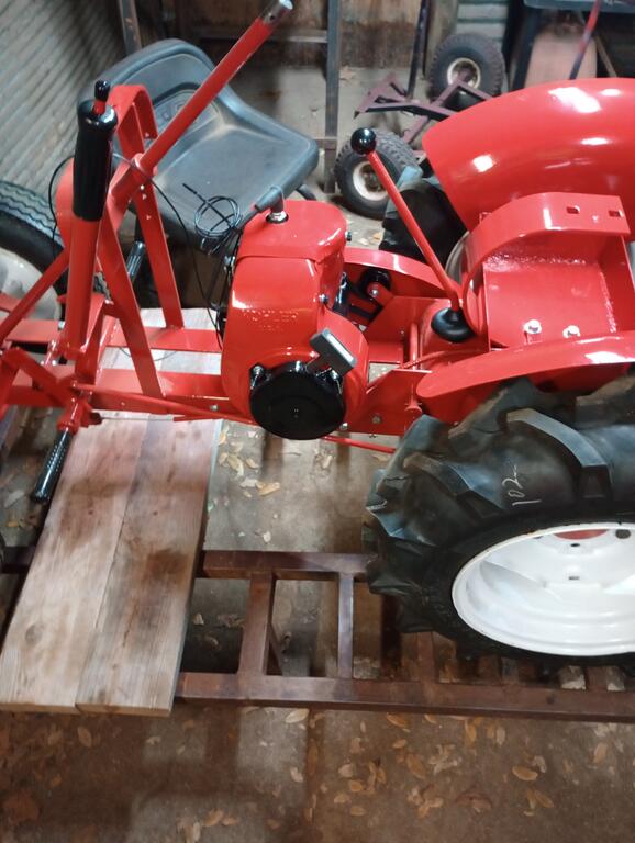

Chrishar 1,035 #36 Posted February 11 Put some parts on the RJ and ING coil and flywheel on motor tonight 6 Share this post Link to post Share on other sites

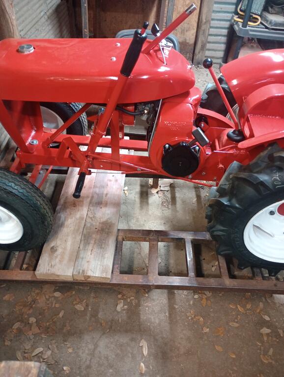

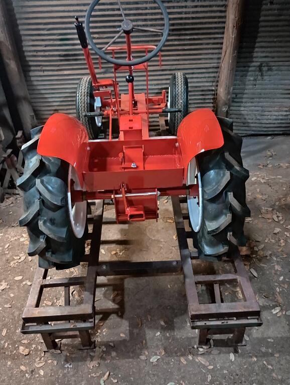

Chrishar 1,035 #38 Posted February 13 Did a little bit more tonight to it 2 6 Share this post Link to post Share on other sites

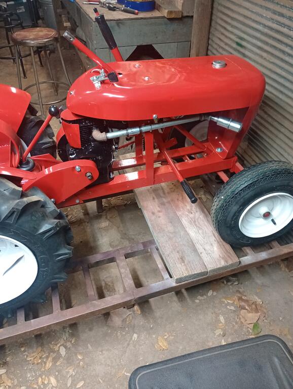

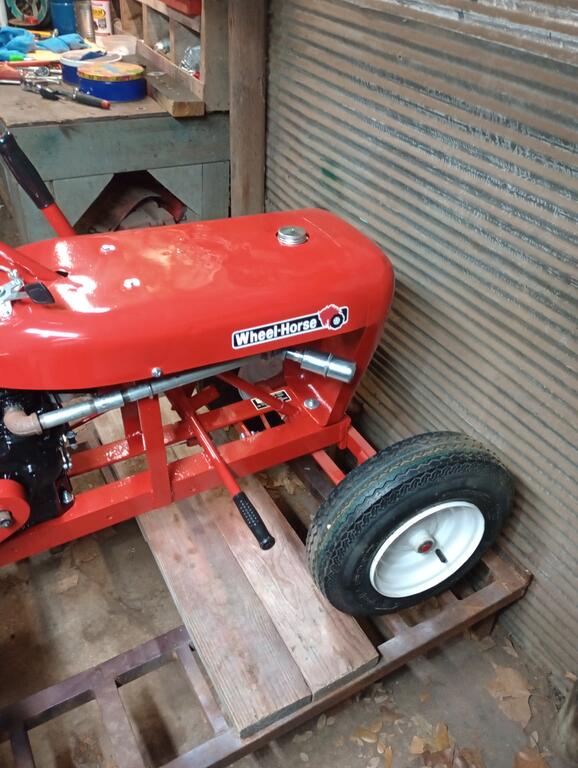

Chrishar 1,035 #42 Posted February 14 The hood gas tank and carburetor are on coming together little at a time 1 6 Share this post Link to post Share on other sites

wallfish 20,375 #44 Posted February 14 On 2/11/2026 at 12:20 AM, Chrishar said: Does anybody have a picture of the drive belt system just want to make sure I'm not missing anything like a metal tab to help with the belt tension on the motor There are no metal tabs or anything, just the belt guard. The idler pulley pushes down from the outside of the belt on an RJ for the belt tension. Raises up to release by the pedal. Some can be difficult to get the belt to slip clutch on the engine pulley and especially with a brand new belt. Fine tweaking and adjustments of the engine mounting bolts should get you there. But that's something to address once the engine is fired up. Sometimes it just works as should right off the bat. 3 Share this post Link to post Share on other sites

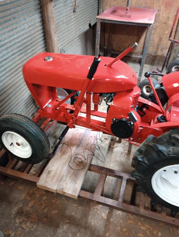

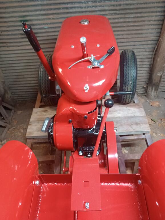

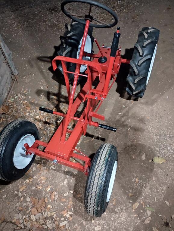

Chrishar 1,035 #47 Posted February 17 Got a lot done today on the RJ should be ready to run it 2 6 1 Share this post Link to post Share on other sites
wallfish 20,375 #48 Posted February 17 That thing looks beautiful. Nice job The other thing with the belt slip clutching adjustment if you have an issue is you could use 5/16" bolts for the engine mounting instead of 3/8" fasteners. That allows just a little more play in the holes for adjustments. There's a little bit of belt guard adjustment within the mounting holes for that too. Hopefully it turns out to be an easy one. 3/4 pedal clutch slipping a new belt will help to remove the belt memory from packaging and glaze the edges of the belt that contact the pulleys. I'd recommend doing that in reverse against a wall or something. An RJ or Suburban can climb the wall in forward! Guess how I found that out? LOL 2 Share this post Link to post Share on other sites
Chrishar 1,035 #49 Posted February 18 Put the decals on tonight 3 2 Share this post Link to post Share on other sites
