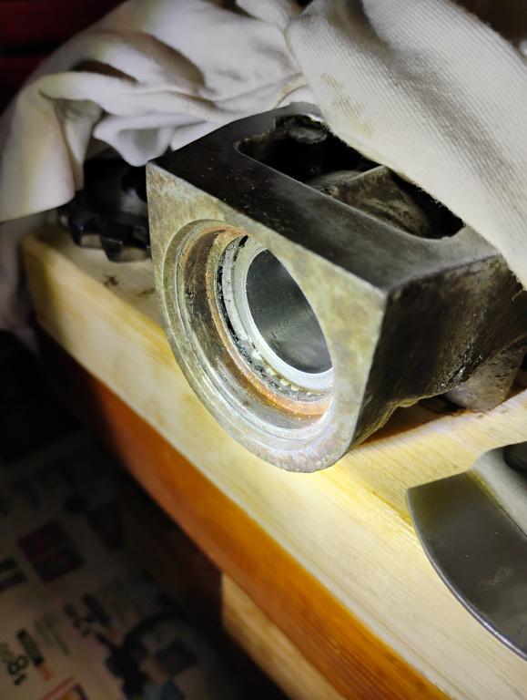

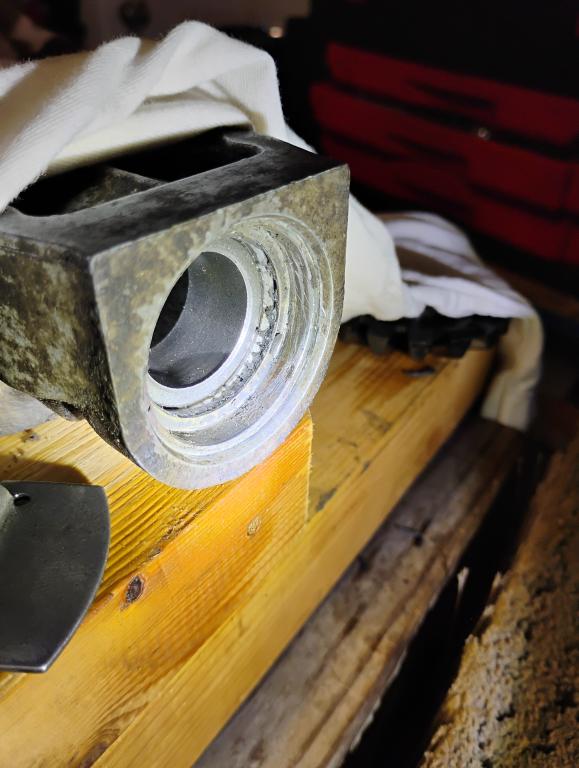

Ron L 1 #1 Posted November 21, 2025 Hi All, I have a 265-H with a K61 transmission that I picked up to either fix and resell or keep myself. Both axle seals need to be replaced. I know I didn't need to pull the cover and axles out to do this, but it was easier to do that than take the axle hubs off - they're really stuck on. Plus, I was planning on changing the filter. So the seals did not come out easily and I would not have been able to do this without taking the axles out anyway. Its almost like the seals were glued in and included a metal shim. The replacement seals don't fit with that L-shaped piece of metal glued in (in cross section). Was this OEM or did someone replace these already? The diagram doesn't show any metal shims. Please take a look at the pictures I attached and let me know what you think. You can see where I've been picking away at the rubber rubber portion of the old seals that are behind these shims. I still have a ways to go and I don't know how I'm going to get those metal pieces out. If they're supposed to be there, though, I don't know how the factory seals will fit. Thanks in advance. Share this post Link to post Share on other sites
gwest_ca-(File Mod) 12,421 #2 Posted November 21, 2025 Welcome to Red Square Are you sure the metal ring is not part of the seal? If the metal ring was out of there would the new seal fit? 1 Share this post Link to post Share on other sites
Ron L 1 #3 Posted November 22, 2025 Thank you. It really seems like the metal ring was part of the seals that were installed. The new seals don't have the ring and would fit it I could get the rings out. Share this post Link to post Share on other sites
stevasaurus 23,786 #4 Posted November 22, 2025 I'm thinking those rings should just pop out of there. 1 Share this post Link to post Share on other sites
Ron L 1 #5 Posted November 23, 2025 The metal rings are glued in. So frustrating! Definitely a different type of seal. Metal ring and rubber combo, not like the new ones! So much for an easy job... Share this post Link to post Share on other sites
stevasaurus 23,786 #6 Posted November 23, 2025 Maybe a Dremel tool with a cut-off wheel. Share this post Link to post Share on other sites
ineedanother 2,786 #7 Posted November 23, 2025 7 hours ago, Ron L said: The metal rings are glued in. So frustrating! Definitely a different type of seal. Metal ring and rubber combo, not like the new ones! So much for an easy job... I would really try to avoid damaging the housing. If someone used some sort of adhesive, I would see what might soften that. Possibly thinner or acetone if it was an epoxy. 1 1 Share this post Link to post Share on other sites

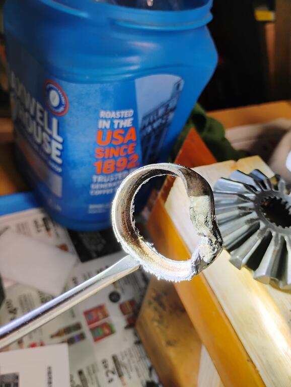

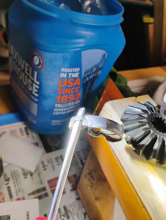

Ron L 1 #8 Posted December 6, 2025 Update here. Transmission is back together. I attached a picture of the seals that I finally pulled out! I was able to punch them in toward the center and pry them out without damaging the housing. They were a mix of a metal ring with the rubber seal that seals around the axle. The "glue" around the metal ring is too uniform to be an aftermarket part so I'm assuming these are from the factory. The new seals fit well...hope they work! 1 Share this post Link to post Share on other sites
