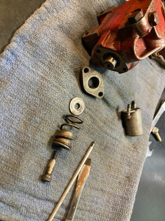

Krice58 165 #6 Posted November 22, 2025 (edited) Came apart easy enough. Just gonna clean it up, replace the o rings and put it back together. Did not see any Mylar shims. The document does say “if used” so maybe some don’t have them? Edited November 22, 2025 by Krice58 1 2 Share this post Link to post Share on other sites

oliver2-44 11,401 #8 Posted November 23, 2025 (edited) Put a little wheel bearing or heavy grease in the groove to help hold the O-rings as you assemble it. Edited November 23, 2025 by oliver2-44 Share this post Link to post Share on other sites

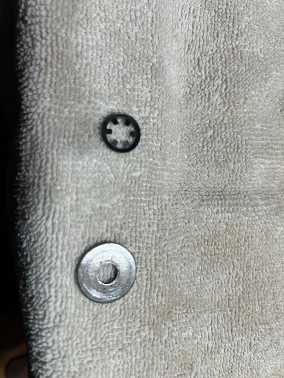

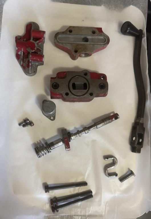

mowboy 12 #12 Posted November 27, 2025 I have a control valve to put back together after the previous owner took apart. The IPL here shows a "special washer" is it one of the two in the pic attached? So shoulder screw goes thru spring retainer cap, thru spring and threads into push rod. Is there tension on the spring when this is all together? Thanks for your help! and Happy Thanksgiving! Share this post Link to post Share on other sites
Krice58 165 #13 Posted November 27, 2025 6 hours ago, mowboy said: I have a control valve to put back together after the previous owner took apart. The IPL here shows a "special washer" is it one of the two in the pic attached? So shoulder screw goes thru spring retainer cap, thru spring and threads into push rod. Is there tension on the spring when this is all together? Thanks for your help! and Happy Thanksgiving! I did not see any “special washer” when I disassembled mine but I did not remove the spring from the piston so I would imagine it sits behind that. The top black washer/clip should be for connecting the handle to the piston which applies pressure to the spring when moved back and forth. Share this post Link to post Share on other sites

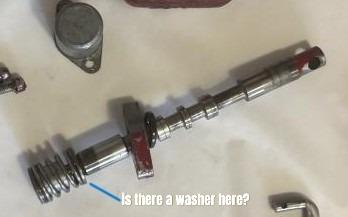

mowboy 12 #14 Posted November 27, 2025 do you remember if there is washer, like the silver on in my first picture, that fits at the end of the spring- see new picture. That would put tension on the spring, I guess. Thanks! Share this post Link to post Share on other sites
ineedanother 2,053 #15 Posted November 30, 2025 On 11/27/2025 at 11:18 AM, mowboy said: do you remember if there is washer, like the silver on in my first picture, that fits at the end of the spring- see new picture. That would put tension on the spring, I guess. Thanks! Yes, there should be. Share this post Link to post Share on other sites
mowboy 12 #16 Posted December 1, 2025 Thank You! (from an hour down the road) 1 Share this post Link to post Share on other sites
